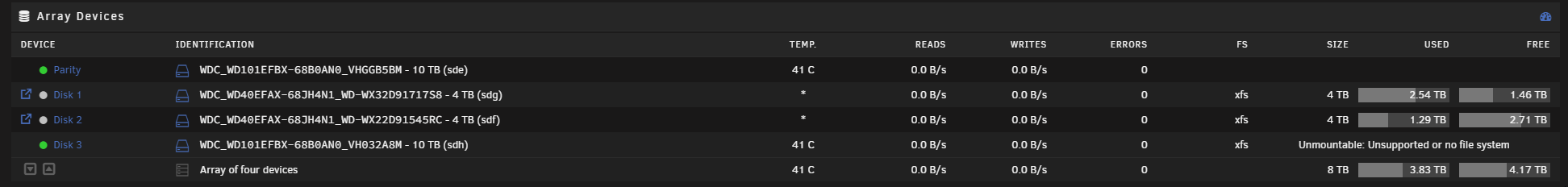

new disk, "Unmountable; Unsupported or no file system" - unable to format.
Bought new drive, WD red plus 10tb.
Added to server, pre-cleared with unassigned devices.
Stop array, (tried to at least)
restart server, new disk added to array. Tick the box to format unmountable disk - click format,, status showing Formating device(s) for a few seconds, and then the Array is back to showing a disk that is not formated :(

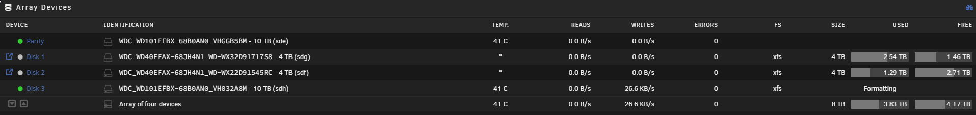

I am able to click format, and the disk shows for a few seconds as "Formating"
then it is back to the status of "unmontable,,,, " after a few seconds,,

just tried once more,, was a bit longer standing with "formating" - but got back to the "unmountable"

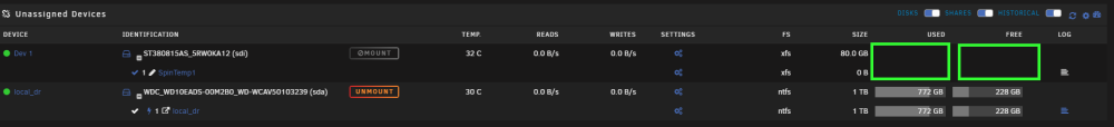

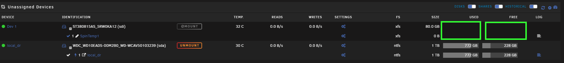

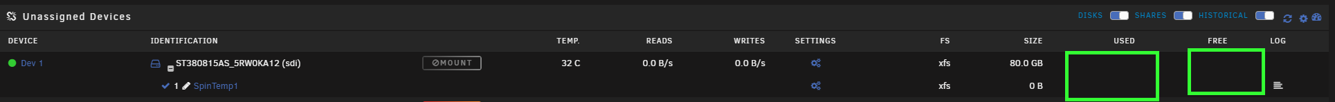

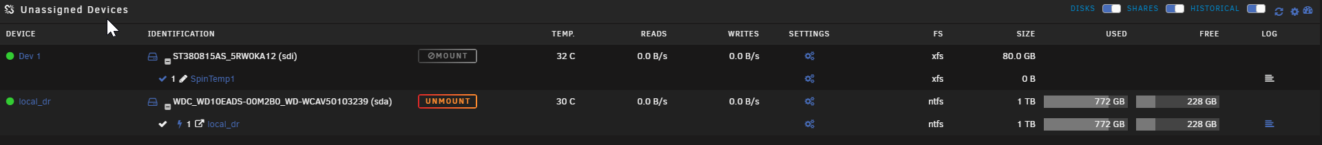

Now I see a second issue,, my old crappy spin-drive for Frigate-recording is having a hickup again.
it seems to be mounted,, but there are no indication of size (last time I checked there was about 12gb of snapshot/video on it)
I've previously seen issues where the dropping of of the usb-attached Local_dr messes with the (sdi)-references,, so I've found them in console using
then I've unmounted and was able to mount again,,,
But now it seems like it is not mounted and just not available to mount?

first issue solved by de-attaching and re-attaching cables,,
Second issue fixed by assigning drive to a dedicated pool for Frigate,,
