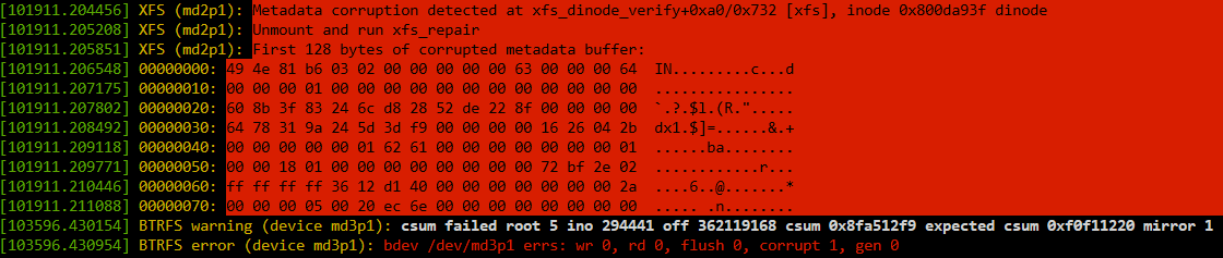

Filesystem Corruption on Multiple Drives (XFS/BTRFS)
I have 6 data drives in my array, and two are spitting out errors in a maintenance mode check.
It started when I noticed the console spitting out messages, so I went and checked the log to be greeted with this.
Also shown in that error, a csum error for disk 3, but the maintenance mode check didn't show anything wrong with that particular drive...
In any case, suggestions on how to proceed would be very much appreciated... I have a backup, but if there's corruption somewhere in the XFS drive, I have no way of knowing which file(s)... at least on a btrfs drive I can scrube to find the inode and then the file(s) associated with that.
I do have enough free space on drives without known corruption that I can scatter the contents of drive 4 to in order to re-format to single drive ZFS... that was the plan all along, but I really didn't want to deal with FS corruption.

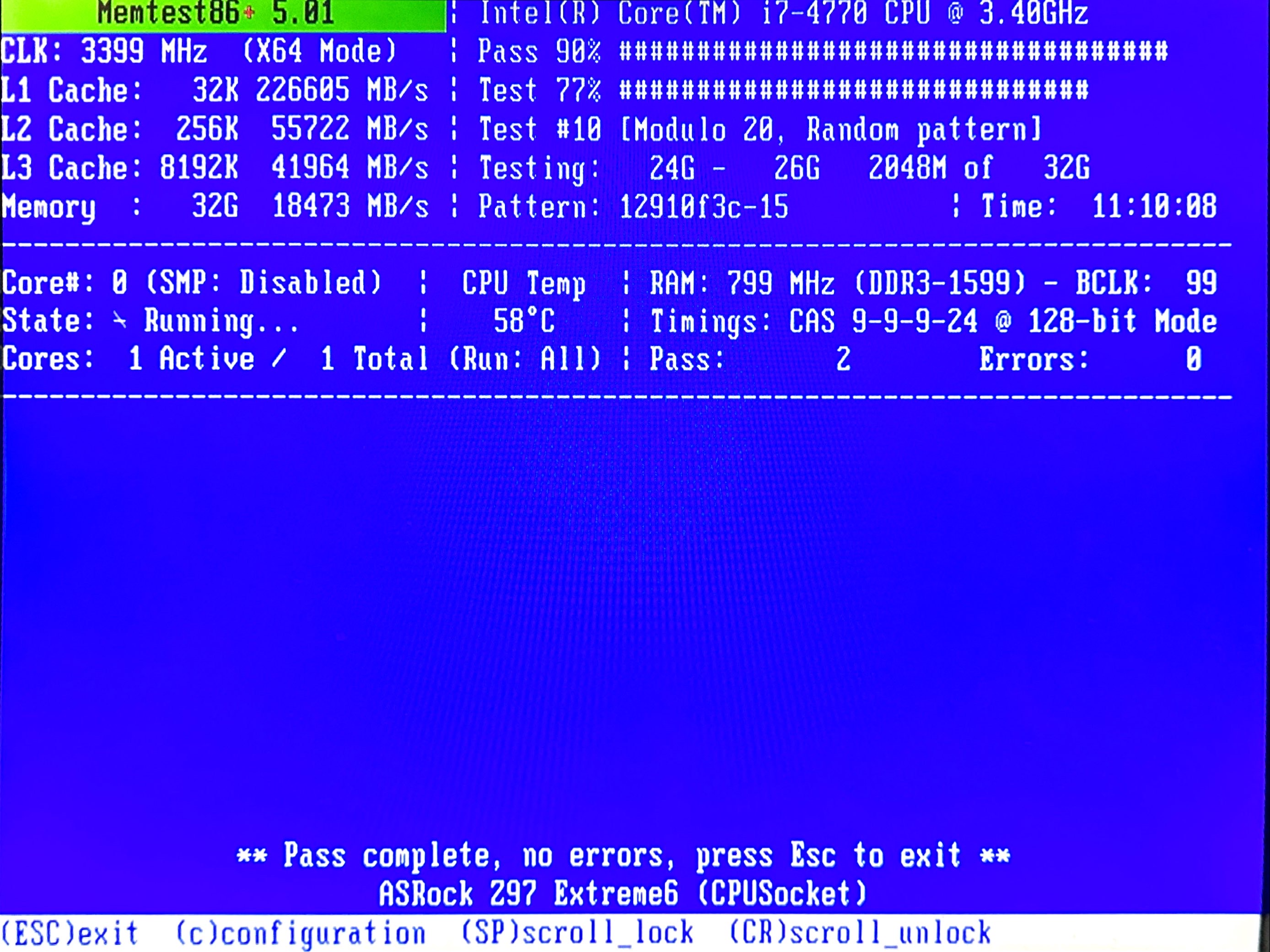

File system corruption occurring with no apparent cause tends to be related to RAM issues.    Have you run a memtest recently?   Is the RAM clocked at a speed that is supported by the motherboard/processor combination you have?
I haven't run one recently, but when I had swapped the motherboard a while back, I had ran one for a few hours without issue...
I've had a couple freezes and less than graceful reboots, so it's possible that the corruption on the xfs/brtfs drives could be in part related to that, but the ZFS corruption... there was a weird thing that happened yesterday... I saw the corruption, so I went to stop the dockers manually as I typically do, but they weren't stopping... even after the 10s timeout, so I clicked reboot in the dashboard, the console eventually gave a force reboot message, but did nothing, even after a few minutes... so I pushed reset.
Unless ZFS has a considerable ram write cache, I have no idea how that would've caused corruption on the data it did though, unless it goes through after the fact...

I was able to get this from dmesg, it definitely seems like something isn't right.

[93094.273503] XFS (md2p1): Metadata corruption detected at xfs_dinode_verify+0xa0/0x732 [xfs], inode 0x800da93f dinode
[93094.274201] XFS (md2p1): Unmount and run xfs_repair
[93094.274820] XFS (md2p1): First 128 bytes of corrupted metadata buffer:
[93094.275480] 00000000: 49 4e 81 b6 03 02 00 00 00 00 00 63 00 00 00 64  IN.........c...d
[93094.276094] 00000010: 00 00 00 01 00 00 00 00 00 00 00 00 00 00 00 00  ................
[93094.276713] 00000020: 60 8b 3f 83 24 6c d8 28 52 de 22 8f 00 00 00 00  `.?.$l.(R.".....
[93094.277356] 00000030: 64 78 31 9a 24 5d 3d f9 00 00 00 00 16 26 04 2b  dx1.$]=......&.+
[93094.277979] 00000040: 00 00 00 00 00 01 62 61 00 00 00 00 00 00 00 01  ......ba........
[93094.278624] 00000050: 00 00 18 01 00 00 00 00 00 00 00 00 72 bf 2e 02  ............r...
[93094.279254] 00000060: ff ff ff ff 36 12 d1 40 00 00 00 00 00 00 00 2a  ....6..@.......*
[93094.279888] 00000070: 00 00 00 05 00 20 ec 6e 00 00 00 00 00 00 00 00  ..... .n........
[93094.493924] XFS (md2p1): Metadata corruption detected at xfs_dinode_verify+0xa0/0x732 [xfs], inode 0x800da93f dinode
[93094.494672] XFS (md2p1): Unmount and run xfs_repair
[93094.495318] XFS (md2p1): First 128 bytes of corrupted metadata buffer:
[93094.496005] 00000000: 49 4e 81 b6 03 02 00 00 00 00 00 63 00 00 00 64  IN.........c...d
[93094.496741] 00000010: 00 00 00 01 00 00 00 00 00 00 00 00 00 00 00 00  ................
[93094.497398] 00000020: 60 8b 3f 83 24 6c d8 28 52 de 22 8f 00 00 00 00  `.?.$l.(R.".....
[93094.498092] 00000030: 64 78 31 9a 24 5d 3d f9 00 00 00 00 16 26 04 2b  dx1.$]=......&.+
[93094.498830] 00000040: 00 00 00 00 00 01 62 61 00 00 00 00 00 00 00 01  ......ba........
[93094.499589] 00000050: 00 00 18 01 00 00 00 00 00 00 00 00 72 bf 2e 02  ............r...
[93094.501933] 00000060: ff ff ff ff 36 12 d1 40 00 00 00 00 00 00 00 2a  ....6..@.......*
[93094.503754] 00000070: 00 00 00 05 00 20 ec 6e 00 00 00 00 00 00 00 00  ..... .n........
[101078.953627] XFS (md2p1): Metadata corruption detected at xfs_dinode_verify+0xa0/0x732 [xfs], inode 0x800da93f dinode
[101078.954459] XFS (md2p1): Unmount and run xfs_repair
[101078.955157] XFS (md2p1): First 128 bytes of corrupted metadata buffer:
[101078.955867] 00000000: 49 4e 81 b6 03 02 00 00 00 00 00 63 00 00 00 64  IN.........c...d
[101078.956601] 00000010: 00 00 00 01 00 00 00 00 00 00 00 00 00 00 00 00  ................
[101078.957318] 00000020: 60 8b 3f 83 24 6c d8 28 52 de 22 8f 00 00 00 00  `.?.$l.(R.".....
[101078.958062] 00000030: 64 78 31 9a 24 5d 3d f9 00 00 00 00 16 26 04 2b  dx1.$]=......&.+
[101078.958836] 00000040: 00 00 00 00 00 01 62 61 00 00 00 00 00 00 00 01  ......ba........
[101078.959586] 00000050: 00 00 18 01 00 00 00 00 00 00 00 00 72 bf 2e 02  ............r...
[101078.960488] 00000060: ff ff ff ff 36 12 d1 40 00 00 00 00 00 00 00 2a  ....6..@.......*
[101078.961285] 00000070: 00 00 00 05 00 20 ec 6e 00 00 00 00 00 00 00 00  ..... .n........

I’m starting to think it’s more so bad cables than RAM, but I’ll leave it run over the weekend and see what that says.
