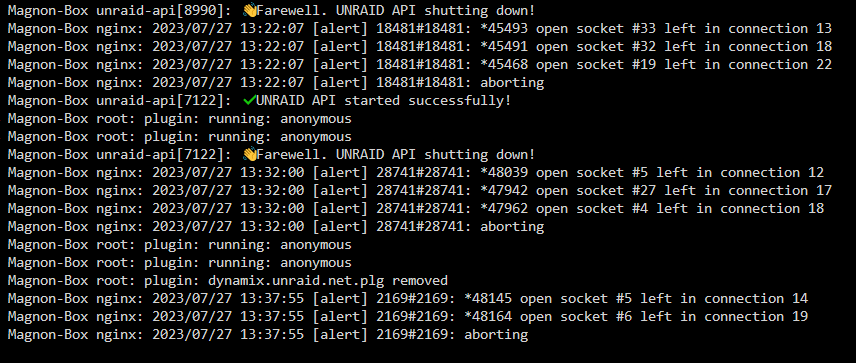

July 27, 20233 yr Ive noticed that in 6.12.X the dashboard stopped updating itself every 4-5 minutes, ive poked a bit around and by chance i uninstalled the Connect Plugin and the issue has gone away. After the plugin removal, it did just stop for a second but caught up after throwing a bit of a fuss in the log (It does seem that there is another underlying issue but removing the connect plugin did extent the times between those "freezes" quite significantly) Edit: I did forget to mention, prior to messing with the unraid-api and subsequently removing the plugin, the "freezes" or what you want to call the dashboard stop refreshing itself, had absolutely 0 entries in the log. It just stopped updating. Im currently looking to find the culprit of the underlying situation. Ill update accordingly, was able to recreate the behavior on a different machine. It seems to be one (or all) of the unassigned devices plugins. after removing it, plus and the preclear, the nginx logs have vanished. Another one appeared but this time it took a really really long time until that one happend. Still peculiar why connect plugin hid the nginx logs. The dashboard still does seem to freeze on the "test machine" im down to a handfull of plugins. In the meantime the dashboard has been running just fine on the main machine with all plugins active(minus connect plugin cause that one is like a clock) so far. theres something fishy going on with 6.12.X^^ Im did remove dynamix filemanager on the test machine and it didnt stop updating yet. The main machine still has been updating the dashboard, it did auto refresh itself a couple of times alongside the aformentioned nginx logs. But now am at a point where troubleshooting it takes way too long of a time to check for it. Edited July 27, 20233 yr by Mainfrezzer Added a bit of info
