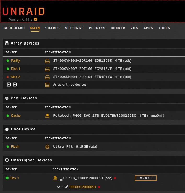

     However, on a certain day, Disk 2 started to exhibit problems. It first disappeared from the RAID array and ended up in the Unassigned Devices section with a "Mount" button to perform the mounting. I found this behavior strange, but I attempted to remount the HDD.
     Unfortunately, the remounting process failed, and even after restarting the Unraid server, my disk was still not recognized.

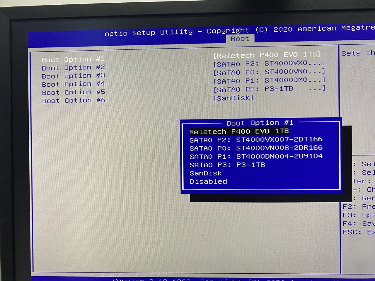

     The puzzling part is that when I access the BIOS, I can see the HDD properly plugged into the corresponding SATA port for Disk 2, and it is recognized there without any issues.

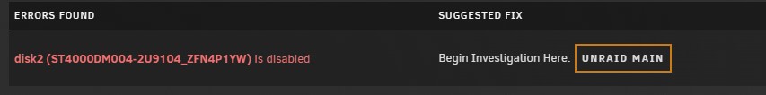

Just to clarify, I think you mean the disk is shown as disabled (has a red ‘x’ against it) rather than it is not seen by Unraid?    This distinction is important as a disk is disabled if a write to it fails for any reason as it is no longer in step with parity.    It does NOT mean that the drive had failed, as the commonest reason for a write failing is when the cabling to the drive (either power or SATA) is not perfect.    The SMART report for the drive shows there have been quite a few CRC errors which are ones where a problem was detected when transferring the data to the drive so it is quite likely this is the cause.   If you want to do a test of the drive you can try running an Extended SMART test on the drive.
To clear the disabled state one needs to rebuild the drive contents.  Rebuilding of drives is covered here in the online documentation accessible via the ‘Manual’ link at the bottom of the GUI or the DOCS link at the top of each forum page.   At the moment Unraid is ‘emulating’ disk2 using the combination of the other data drive(s) plus parity so you can see what would be rebuilt (although it looks as if the emulated drive is basically empty).   If you think the drive is OK then you can try rebuilding to itself as described in the link.
