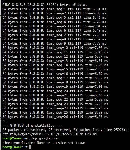

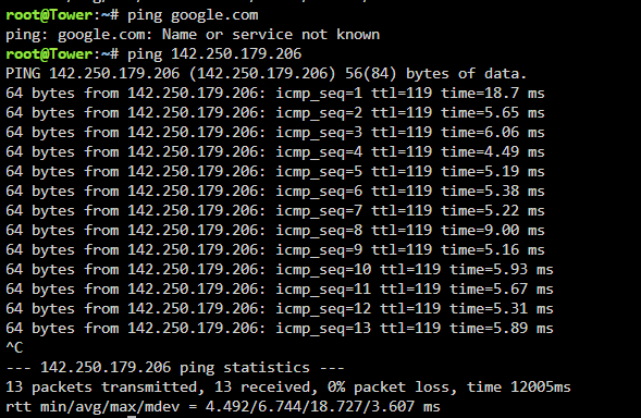

For some reason i cannot ping google .com but i can ping 142.250.179.206 which is google their ip
Edited by Deagarys

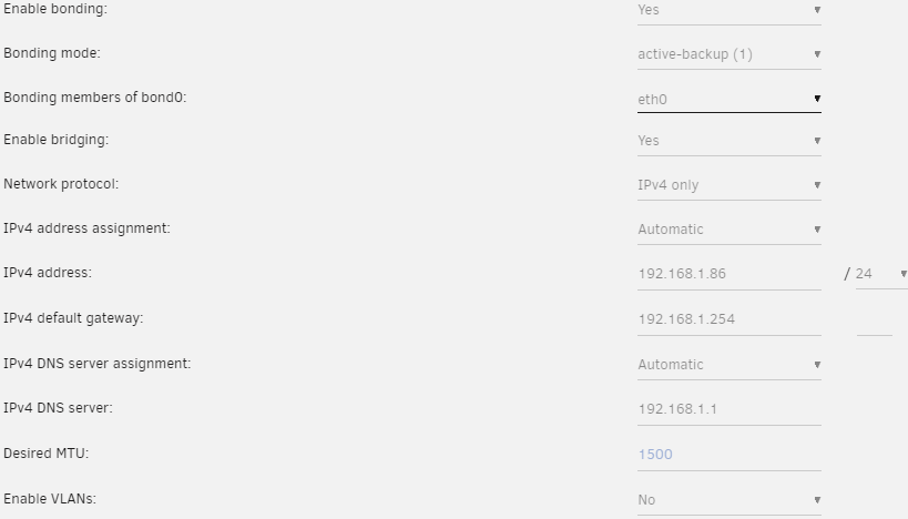

Where? I am completely new to this. This is my second day of having the tower
This is what i can find:
Edited by Deagarys
In network page. I haven't check the diagnostics due to browsing with mobile.
You setting in auto IP ( dhcp ) or manual IP ( static )?

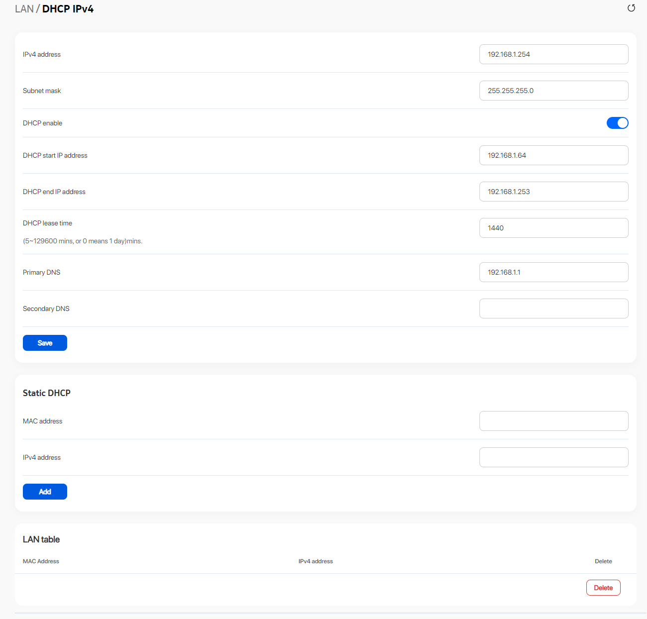

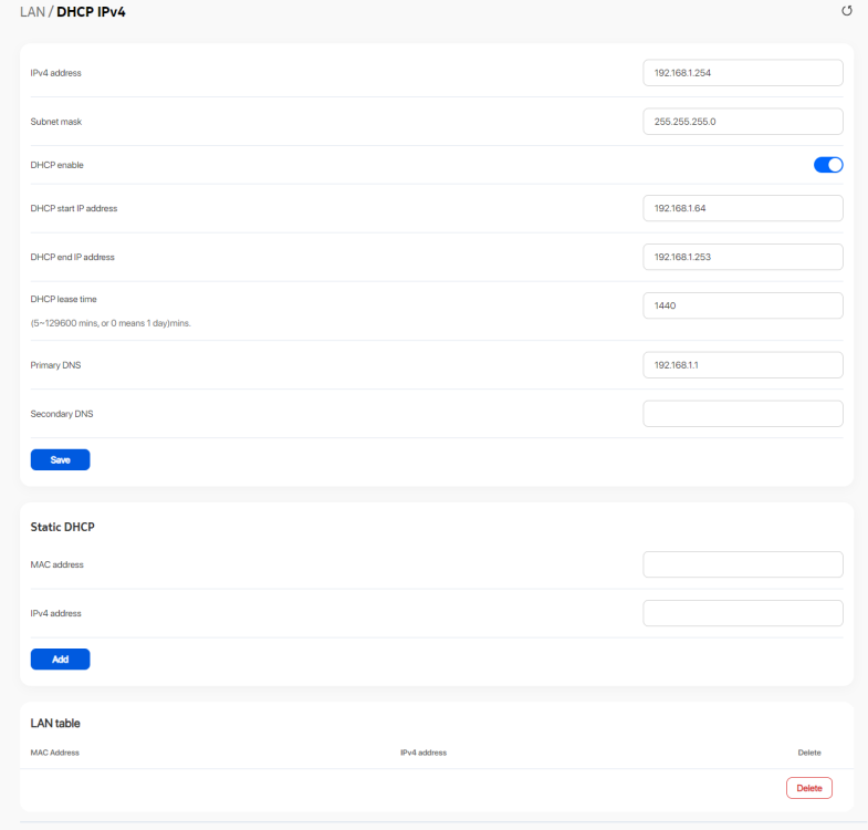

I just edited my previous reply with a screenshot of my network settings.
You sure you have local dns on 192.168.1.1 ?
Usually the dns are same as gateway,  so check your router DHCP dns setting.
Edited by Vr2Io
192.168.1.1 is my pi hole which is the dns of my router. This has been working for 12hrs now or something like that and suddenly just stopped working. only on my server everything else has internet.
Edited by Deagarys
Then check at pihole FTL log and check does receive and reply Unraid's request.
Or simple try use router for dns resolve, if problem solve, it is pihole issue.
I changed my routers DNS back to it's own. Restarted it all the internet came back, but not on my server yet. Issue is not with pi hole i suppose.

SOLUTION:
The issue was that the DNS on my Tower was pointed towards my Pi-Hole. I turned automatic DNS off and back on. This seemed the fix the issue. I now took the automatic DNS and made that ip my static DNS so it will not target Pi-Hole automatically again.
