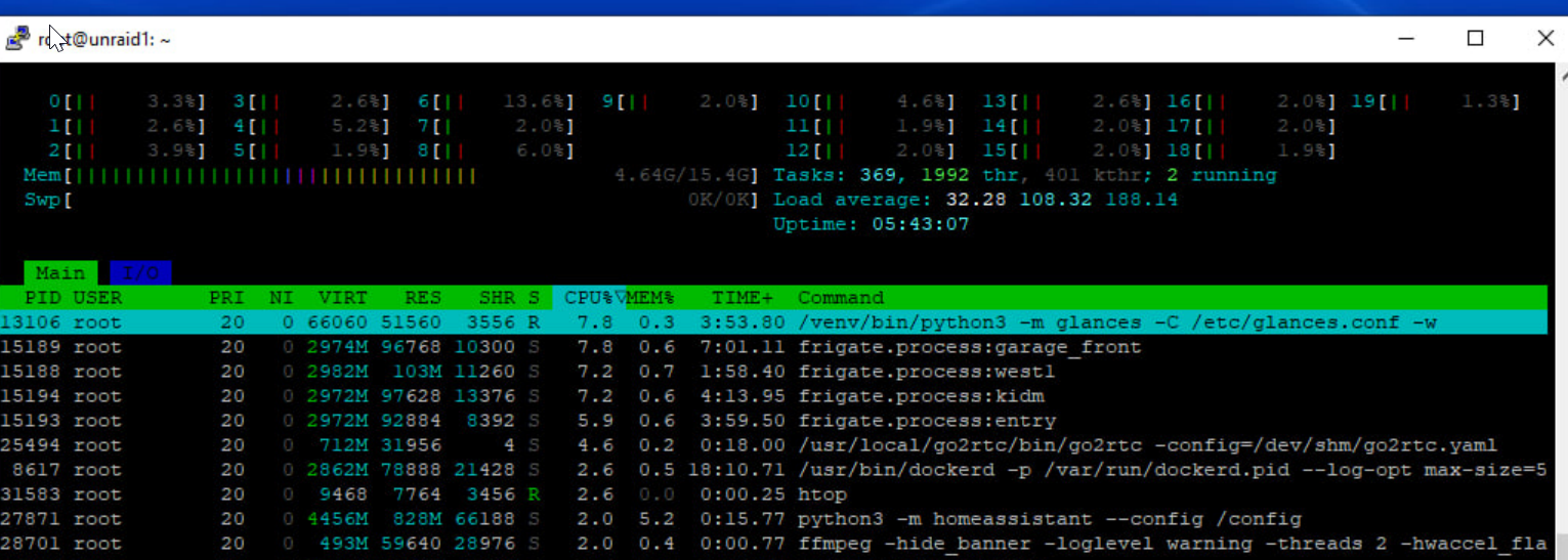

July 28, 20233 yr Author got the GUI back to beeing responsive a bit,, and got to download diagnostics: unraid1-diagnostics-20230728-1830.zip also got an advice (and guidance) to log on to terminal via PuTTY and got this view from htop he indicated that the load was high,, but not what could have caused it,, After a while the server was again responsive,, so what could it have been ? (diagnostics attached)

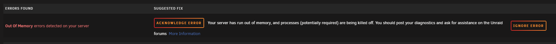

July 28, 20233 yr Author So updated the Fix-common-problems-plugin to latest and did a scan, and it came up with this jem so I guess that running a handfull of dockers creates extreme peaks in addition to the normal <40% ram utilization? I was planning on looking for some good black-friday-offers on additional RAM,, but I guess I have a mis-configuration somewhere that is causing theese crashes - and I'd like to know what I've done wrong and not just put on bandaids with MORE POWER adding a fresh diagnostics in case it shows more valuable info for you experts unraid1-diagnostics-20230728-2015.zip
