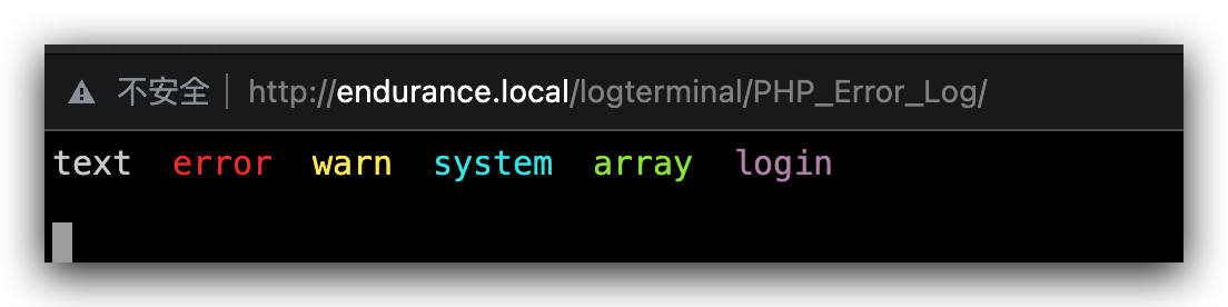

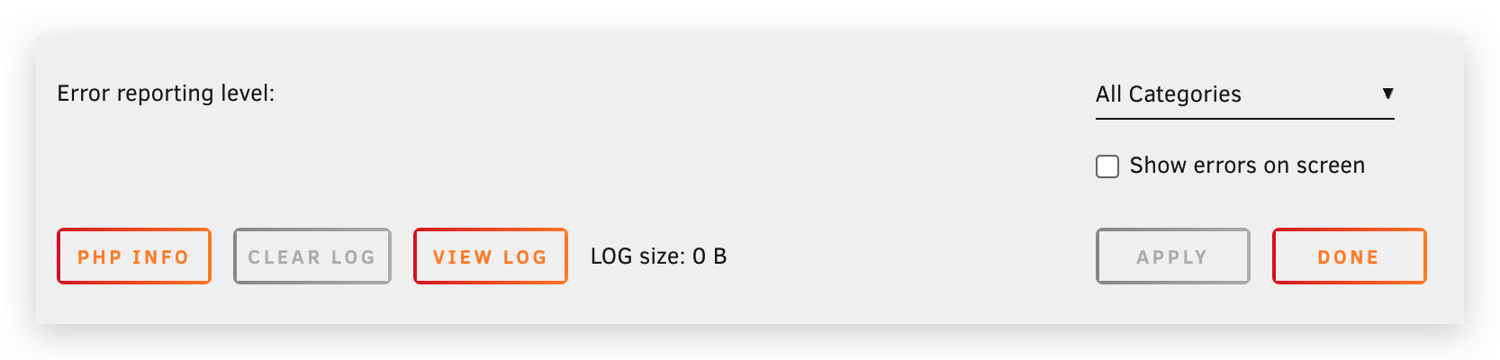

What I can see is that the "[IP] is being replaced with an empty string, this should not be possible, the only way for it to be possible is because the server don't see a driver for that docker network, I'm not sure but maybe in the PHP logs you can find an error (Tools > PHP Settings), either way I need the debug file (first port for instruction).
I set Error reporting level to All Categories,refreshed docker page couple times(cache disabled with DevTools),but nothing shows on log view window.
I tried stop,restart and completely remove and recreate the container,still no log and log file size is 0B
image.thumb.png.ee52007b20277dfedb37afa8ddafc2ea.pngimage.thumb.png.855e2faf405de8c59a22d44125774d54.png
This is just a minor issue,I can still use http://192.168.1.10:25500 instead:P

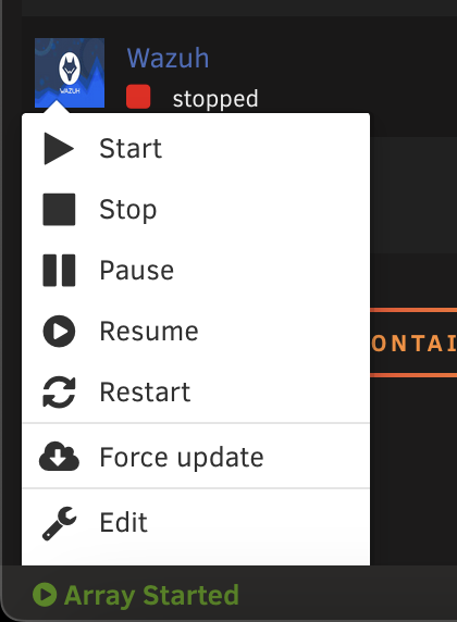

So I have the latest release of FolderView (2023.11.04) installed on UR 6.12.4. I have a couple of empty folders that I would like to delete, but when I click on them, I do not see a "remove" option. I have also gone into "edit", but I don't see an option to delete it there either. How do you delete folders in this version?
The remove button should be in the menu of the folder.
If you don't see it, check the browser console for errors.

So I figured out the issue... if the folder is empty, the you don't get the "Remove" option:
Thus, how do I delete an empty folder?
I think this is a problem with CSS, the remove should be under the edit button, and from what it looks like it is there, you can expand the browser window and you should be able to see the button or you can run this in the browser console in the tab where is your folder, NOT the dashboard.
rmFolder('yourfolderid');
Replace yourfolderid with the id of your folder, you can find that in Setting > FolderView.
Edited by scolcipitato
So, if I unlock the Docker screen, drag the empty folders to the top, then click on them, "Remove" is now an option. Thanks for pointing that out!

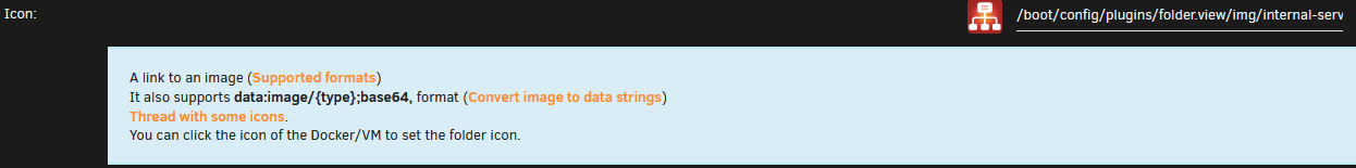

Good day,
Am I missing something?  I am unable to change the icon of the folder for the life of me.  I just want to upload a PNG file I used with the old version.
Any help would be great.
In this case, the image is on my server.
As you can see, you can input links to external sites (ex. GitHub). But remember, everything is requested client side, so if you have any ad blocker or, maybe there are problems with CORS, the request may be blocked, and you end up not seeing the icon. If this doesn't work, send a screenshot of the browser console (if there is anything).
This is the answer...  Unlike the previous version that automatically stored an icon you browsed for, this version requires you to make a location on your server for the files, and type in the path...
I was hoping this wasn't the only way, but I ended up making a folder on my flash drive for the icons.
Hello,
I've got 2 questions. Where on the flash drive and how did you link to them afterward?
Thank you
I created a folder in the plugin data at /boot/config/plugins/folder.view/icons.  Icons in there...
Then I pointed the folder icon variable to that path and icon name...
