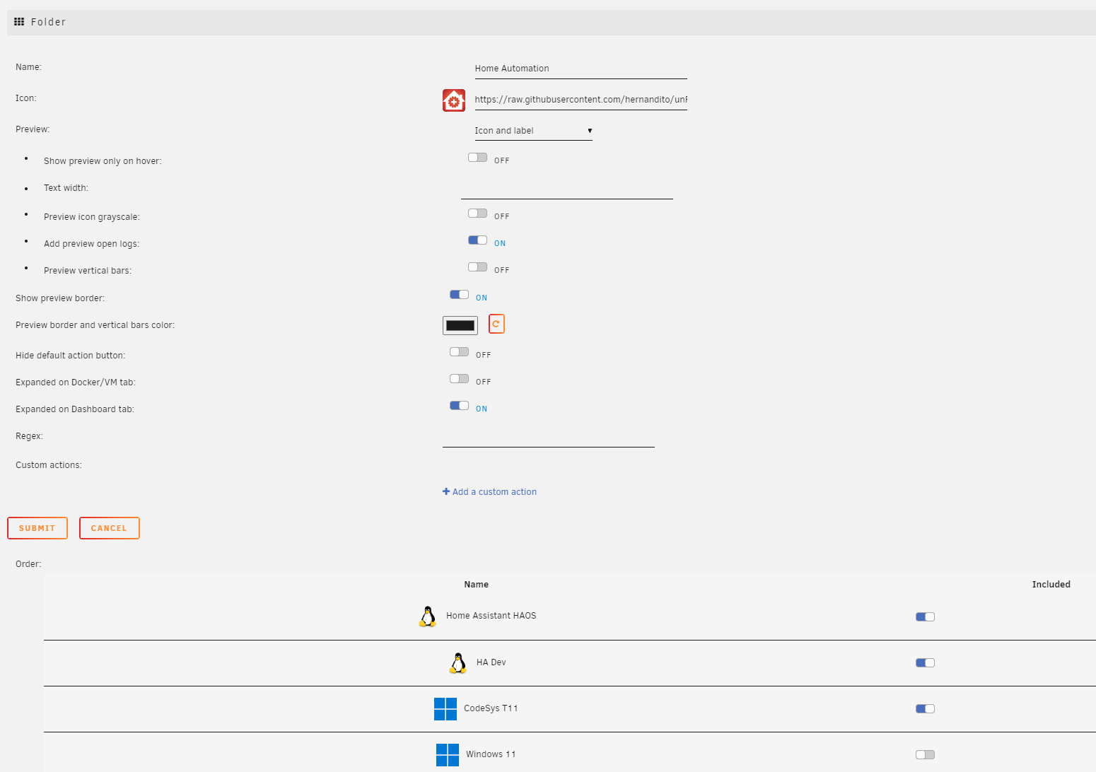

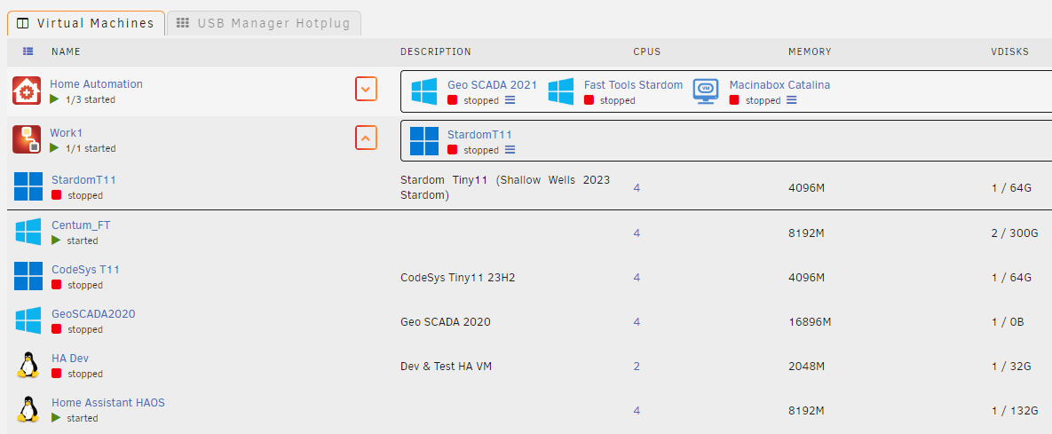

In my VMs tab - the wrong VMs show in the configured folder. Docker folders work fine.
Screenshots show config and Folder View Display - as you can see different VMs from those selected appear in the "Home Automation" folder.
Any idea how to fix this? I have tried both Firefox and Edge - same problem.

I need the debug file (first post for instructions)

12 hours ago, brentk said:
I run a couple of tests with the debug file you gave me, I didn't find any problem, I see that you have other plugins that change the webui of the vm folder, maybe is that. What I can say with what I have is that the plugin expect to find your VMs in this order.:
  1. Windows 11
  2. Fast Tools Stardom
  3. HA Dev
  4. SimaticTIA17Pro
  5. Home Assistant HAOS
  6. GeoSCADA2020
  7. Macinabox Catalina
  8. CodeSys T11
  9. SimaticTIA17Unified
  10. Geo SCADA 2021
  11. Centum_FT
  12. StardomT11
  13. Windows 10 Gaming
  14. Tiny11_2311
Potentially the other plugins you have changed this order and if they do so it can lead to issues, I can advise making a backup of the config, uninstall folder view and see if the order match.

I don't really know what is going on, I tried to replicate your setup and for me, it seems to work, I saw a single difference in your debug file, so I tried to fix it. You can try to reinstall the plugin and see if it works.
