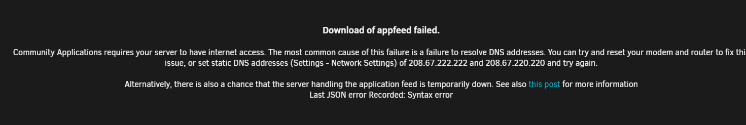

I wanted to add another vlan so I could route certain dockers through a VPN'd network. After doing so I could no longer get CA to load and after undoing all my changes I am still unable to load the apps tab. I added various DNS servers with no change. Nothing else in my network is having issues resolving DNS. The screenshot is what I get when I go to the apps tab. Attached are my Diagnostics. Please help I am still very new to troubleshooting unraid.

Solved by Squid
Delete /config/network.cfg on the flash drive, reboot and reset things back up (this will revert you back to DHCP if you were using a static IP)
Thank you, sir. That did the trick. I appreciate your help.

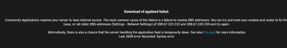

Did you try what Squid suggested? Worked for me.
No, for some reason a firewall rule got created that blocked all access to my server IP. Not sure why because I didn't make it...
