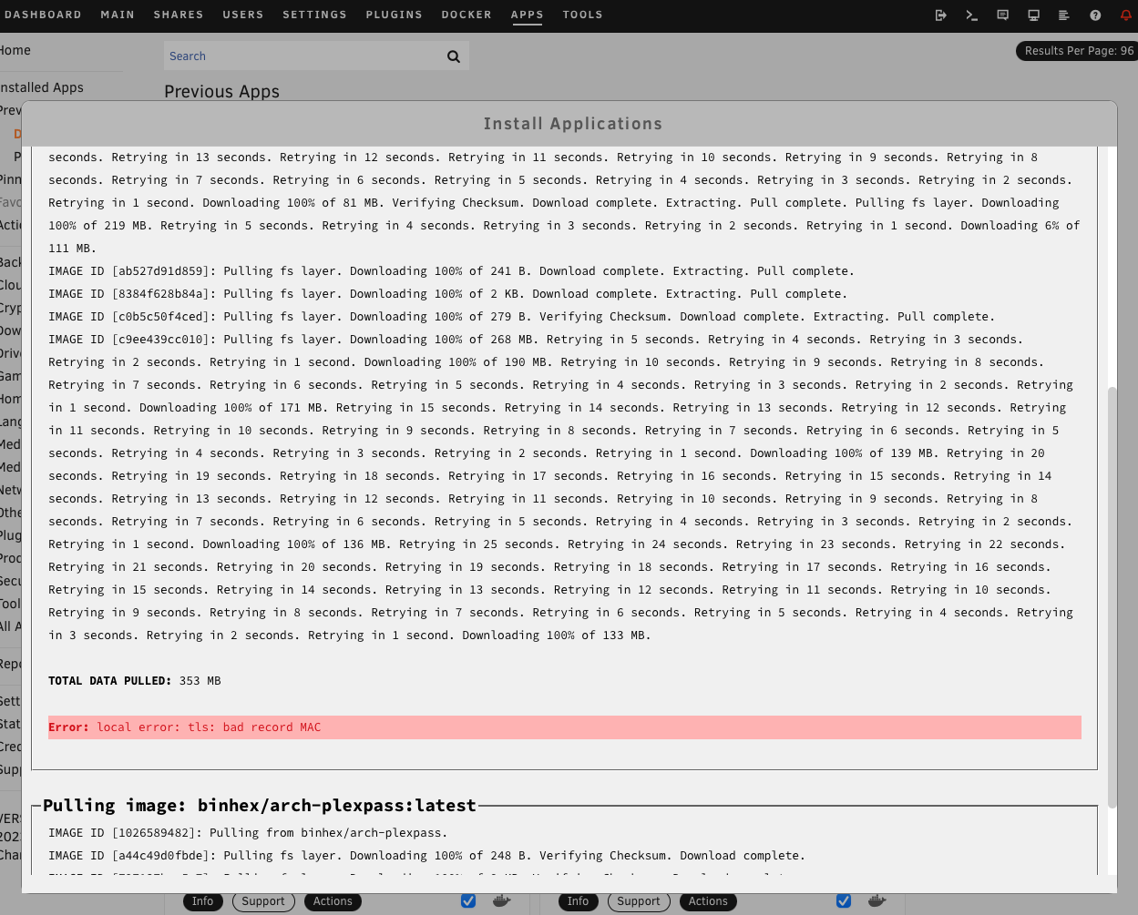

2. Reinstall docker apps via CA. During the installs, many of the dockers have to repeatedly retry downloading the files. Two dockers fail with "Error: local error: tls: bad record MAC". These two dockers are continuing to fail to install. I will retry again later in the week (see screenshot).

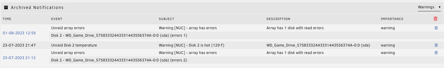

3. The system log is being spammed "kernel: tpm tpm0: A TPM error (257) occurred attempting get random".
4. In the archived notifications I have two disk warnings: "Array has 1 disk with read errors warning Disk 2 - WD_Game_Drive_57583332443331443556374A-0:0 (sda) (errors 1)". However, the disk log and attributes do not reflect this.
nuc-diagnostics-20230806-2203.zip
Edited by wlsn0chrs
Diags don't show any read errors, did you reboot?
Yes, unfortunately the machine was inadvertently unplugged last week around the 8/1. I've enabled the local syslog server to avoid losing the logs going forward.
Does the disk read error count get reset on a system reboot? I've gone through my dump of old log files and unfortunately don't have any covering the periods of the listed disk read errors. Screenshot of the archived disk error notifications below.
239768250_Screenshot2023-08-07at9_07_35AM.thumb.png.61c8bddaa9267048c7cad7acf0f7803d.png
Yes, if it happens again post new diags.
