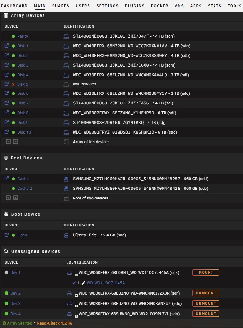

I logged into unraid (6.12.3)  last night to find disk 5 with a red x and disabled with the message that it is being emulated. Using Unbalance i have copied the data from disk 5 (I assume through emulation) to a spare disk that was in the server (for this precise scenario). The data is intact and sitting on the spare disk with no issues. I then stopped the array, unassigned disk 5 so that it now shows 'Not Installed', restarted the array and have started a parity check.
I assume that once the parity check (although instead of start parity, it now shows read-check one the main page, I guess this is the same thing?) then I should be back up and running?
Disk 5 is now shown under Unassigned Devices where I will leave it until I get the chance to remove the drive. Im not fussed about reusing it or its data, as I have copied the data to disk 4

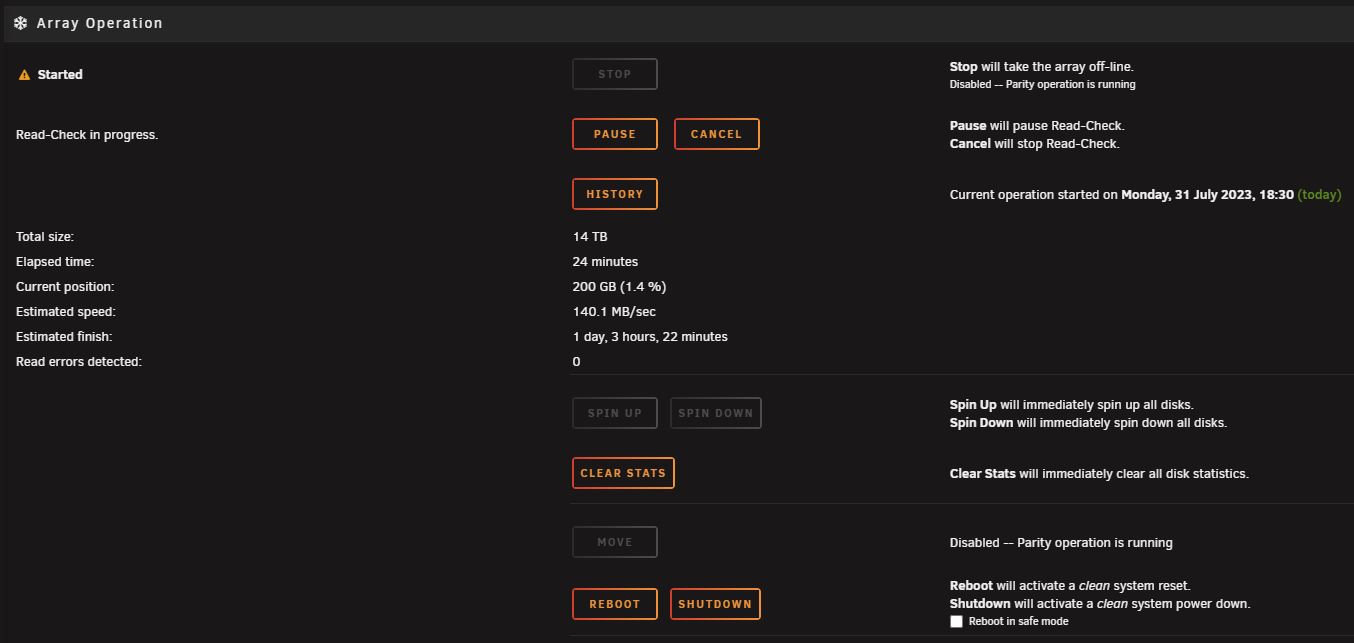

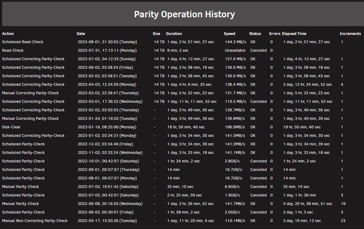

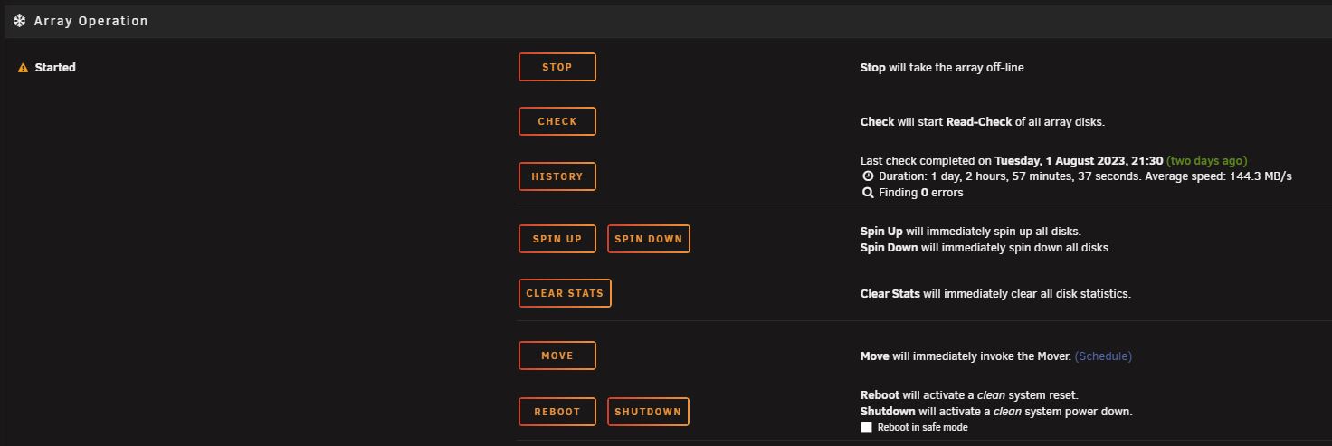

Why, if I have a parity drive installed (as per picture above) am I now only seeing Read-Check instead of Parity Check and am unable to run a parity check either manually or through the scheduler.
On the Main Page, the check button starts a Read-Check, and if I set it under schedule, as you quite rightly pointed out, it also only does a Read-Check even though I have a parity drive?
As can be seen, parity checks were working perfectly until this drive was disabled? Am I missing something?
Edited by apefray
You get a read check if your data is not protected because you have as many drives disabled as you have parity drives (as seems to be the case here).    You are not currently protected against another drive failing until you clear the disabled state on disk5.    The system will currently be emulating the contents of disk5 using the combination of parity plus the other data drives.

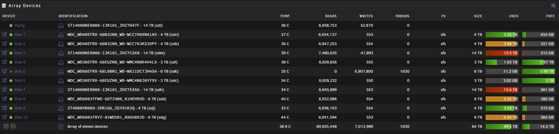

So, I've moved the drive that has been disabled from bay 5 (thinking it maybe an issue with a cable) to bay 14 of the server. Unraid, again, has restarted a re-build after assigning the drive back to Disk 5, but yet again, it stopped rebuilding after 26 minutes and has disabled the drive. Remember, this drive is now in another bay in the server so isn't on the same cable as previously.
So, what next..... As @JorgeB says, it appears the disk looks healthy so not sure why Unraid keeps disabling it. I have attached another diagnostics, so someone might be able to tell what is going on.
Remember also, I do have 2 empty drives (disk's 4 & 6, although one of them is holding the data that I copied using unbalance from the emulated drive) that I could utilise, however both are 3TB drives, whereas the drive that is giving me issues is a 6TB drive, but it only contains 1.03TB of data.
The disk causing the issue is currently empty, as Unraid thinks the data now resides on Disk 4, but its the parity I'm trying to sort out to protect the data.
