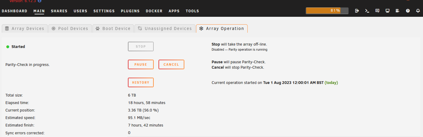

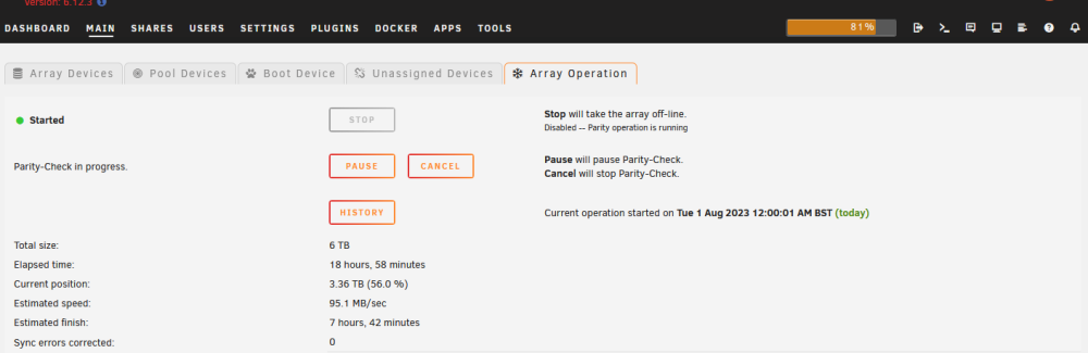

August 1, 20233 yr I am running 6.12.3 and a parity check was run today. It appears that this has been completed as there are no disk activity or disk reads going on However the array reports that the parity check is still in progress, but these figures have been frozen for hours and do not update if you refresh the page? Please find attached diagnostics - I know that Disk 12 has failed tower-diagnostics-20230801-1759.zip
August 2, 20233 yr Community Expert According to the syslog it's done: Aug 1 18:16:02 Tower kernel: md: sync done. time=65761sec Aug 1 18:16:02 Tower kernel: md: recovery thread: exit status: 0 But diags have conflicting info, try rebooting and running it again.
