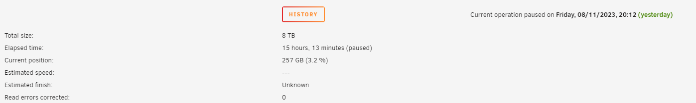

August 12, 20233 yr Author So i that was a dumb idea to format and i shouldnt have but i did start the rebuild and it ran for a couple hours and started showing the same error on the disk. So i replaced the disk with a new larger disk last night. it started the rebuild. Today when i woke up i received notice that the disk failed and was disabled. i now have the same Disk 2ST8000VN004-3CP101_WWZ2NL03 - 8 TB (sde) Unmountable: Wrong or no file system I don't know what to do. I'm thinking I might change the drive port on the motherboard maybe the port has gone bad. I feel I'm grasping at straws at this point. Edited August 12, 20233 yr by Drezzden865
August 13, 20233 yr Author Solution This is RESOLVED im pretty sure. I finally found this article and was able to get the the sever in maintenance Mode run. the script xfs_repair -v /dev/md2 it ran supper fast a completed on the new disk. I wish i had been calmer and found this the day it happened.
