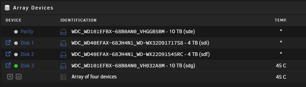

I've got an array of three disks with a parity
Disk 3 was last added, 10tb same as parity.
it is still not used (was something spilled over, but I corrected in share-settings and cleaned with unBalance)
and it is refusing to spin down and stay down :(
Settings / disk settings / Default spin down delay: 15 min
Disk3 / settings / Spin down delay: 15 min   (was set to default but have now tested with 15min)

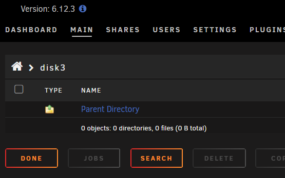

Drive seems empty,,
even trying to press "spin down" in main-tab is effective for a little while,, the drive keeps spinning up a minute or so later,,,

If possible try connecting that disk to the onboard SATA controller instead and re-test.

unfortunately not able to do that at the moment,, all 3,5'' slots are hot-swap bays in my chassis,,   will have to make some kind of adjustment to get fixtures for other spin-drives below the hot-swap bays,,,
By the way,, the parity 10tb red and the two data-drives in the array are also on the same drive-bay-row (same "bay-controller" and cable to HBA) - so it is rather strange behaviour for one drive compared to others ?

I missed that, in that case using SATA should not make any difference, sometimes I see issues with spin down with newer drives and older SAS2 LSI HBAs, but since parity is the same model it's likely not that.
