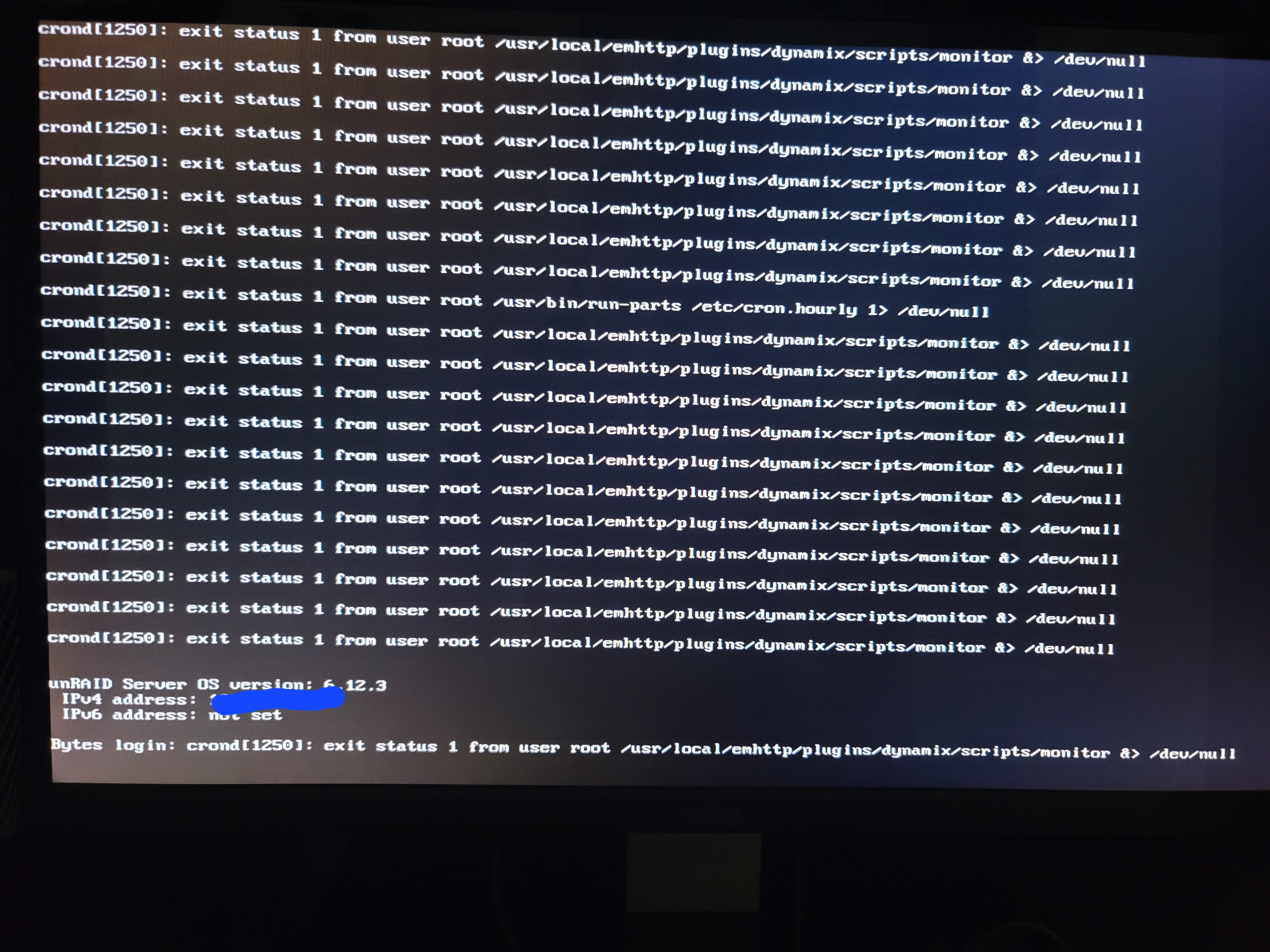

Yesterday when I yet again lost access, I tried to access the terminal directly from the tower and I saw this line repeating itself:
crond[1250] : exit status 1 from user root /usr/local/emhttp/plugins/dynamix/scripts/monitor &> /dev/null
I tried to power down the server with the command but nothing happened. It showed me my server address and prompted me for logging in but when I tried, it didn’t work (see picture below).
Since I needed to access the server, I eventually just did another hard reset and now everything is working again, but I suspect that the problem is going to be back.

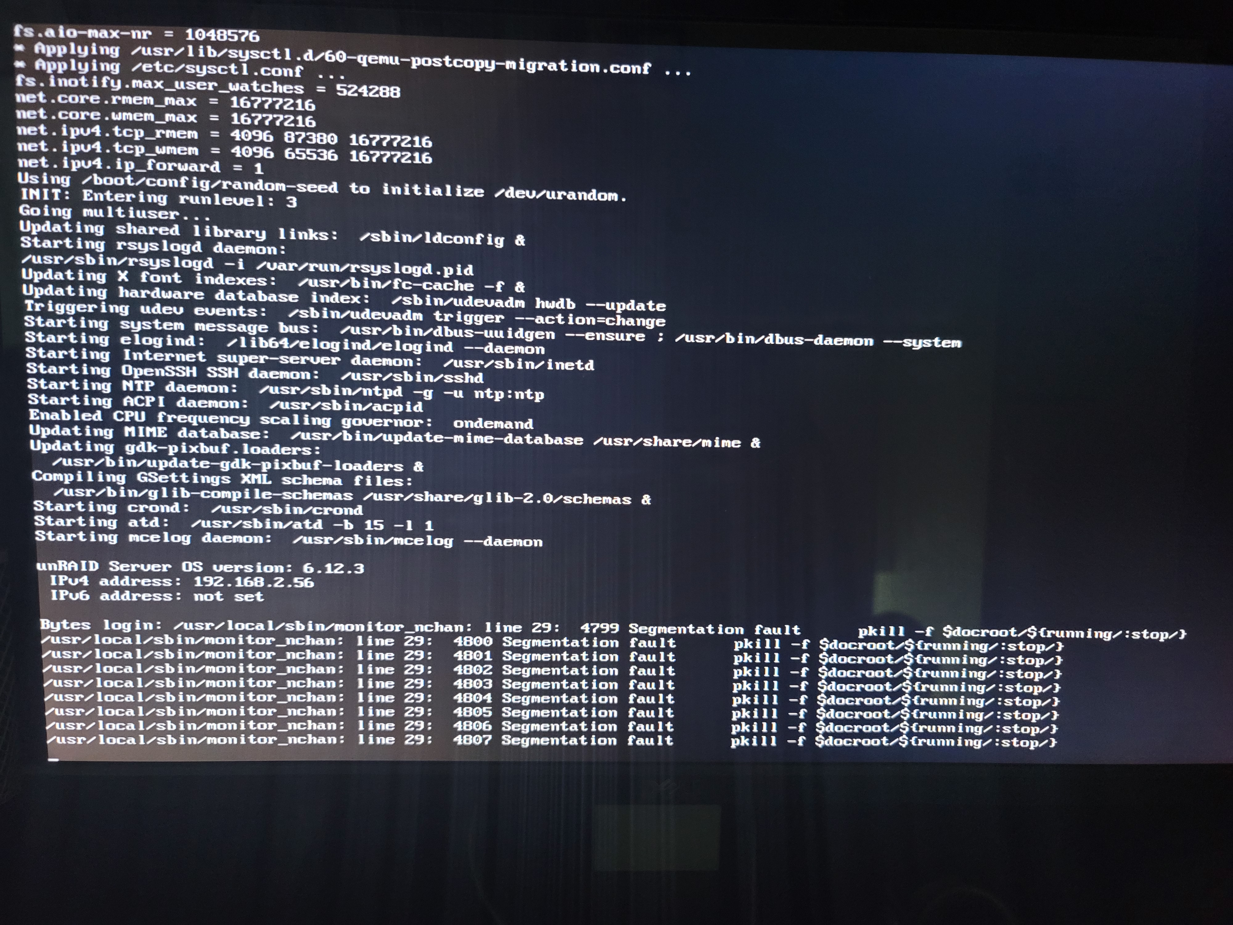

Also, just before enabling safemode, I've noticed this lines on my server : usr/local/sbin/monitor_nchan: line 29: 4799 Segmentation fault pkill -f $docroot/${runnning/:stop/}
(see attached). Maybe this can help?
Thanks!
Unfortunately not really.

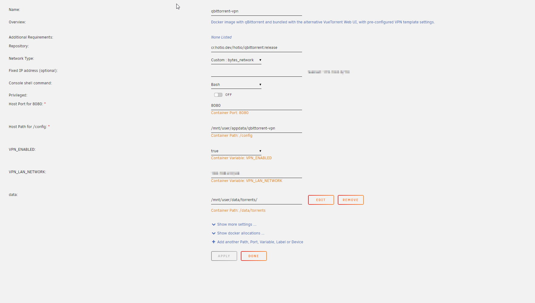

Ok so I think I've found the culprit : the qbtorrentvpn container.
I restarted all my other dockers and it's the only one that caused a crash soon after I enabled it. Right now my server is stable with everything enabled except this one.
I use it with the arrs suite. Is it because I have too many torrent seeding (right now I have about a 100)? Should I put limit on actives torrents?

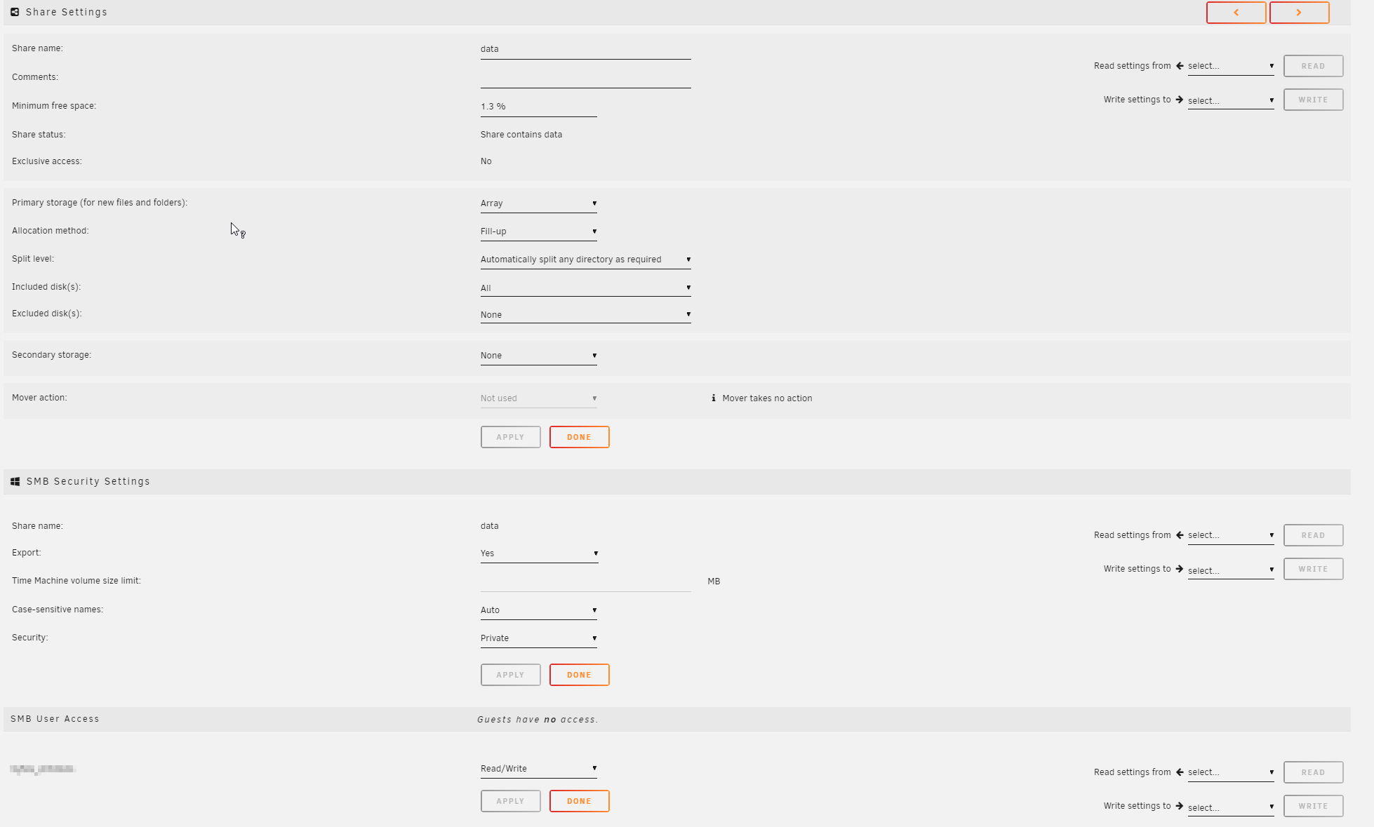

If it helps, here's attached a screenshot of the container settings and the share as well.
Thanks again!
