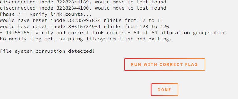

The partition is back, but there's fs corruption:
Aug  7 14:04:46 HSUnraid kernel: XFS (md2p1): Metadata CRC error detected at xfs_agi_read_verify+0x85/0xfa [xfs], xfs_agi block 0x2
Aug  7 14:04:46 HSUnraid kernel: XFS (md2p1): Unmount and run xfs_repair
To play it safer unassign disk2 and see if UD plugin can repair the filesystem, that way you still have the rebuild option to try if it can't.

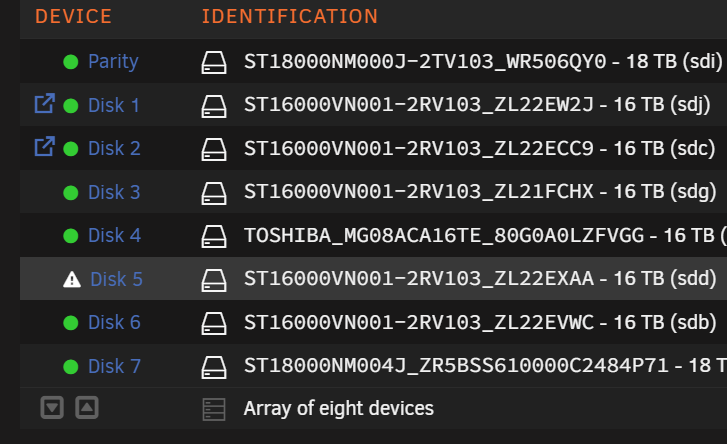

is there a manual regarding UD Plugin and repairing FS ?
Just click the bolt check mark type icon after unassigning the device form the array.
I did unassign it but there is no bolt-type Icon - neither near Disk2 or UD section ?
I have a mount Button at the UD section - do you mean the gears ?
Edited by Schulmeister
