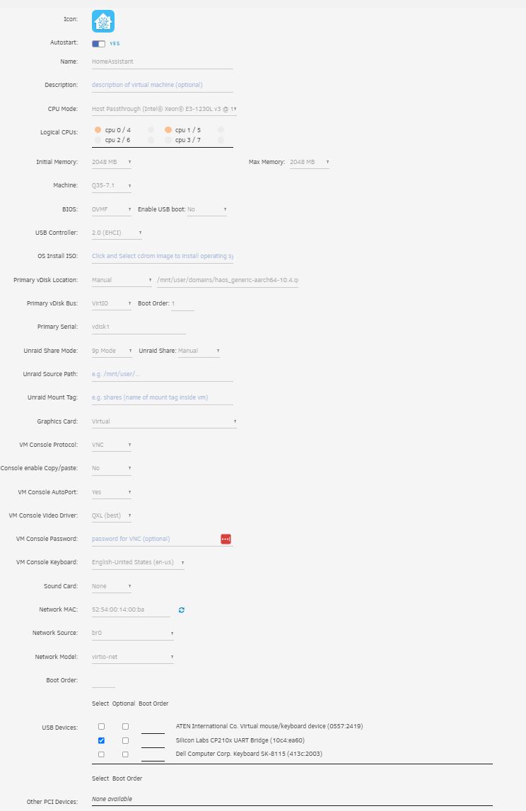

Installed Home Assistant following the guides found online. VM shows as started but nothing happening in the console. Parity sync is still ongoing. Am I missing anything?
I am not able to check my vm, but maybe try sata for vdisk bus.

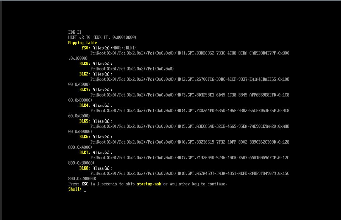

Tried setting to sata. Still same. Is my vm not loading at all looking at console? Is there anything out of order in logs?

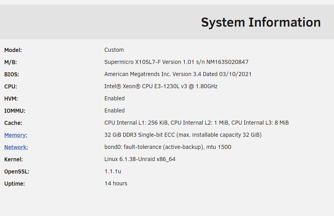

You need to download the right qcow2 file, you are using aarch64 qcow2, which is for arm, but you are using x64 qemu.
