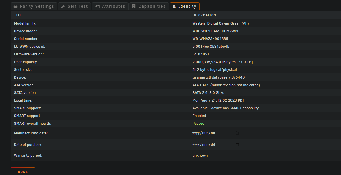

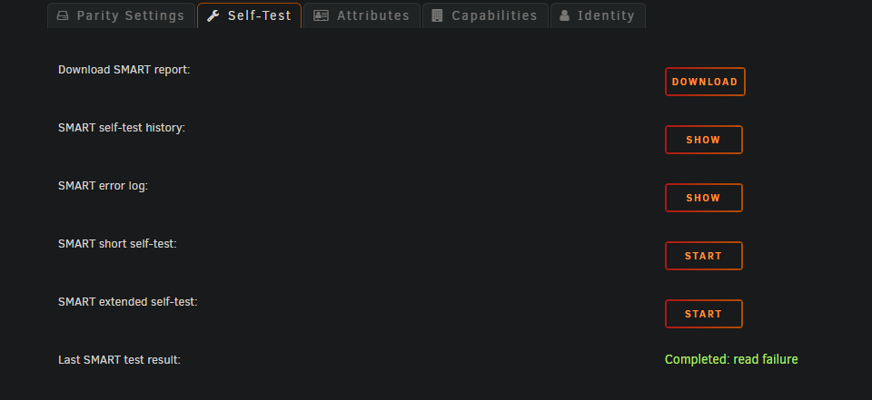

August 8, 20233 yr HDD SMART overall health: passed But failed SMART test This is an old HDD im using temporarily as a parity (just for testing puposes, no important data) but curious to know if its usable in the future Test results attached alien-smart-20230807-2052.zip
August 8, 20233 yr I would not want that drive anywhere near one of my systems. The read failure is a no-go by it self. But there is also tons of critical SMART errors. (Attributes #1, 198, 200 are way too high) Vendor Specific SMART Attributes with Thresholds: ID# ATTRIBUTE_NAME FLAGS VALUE WORST THRESH FAIL RAW_VALUE 1 Raw_Read_Error_Rate POSR-K 130 001 051 Past 40182 3 Spin_Up_Time POS--K 207 169 021 - 4625 4 Start_Stop_Count -O--CK 093 093 000 - 7549 5 Reallocated_Sector_Ct PO--CK 200 200 140 - 0 7 Seek_Error_Rate -OSR-K 200 200 000 - 0 9 Power_On_Hours -O--CK 062 062 000 - 27935 10 Spin_Retry_Count -O--CK 100 100 000 - 0 11 Calibration_Retry_Count -O--CK 100 100 000 - 0 12 Power_Cycle_Count -O--CK 096 096 000 - 4858 192 Power-Off_Retract_Count -O--CK 200 200 000 - 625 193 Load_Cycle_Count -O--CK 168 168 000 - 96078 194 Temperature_Celsius -O---K 120 100 000 - 30 196 Reallocated_Event_Count -O--CK 200 200 000 - 0 197 Current_Pending_Sector -O--CK 200 200 000 - 0 198 Offline_Uncorrectable ----CK 200 200 000 - 47 199 UDMA_CRC_Error_Count -O--CK 200 200 000 - 21 200 Multi_Zone_Error_Rate ---R-- 199 199 000 - 316 I don't know what drives you plan on using on the server, but if they are used, I would suggest to run an extended SMART test on each of them. If you are not sure how to read that, you can share your diagnostics once every test is completed.
