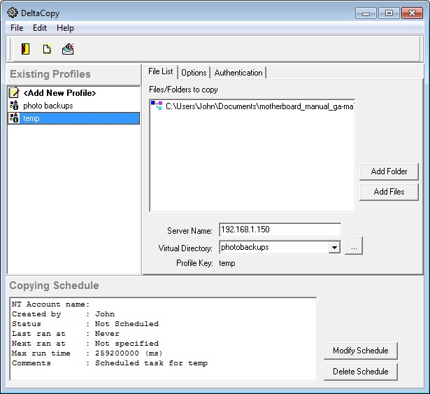

I setup a new profile named temp to test out the system and here is the response I get
Executing: rsync.exe  -v -rlt -z --chmod=a=rw,Da+x --delete "/cygdrive/C/Users/John/Documents/motherboard_manual_ga-ma790gp-ud4h_e.pdf" "192.168.1.150::photobackups/Documents/motherboard_manual_ga-ma790gp-ud4h_e.pdf"
Profile 'temp' executed in 2 milliseconds. It ran successfully.
The only problem is that there are no files in my photobackups share. I'm guessing that I don't have the path to my share setup correctly but it looks right to me.
I've also attached a screenshot of the deltacopy profile I created.
Any ideas? Thanks in advance.
