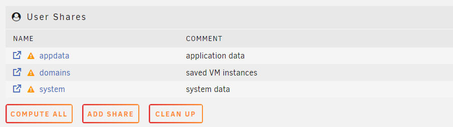

August 10, 20233 yr Hi, i run my Unraid OS on my proxmox server, and because of a failed attempt to do a GPU passthrough, i had to make an unclean shutdown of Unraid. When i rebooted, all my shares disappeared and the GUI doesn't show the utilization of the disk and parity, even though it says that they're healthy. In the logs, i have this error: ''Unraid emhttpd: /mnt/disk1 mount error: Unsupported or no file system'' and ''Unraid emhttpd: disk1: import error''. I am not sure of what to do. unraid-diagnostics-20230810-1136.zip

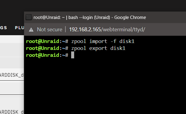

August 10, 20233 yr Community Expert Type: zpool import -f disk1 then zpool export disk1 now re-start array and the disk should mount P.S. It would be better to passthrough entire disks (or controllers) instead of using virtual disks.

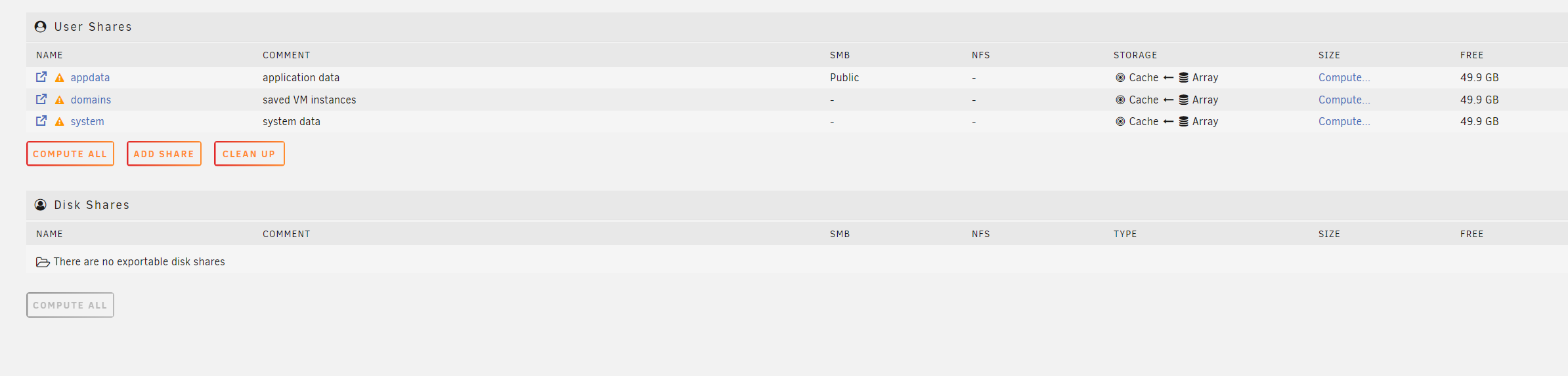

August 10, 20233 yr Author I did the commands in the console like you just said but it didn't change anything. I know my files are still there, it would take more than 6 hours to actually delete it. The only thing i can see in my shares are the files from my cache. P.S. I made an HDD passthrough for Unraid, is it not enough? unraid-diagnostics-20230810-1225.zip Edited August 10, 20233 yr by XEVIOUS_GOD

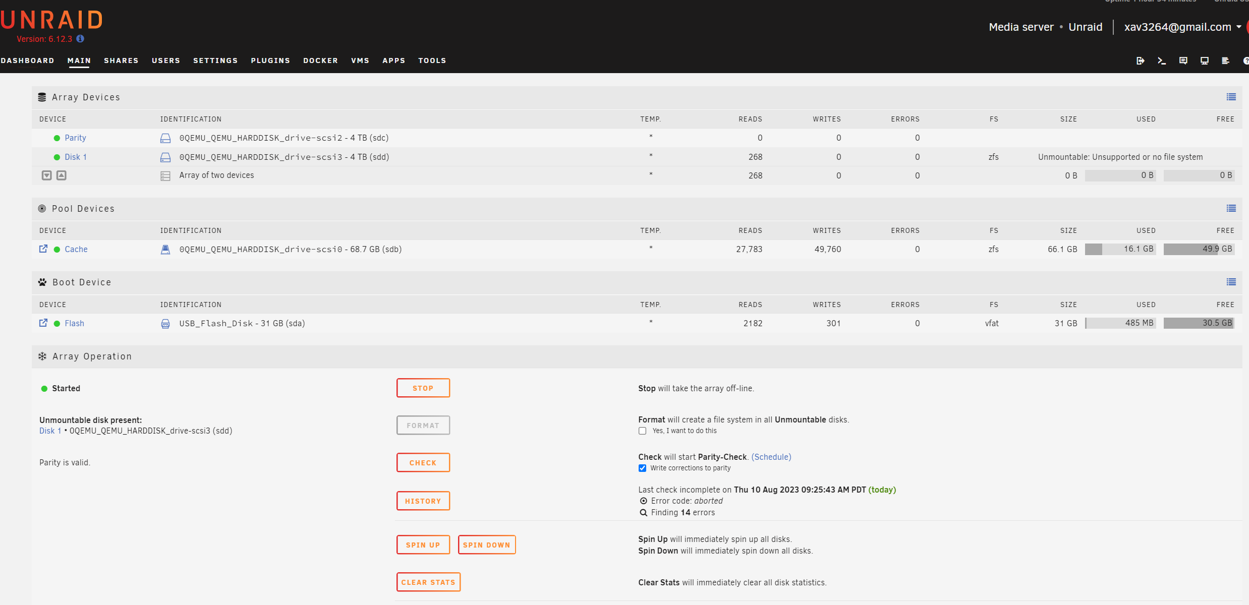

August 10, 20233 yr Author Oh i've sent you the wrong logs, let me do it again. Still, it doesn't appear to work sadly. unraid-diagnostics-20230810-1259.zip Edited August 10, 20233 yr by XEVIOUS_GOD
August 10, 20233 yr Community Expert Still no array re-start on those. Type the commands, stop array, start array, post new diags.

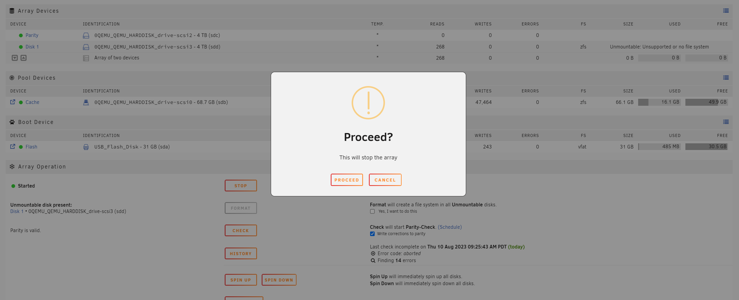

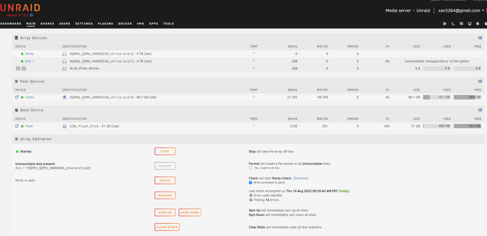

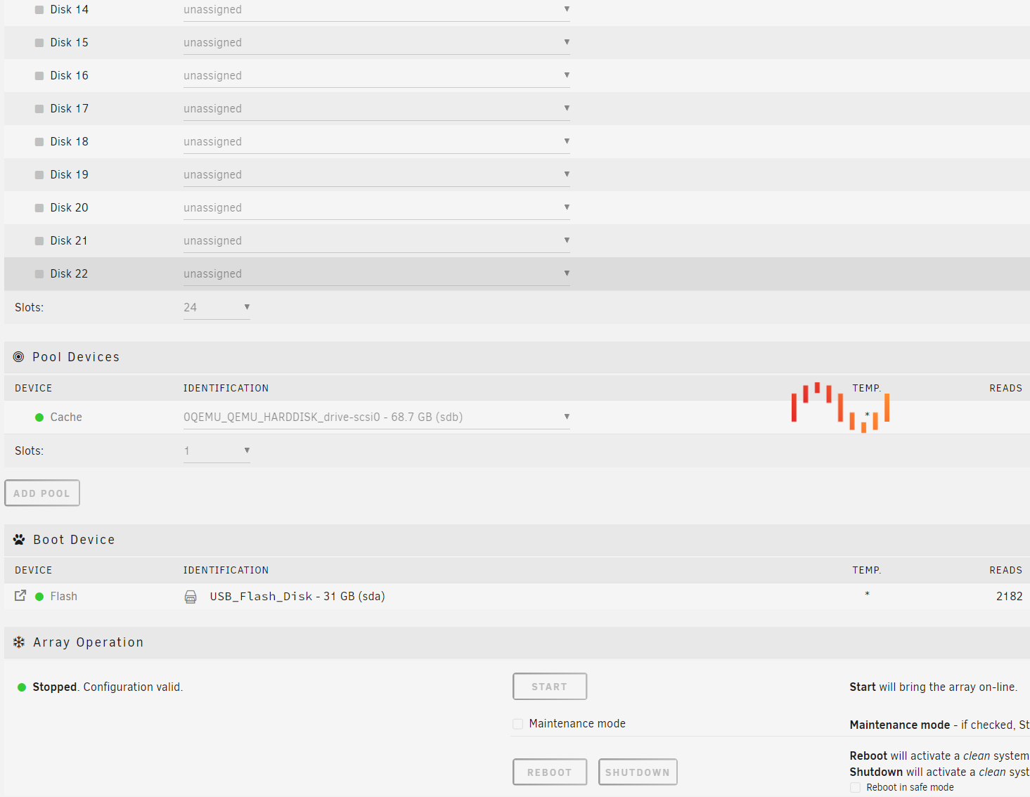

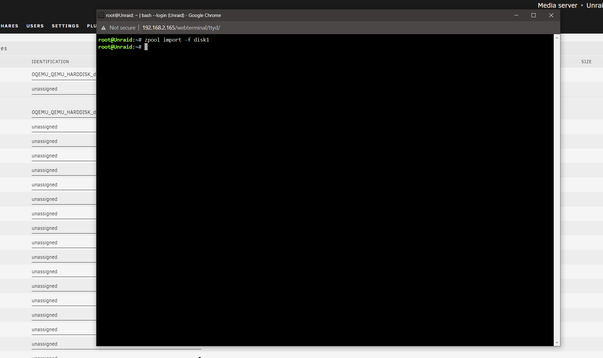

August 10, 20233 yr Author Strange, i'm pretty sure i did. First i stop the array: I open the console and type the first command: I type the second command: I reoppen the array: Same result, nothing changed: Am i giving you the wrong logs? unraid-diagnostics-20230810-1357.zip Edited August 10, 20233 yr by XEVIOUS_GOD

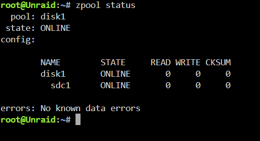

August 10, 20233 yr Community Expert Looks like you were posting the wrong diags, now I see the re-starts, not sure why the command is not working, never happened before with this error, which by the way is caused by virtualizing Unraid, and it's not supported, it thinks it's a new server: Aug 10 10:56:47 Unraid root: cannot import 'disk1': pool was previously in use from another system. Aug 10 10:56:47 Unraid root: Last accessed by proxmox (hostid=21e480ba) at Wed Aug 9 13:49:15 2023 Aug 10 10:56:47 Unraid root: The pool can be imported, use 'zpool import -f' to import the pool. Type once more: zpool import -f disk1 and then post he output of zpool status
