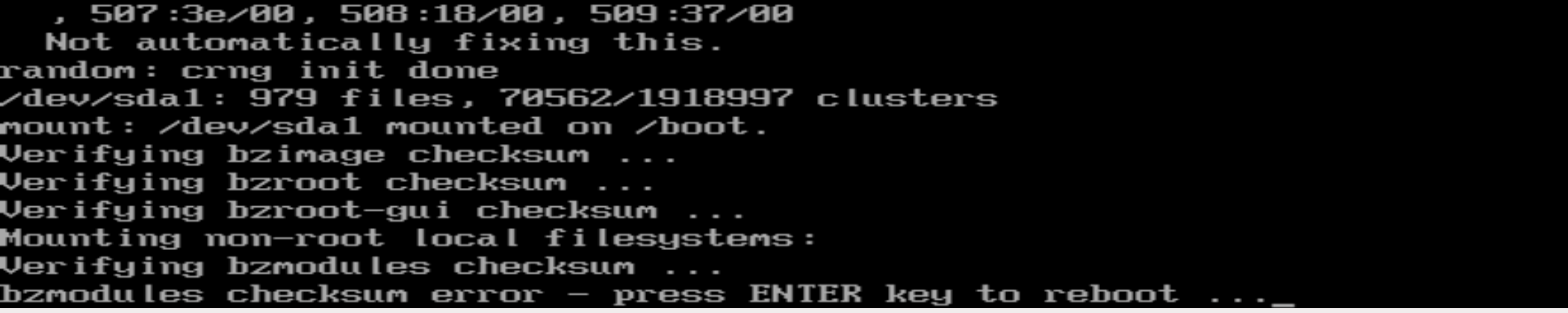

August 11, 20233 yr howdy y'all. this is the second time i've seen this error when configuring and messing with my server. I really think its due to the NVIDIA driver update i tried to do as the last time the server was running I had reboot for NVIDIA driver to take affect. I really don't want to lose any information on this and so im really asking for any help or suggestions as my UNRAID connect backup is from all the way back to 7/12.. i don't think i've changed a whole lot since then config wise but my array has added more files.. does that matter? i've read to just reload the USB drive.. (last time this happened that fixed it) but im weary of losing any data so im reaching out for more detailed suggestions or instructions so my clumbsy ass doesn't mess this up. attached photo is CLI where i am stuck and even when i run UNRAID safe mood with GUI Edited August 11, 20233 yr by krzykrl attached photo
August 11, 20233 yr Community Expert Solution Replace only the bz* files in the flash drive from the download zip.
August 14, 20233 yr Author Thank you, seems so silly but im very paranoid since im novice to this and decommisioned my NAS last week after a month of running both setups. Thanks again!
