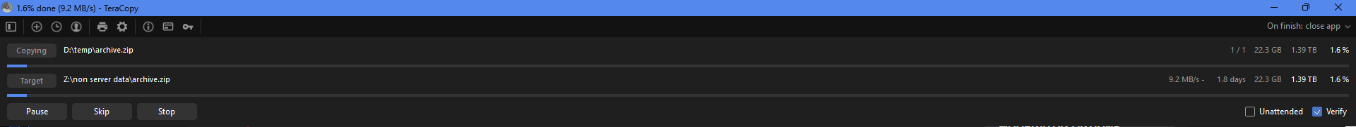

i came from truenas wanting the ability to run more docker containers and apps easier and it has been so far, but the only issue is running zfs on here i get horrible speeds im transfering a zip file rn at 10mb/s the same set of drives in the same raidz1 config on truenas would hit 100 to 140mb/s idk if this is just an issue with my setup or not but its not clear whats the issue because when i first made the array i tested it with some movies and stuff with my plex media server and it did the 100-200mb/s which id like but for some reason i cant seem to hit it with most file types, im really hoping someone can help because i love the look and feel of unraid but would like not to switch back to truenas just because the storage performance is sooo slow

i realize transfering the zip with windows is a bit faster than teracopy but still waaay slower than it should be, granted they are hardrives but they are decent segate irowolf pros image.png.7d88b39007fdbf21d0d8d7af58a023f9.png
i forgot to say i also have 2.5gbe to my server
so turns out steam was doing something i exited it and got better speeds on it but still kinda not the speeds i was expectingimage.png.198465bc9c9e5d78c8bc50576116def7.png

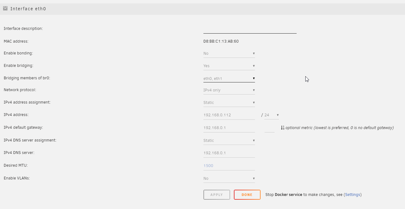

Try disabling the network bond, it can limit the speed to the slower NIC, and set eth1 and eth0, bottom of network settings, reboot required.
oh i didnt know i had a bond let me try that

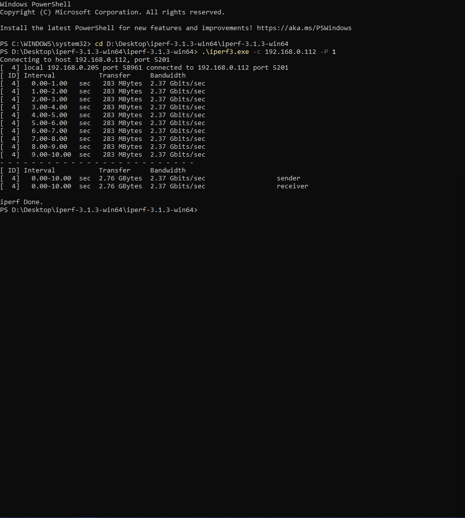

That could be a different issue, but start by running a single stream iperf test in both directions to confirm network bandwidth
Also disable bridging to test
whats the command for that?
i disabled bridging now i cant get into my gui
i disabled it for my eth0 and not my eth1 the eth1 is my 2.5 and the other is SUPPOSED to be but realtek, ill run the test rq
