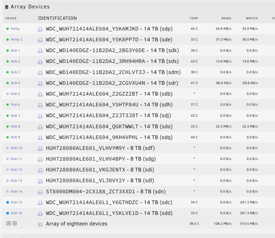

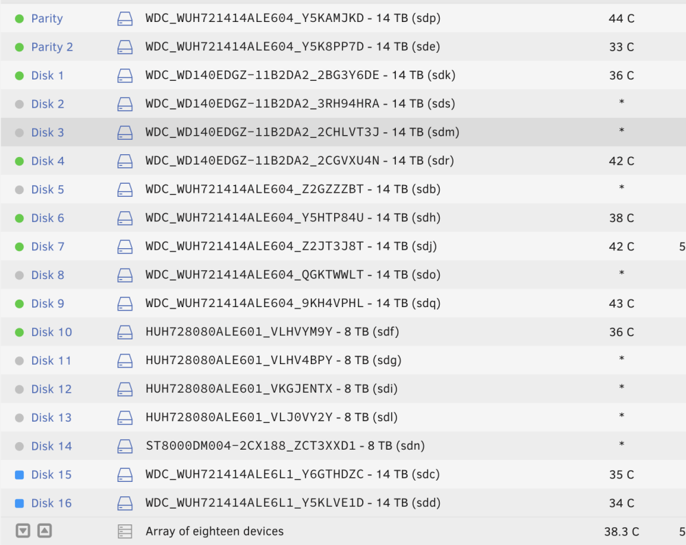

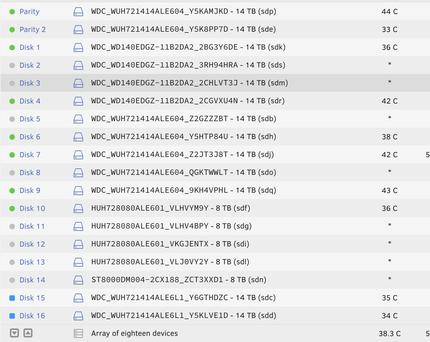

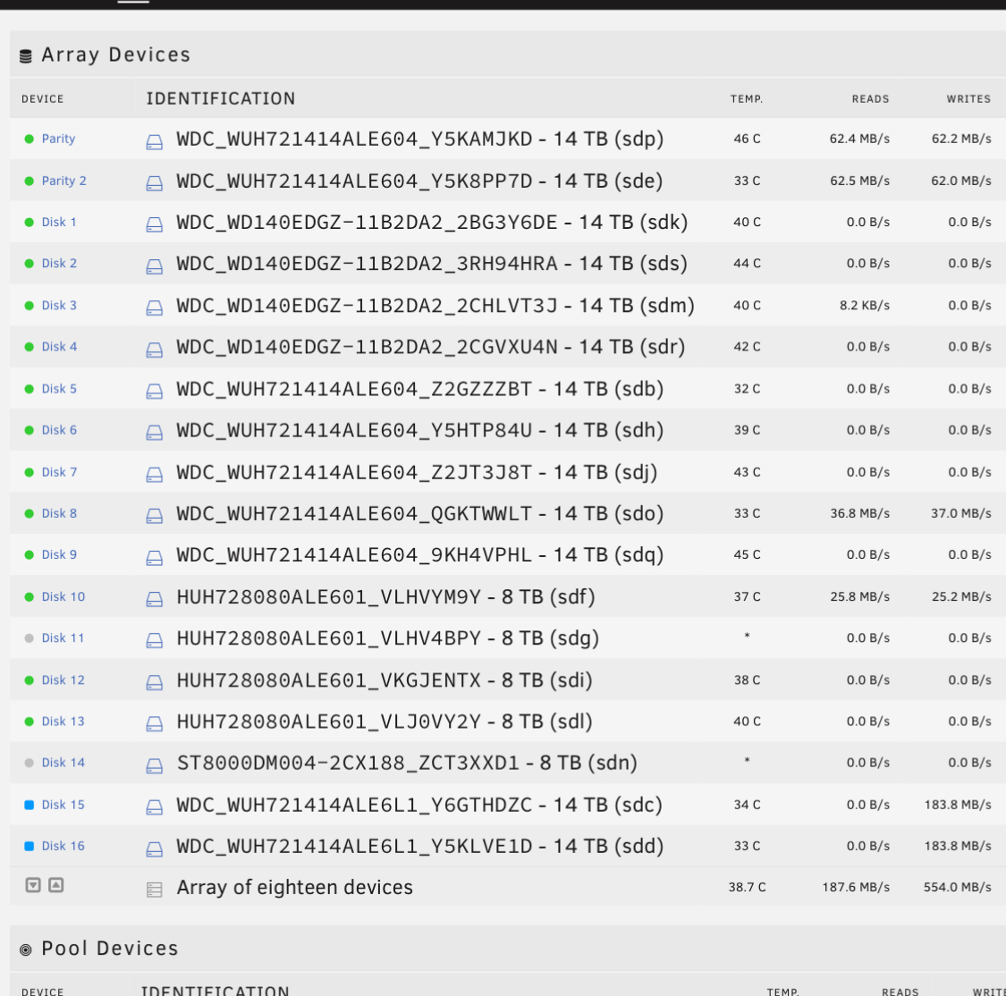

Looked at my server and suddenly several drives were showing gray. They didn’t say they were being emulated or anything. Then about 10min later they changed up. Anyone had this happen before? When I click on each drive they show everything is ok.
bottom image happened first then later the top. I’m on my phone.
That just means they are spun down
they have the * for the temps does it stop registering that if they're spun down?
