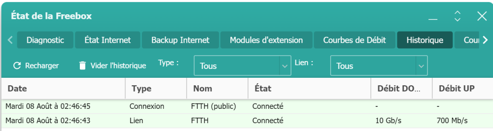

But how to take advantage of the SSD-CACHE to boost the data transfert ( I have a local 10G network, and my internet provider is FREE with a 10Gb/s 700Mbs bandwith ). Some of my users are not in the same city !
