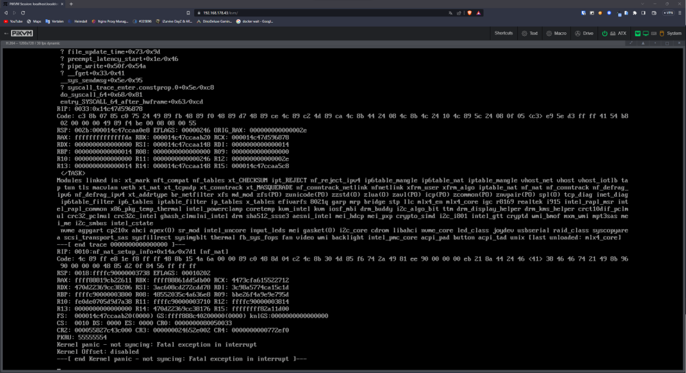

My unraid server has been running fine for the last year or so. But recently it keeps crashing every couple of days. I honestly dont know where to start with troubleshooting would be awsome if someone could help me out. I'll attach the last log and disgnostic files to this post. And also a screenshot from the last therminal/log i can see on my PIKVM after a crash.
syslog dekluis-syslog-20230812-0929.zip dekluis-diagnostics-20230812-1128.zip
Solved by JorgeB
Aug  8 00:07:53 DeKluis kernel: macvlan_broadcast+0x10a/0x150 [macvlan]
Aug  8 00:07:53 DeKluis kernel: ? _raw_spin_unlock+0x14/0x29
Aug  8 00:07:53 DeKluis kernel: macvlan_process_broadcast+0xbc/0x12f [macvlan]
Wwitching to ipvlan should fix it (Settings -> Docker Settings -> Docker custom network type -> ipvlan (advanced view must be enabled, top right)).
Do you know whats wrong with MacVlan? Because i think it did the trick switching to ipvlan. I just like the way MacVlan works how a client can get an IP from DHCP and be reconized as sepperate clients. It took me a solid day to switch to ipvlan but i think it works it has been stable sinds. Thnx for the advise.
It's an old issue, but new users keep getting affected, starting with 6.12.4 it should be possible to use macvlan again without stability problems.
