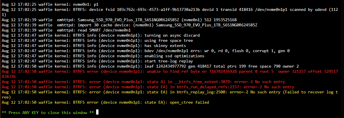

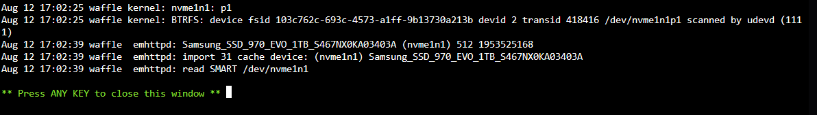

I wasn't able to access my services on my server. I log in to find that most of my docker containers had stopped except for a few still running. I attempted to run one of them but was given a 403 error code. I did a quick search and saw that it was in reference to a full cache pool. I checked my cache pool and it still showed plenty of free space. I then restarted the server and was met with my cache drives being unmountable.
The process I performed which may have lead to the cache's demise was such: I had a m.2 drive I was on a time crunch to backup. I had a m.2 to USB adapter on order but was afraid it would not arrive on time. I would need to use the m.2 slots in the server, but to reduce risk of data corruption if I took them out I began transferring data off the cache pool to the array by changing "Use cache pool: prefer" to "no" and evoking the mover. The USB adapter did arrive in time and I backed up my m.2 to the array. I left the mover doing its thing until it finished moving my various share's files to the array. I then set my shares back to "prefer" and I noticed that some files had a duplicate stored on the array and on the cache specifically 2 appdata folders, the docker container image, and my VM image. According to unraid they were stored both on Disk4 (or Disk6) and Cache. I evoked mover again and the duplicates didn't disappear. I restarted then evoked mover once more and the duplicates remained still. Some time later I reach the 403 error and after a restart the cache pool is unmountable now.

I have 2 cache drives. 1 TB each. Set up in raid 0 equivalent. Most of their data should be duplicated on the array if unraid Shares tab is correct. Appdata is nowhere on the array but I have an older backup on my personal computer.

If the log tree is the only problem this may help:
btrfs rescue zero-log /dev/nvme0n1p1
The re-start array.

Holy smokes looks like that worked. So glad I didn't screw up the file system trying to fix it myself like I did last time some months ago. Last time I took my cache drive out and accidentally set it back up as btrfs instead of it's original xfs.
