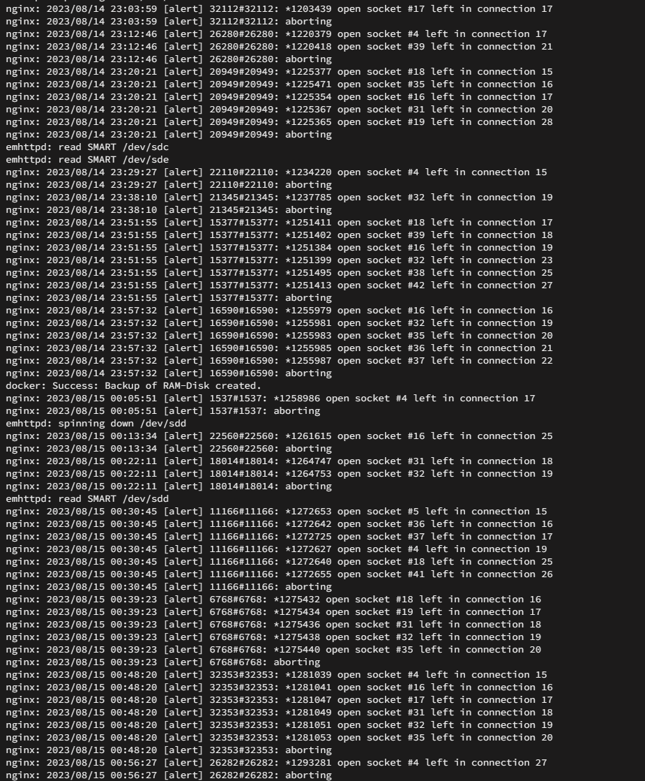

Regarding the nginx crash itself. it does seem to be browser dependent. On Microsoft Edge, it looks like this
If im on my Android Phone and use Chrome, i absolutely cant get the Webui to work properly at all. The Terminal is broken, the Log popup is broken. The page freezes horribly and i get worker exit message, as you do.
I havent gotten around to test it with Firefox yet. it might fare better, but the only real solution is a downgrade to 6.11.5 or wait for 6.12.4.
