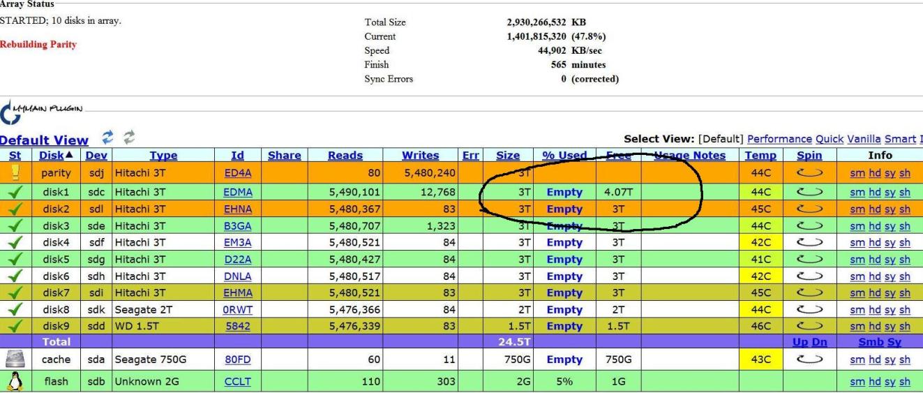

What I meant by 26 drives in the drop down box is not exactly right.  All it means is that unRaid will inventory up to 26 storage devices from which one will be the Flash device; you can pick 21 of them to be in the array, and another to be the cache drive.  The length of the list will never be longer than the number of installed hard drives however.

Not sure if this is the place to post this issue, but it didn't show it head until I upgraded from B12, to B12a. One of my drives is now showing 4.07TB of free space, not the 3TB that the drive is. I am posting a screen shot as well as the latest syslog.
Don't get me wrong, if I can squeeze more then 4Tb on a 3TB drive, I want to know how to make the others do the same.

What does it say on the standard unRAID webgui?
The same thing as unMENU/mymain.
