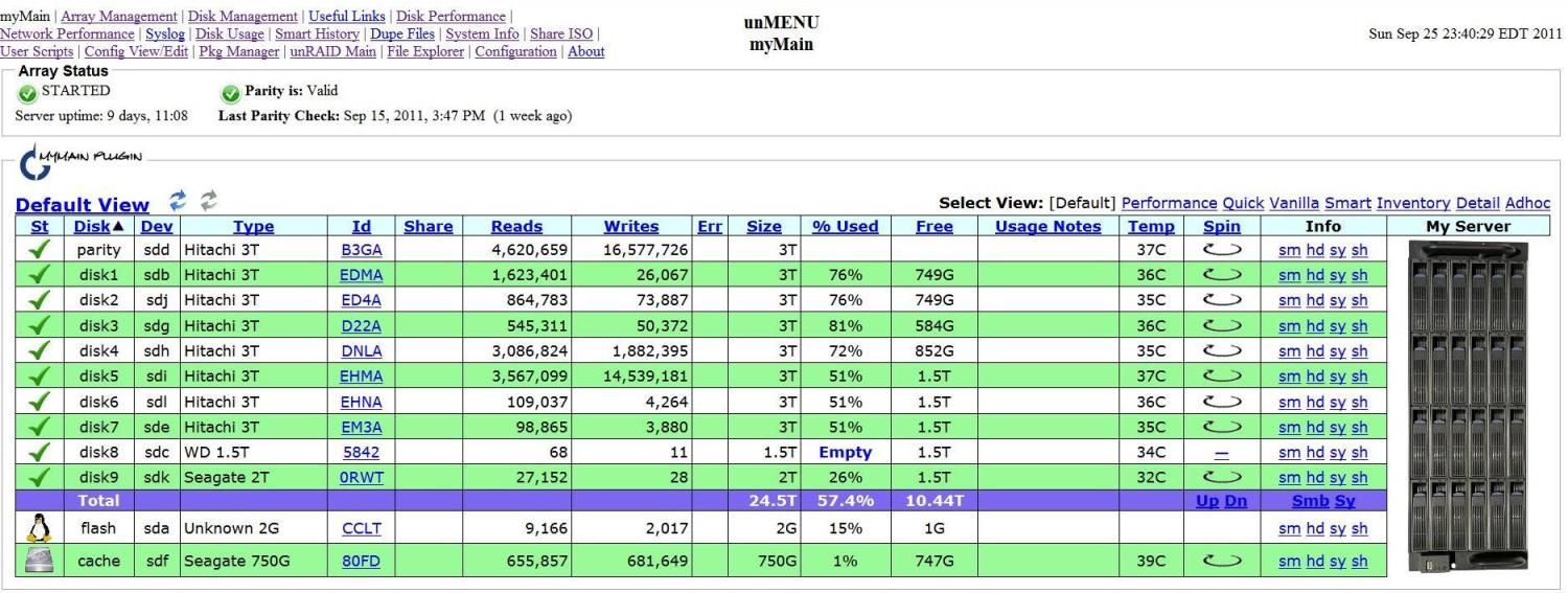

As you can see from the screenshot multiple 3tb drives (although on beta9)
Which saslp firmware are you running ? .21 ?
I tested this card with 4 3TB drives and it worked fine.

 I am running 9 (Nine) 3TB drives using this card, and 5B12 with no issues of any kinds. So maybe your issues start with other hardware choices you made.
After I run pre_clear I did have a couple issues with one drive. It was showing 723TB free at one point, I wish I had taken a screen shot. I did take one and post it here when showing much less than that, but well over the 3TB capacity of the drive.
But I have been up and running for a couple weeks now, and all is good on the home front.
@Lars Olof, don't be sorry for the 'rant' .. I can take it ;-)
I didn't start with 4.7 as I wanted to start with 3TB drives, but along the road I came to the conclusion that
my "Supermicro 8-Port SAS/SATA Cards (3xAOC-SASLP-MV8) don't support >2TB.
I am fully aware of the BETA stages and I respect them, but let's say 4.7 works without the  "BLK_NOT_HANDLED" issue, why would this be an issue in the new beta serie (5bxx)?
