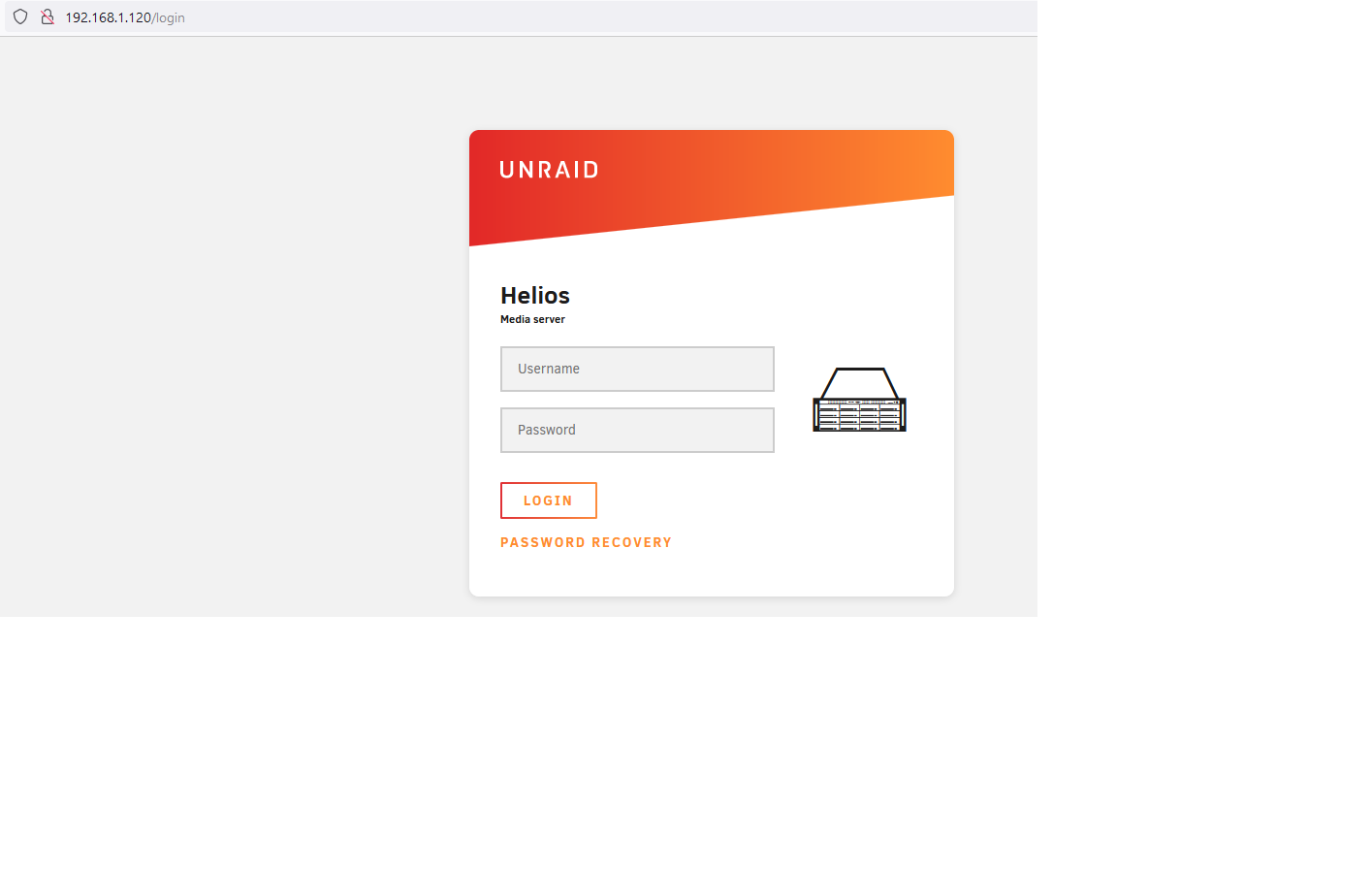

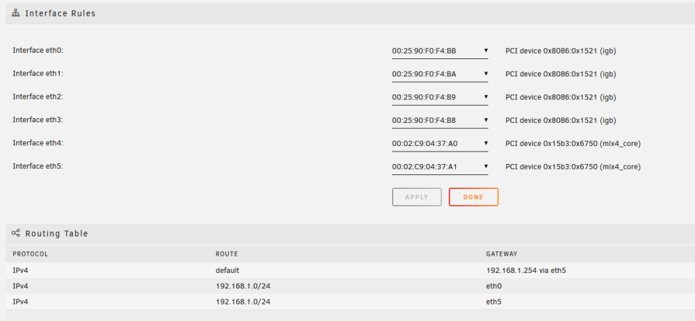

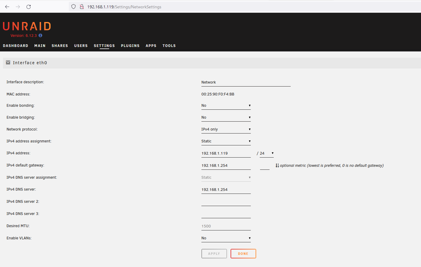

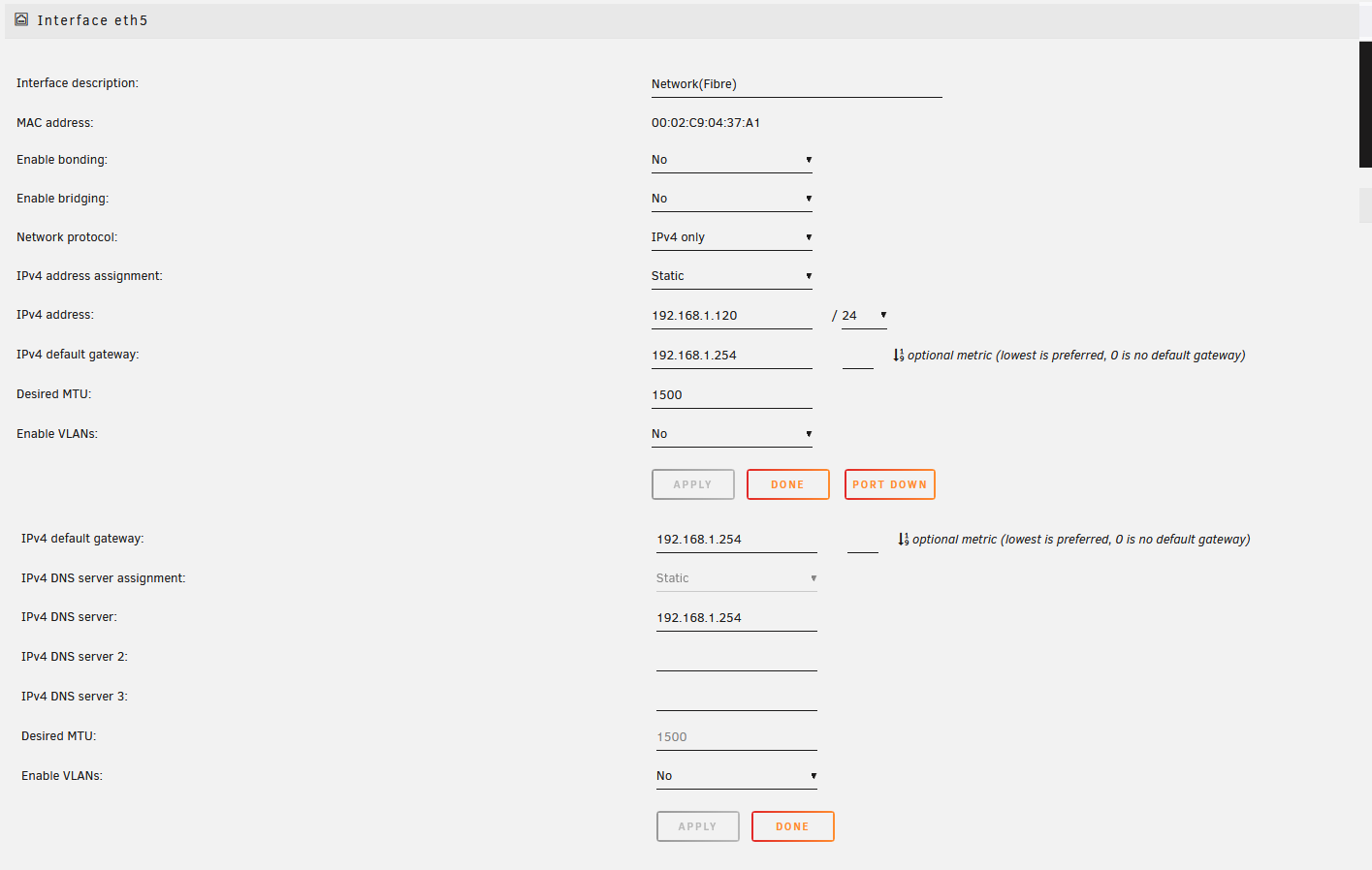

August 13, 20233 yr I am trying to assign my unraid server to a 10Gb Nic. Once I assign its mac address to the interface eth0, it will not connect to the dhcp server nor load anything. So far, I am able to assign it to another interface (eth4, eth5) under a different ip as the server. Upon testing to see if the server is accessible from that IP, I am able to load the unraid web interface. Now to start testing to see if data is flowing via the original 1Gb Port or the new 10Gb Port, I remove the data link (fibre) from the 10Gb port and the web interface is still able to load from that ip again(Data flows from 1Gb port). Screenshots to show my config.
August 13, 20233 yr Assign either 00:02:C9:04:37:A0 or 00:02:C9:04:37:A1 to eth0 which ever port the fiber is connected to.
August 13, 20233 yr Author 1 hour ago, bchng said: Assign either 00:02:C9:04:37:A0 or 00:02:C9:04:37:A1 to eth0 which ever port the fiber is connected to. I have tried this option prior to the post and have tried it again. This didn't work. Do you have any other ideas? Thank you for your reply.
August 14, 20233 yr 4 hours ago, Atheism said: Once I assign its mac address to the interface eth0, it will not connect to the dhcp Change back the 10g nic to Eth0 and reboot, keep use static IP first and try again. Setting both nic to same subnet will have "odd" behaviour. Edited August 14, 20233 yr by Vr2Io
August 14, 20233 yr Author 7 hours ago, Vr2Io said: Change back the 10g nic to Eth0 and reboot, keep use static IP first and try again. Setting both nic to same subnet will have "odd" behaviour. Thank you. I decided to completely remove both the eth5 option and make the only connection eth0, which is under the mac address:00:02:C9:04:37:A1 Resulted in not connecting or loading. I'm wondering if my generation of mellanox connectx card is not compatible. Thank you for your suggestion.
August 14, 20233 yr Seems to be problem on 10G switch, it doesn't connect to your existing network. As port was up so I don't think it is 10G nic problem. Edited August 14, 20233 yr by Vr2Io
August 17, 20232 yr Author On 8/14/2023 at 7:46 AM, Vr2Io said: Seems to be problem on 10G switch, it doesn't connect to your existing network. As port was up so I don't think it is 10G nic problem. Sorry for a long wait on the response. I had no config changes since changing the server from running base linux to unraid. I have concluded that my card may have been flashed with a bad firmware....I have purchased a replacement/more updated card. Thank you for your time/suggestions.
