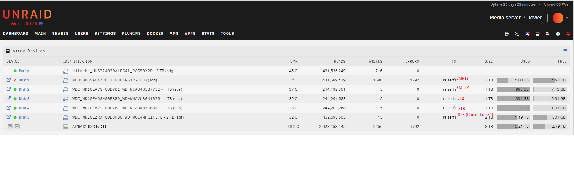

August 15, 20233 yr Hello, My server was running a parity check last night and I got a disk error. Disk1 has errored on me before and I've replaced it with the current disk which continued to have intermittent failures (it's been disabled due to errors it seems like once every couple of months and failed about 2 to 3 times now on the replaced disk.). I know I need to update my hardware a bit (CPU/Mobo/Ram) because what I'm running is ancient but I have a couple of questions about my current situation. 1. Is it ok to rebuild onto disk1 based on the attached logs? 2. Since I've replaced the sata connection on disk 1 and replaced the drive itself I wonder if it's not an issue with that port failing on my mobo. If this is the case I realize the long term fix would be to replace cpu/mobo/ram, but in preperation for that I wonder if it's a good idea to consolidate disks to the point of not needing to use the sata port that disk1 is connected to? as you can see I have several 1TB drives I could roll up into 3TB drives and reduce the total number of connected drives so that when I replace the mobo I don't have to carry over as many drives and I can have an extra sata port to switch disks to a newer FS. Something like this: Or I could update the parity to a 4TB disk and then buy another 4TB data disk. Thanks for the help, it's pretty remarkable I've been running this machine for over 13 years now with little issues/maintenance until now. tower-diagnostics-20230815-0836.zip Edited August 15, 20233 yr by cobolstinks

August 16, 20232 yr Community Expert That disk has a failing now SMART attribute, though it's not one of the worst ones I would recommend replacing with a new one, if you don't have a spare or prefer not to replace it now, and assuming the emulated disk1 is still mounting, you can rebuild on top, replace cables before to rule that out.
August 16, 20232 yr Author 15 minutes ago, JorgeB said: That disk has a failing now SMART attribute, though it's not one of the worst ones I would recommend replacing with a new one, if you don't have a spare or prefer not to replace it now, and assuming the emulated disk1 is still mounting, you can rebuild on top, replace cables before to rule that out. Ok thanks for that information. I will look at replacing the disk. One last question. This server is aging and I know I need to do several updates. 1. I need to change the file system from RFS to XFS on all my data disks. 2. I need to update the hardware. I'm noticing slowness when mounting the shares, the dashboard shows my CPU ram maxing out at times, and several of my disks run hot. So I'm looking to update the mobo/cpu/ram in the near future. How would you recommend proceeding with these upgrades in mind? I'm considering buying 3 4TB HDs 1 parity, 2 data disks and consolidate my server from a 6 disk array down to 3. I currently have a 3tb parity disk... Should I try to rebuild ontop the existing disk and if it works update the parity disk to a 4TB and then consolidate on the old mobo/cpu/ram? Or should I just update the mobo/cpu/ram and rebuild on that and then update the disks and then do the FS update? Edited August 16, 20232 yr by cobolstinks
