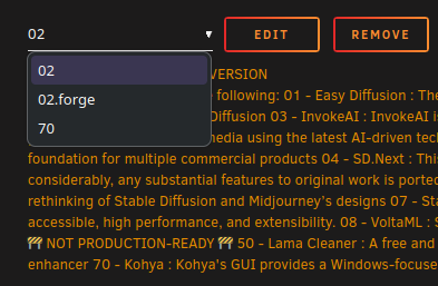

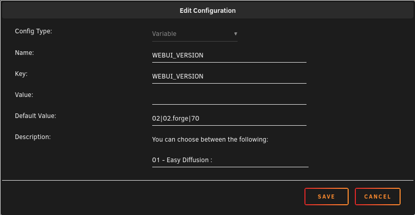

11 hours ago, whitewlf said:
I do have a question: How did you get Forge installed on this docker?
The way I do it is to edit the WEBUI_VERSION key, separating my choices with a pipe:
Then after saving, I get a nice an easy dropdown to select my preferred UI:
Literally just add (or replace the existing value) this to the WEBUI_VERSION key:
02.forge

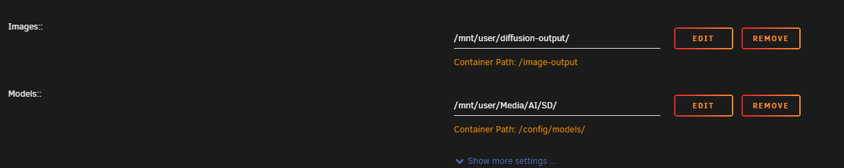

This is the first time I've installed this container. I want to point Models and Outputs to a different path than appdata.
I followed a previous post which added a Path variable for /config/models. Works.
However, changing the output path isn't working. The same post mentions /config/output, but no matter what I set this to, the outputs are always going to appdata/.../02-sd-webui/webui/output.
If I can't change this in the CA container template, is there another way to do so?
Thanks.
Not sure if this is what you are stumbling against, but, the script that this runs on does some voodoo when it starts. After you see it, you can understand it's usefulness and how to work with it. You just cannot work -against- it. Took a little snooping to figure it out on my own, but, it is probably on the git page as to how it works.
(From my understanding) in order to keep a central point of storage between multiple installations/types of stable diffusion, it creates symlinks internal to the docker to point to each folder for common files, like models and output (and loras, vaes, embeddings, etc)  I included a trimmed snippet below of the log output showing what gets associated to where in the 02 A111 installation which I am using:
moving folder /config/02-sd-webui/webui/models/Stable-diffusion to /config/models/stable-diffusion

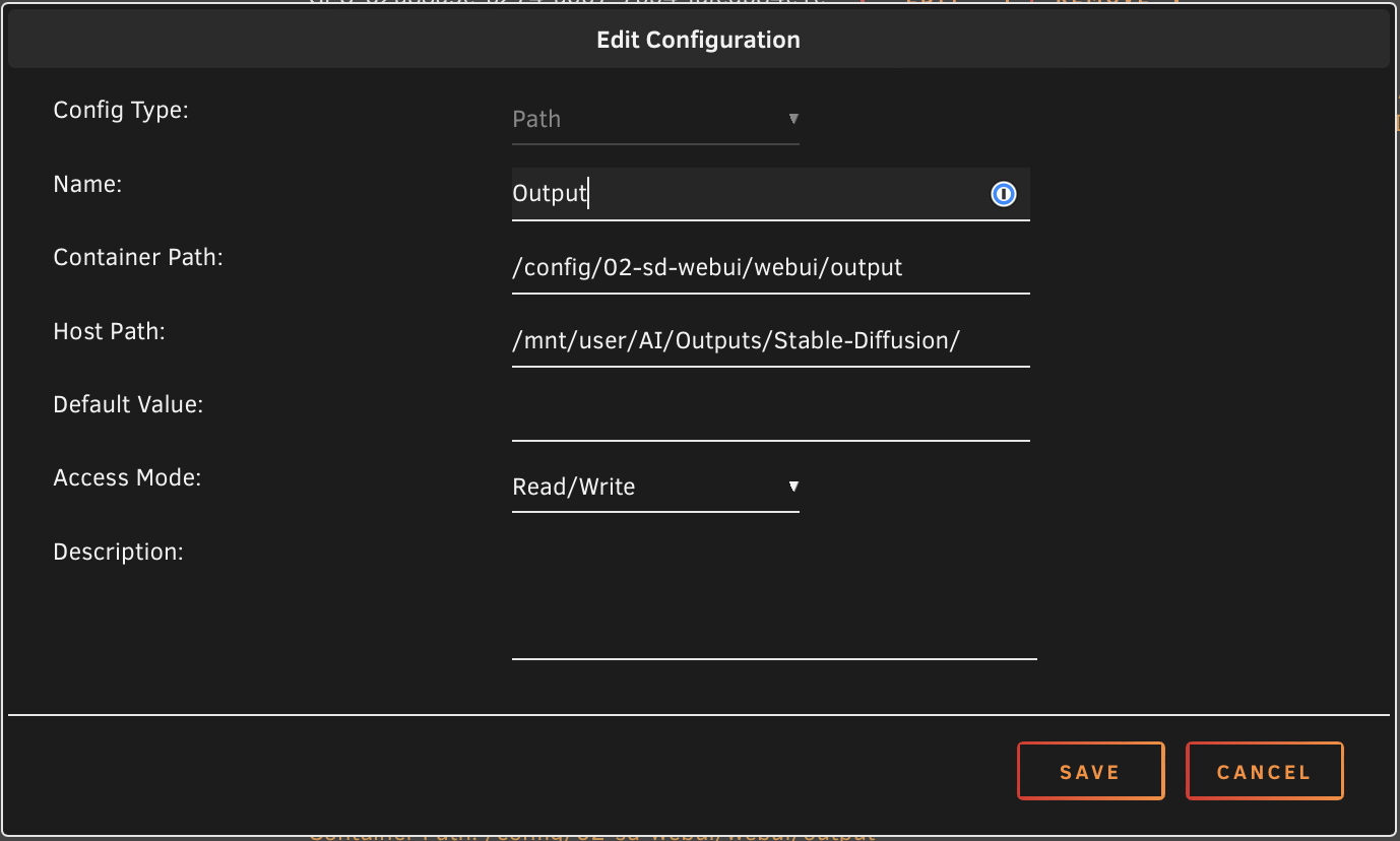

I looked at the directories in the log file compared to what was created on the server.
moving folder /config/02-sd-webui/webui/outputs to /config/outputs/02-sd-webui
removing folder /config/02-sd-webui/webui/outputs and create symlink
The directory structure.
output/
outputs -> /config/outputs/02-sd-webui/
In the WebUI, the path settings are set to defaults and look like this:
output/txt2img-images
output/img2img-images
output/extras-images
I was confused why the symlink created is named "outputs" yet the actual output directory is "output." All of my saves were going into "output" which would be inside the appdata folder.
For Container Path, I used /config/output/ and pointed it to my server share. however Images would still be saved into appdata, not my share. I tried variations of the Container Path value such as /config/outputs but it still saved into appdata.
I finally found a Container Path value which works:
Container Path = /config/02-sd-webui/webui/output
I thought I had tried this before but may have used /config/02-sd-webui/webui/outputs which didn't work (guessing) because the install script was already creating a directory named "outputs" and the symlink.
I'm not sure if this will break something later on, but it's working...my saves are going to my share. I'm also unclear how other folks (yourself included) are using a different Container Path with success.
747785386_Screenshot2024-04-05at11_47_33AM.thumb.png.be03cccb76e824311cbc8b4601d433a3.png

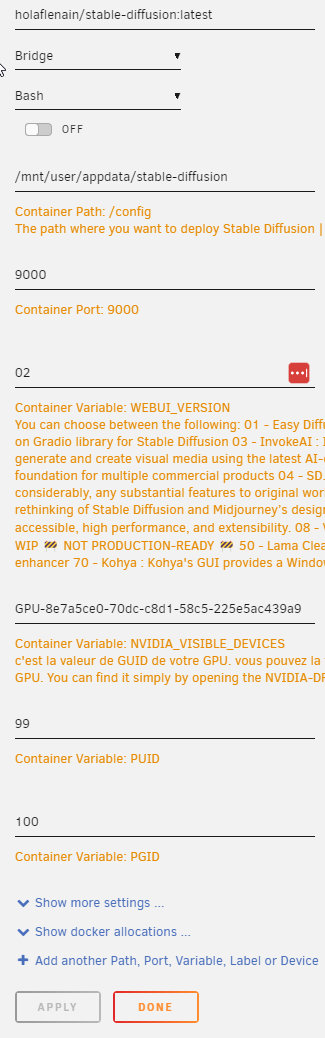

Hello, I'm very much a beginner and hasn't used unraid in years, but I wanted to try setting up SD for it but I can't access the WebUI since I most likely have incorrect PUID and PGID.
I don't run rootless containers by podman so I tried finding out the PUID and PGID of the user I have created. using the "id -u" or "id -g" only returned 0 since I'm logged in as root. however running "id 'my username')" gave me this: "uid=1000(my username) gid=100(users) groups=100(users)" So I tried entering PUID = 1000 and PGID = 100, but to no success.
So I'm wondering how to find out the PGID and PUID of my user (in case I did it wrong). And in case I did it right I'd curious why I still can't connect to the web UI.
*In the pic I use PUID 99 as I wanted to try the default value.*
