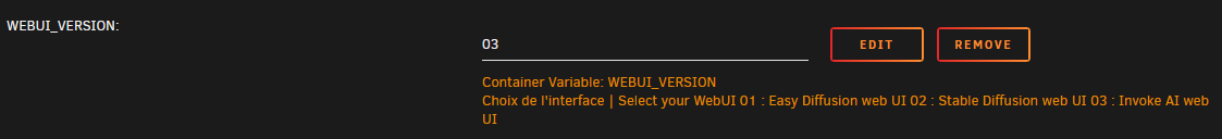

Hi @superboki
Thanks for this template.
After successfully installing and running the Automatic1111 (standalone) docker template, i wanted to give yours a go (as it offers more  flexibility and choice of all UIs).
I'm getting the following error on loop (from logs) :
App is starting!
Reading package lists...
Building dependency tree...
Reading state information...
Package 'python3' is not installed, so not removed
0 upgraded, 0 newly installed, 0 to remove and 0 not upgraded.
/entry.sh: line 18: /03: No such file or directory
/entry.sh: line 19: /03: No such file or directory
/entry.sh: line 20: /config/scripts/03: No such file or directory
/entry.sh: line 21: /config/scripts/03: No such file or directory
error when launching WebUI
Where do i need to look to fix this ? (i made a mistake at first, i defined the UI model as "03", but then edited the template and made it "03 - InvokeAI" (maybe this is the error?)
Thanks
hello @Yagami I'll try to do a clean install to see if I have the same kind of error.
@OddsodzAllMighty I'll take a look at it.
BTW, for those interested I add Fluxgym to the container as option 71
@Yagami everything looks fine on my side.
and effectiveley you just have to set the variable to 03 to select InvokeAI :
