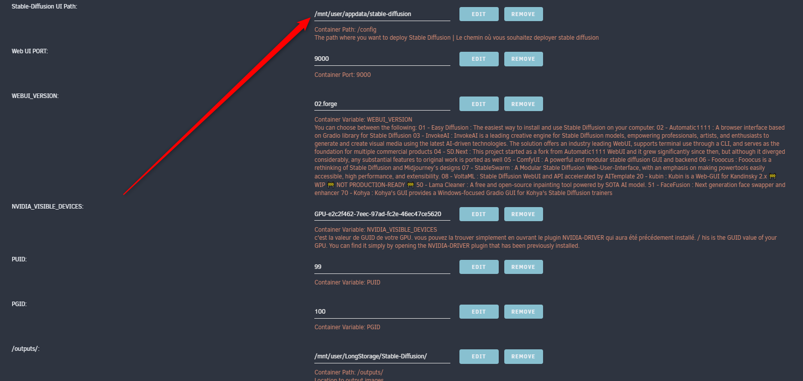

On 2024/8/12 at AM8点43分, mrguymiah said:
如果您不熟悉参数文件的位置,它位于您设置为 UI 路径的文件夹中。然后进入 Automatic1111 文件夹,您将在那里看到参数 txt 文件。

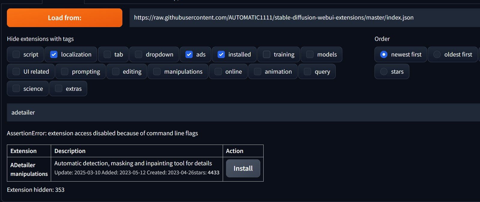

How do I fix "AssertionError: extension access disabled because of command line flags" when installing extensions? I've googled it and all I've found is remove flags, install extensions, and reapply flags... but how the hell do I do that?
do you have solution for that?
