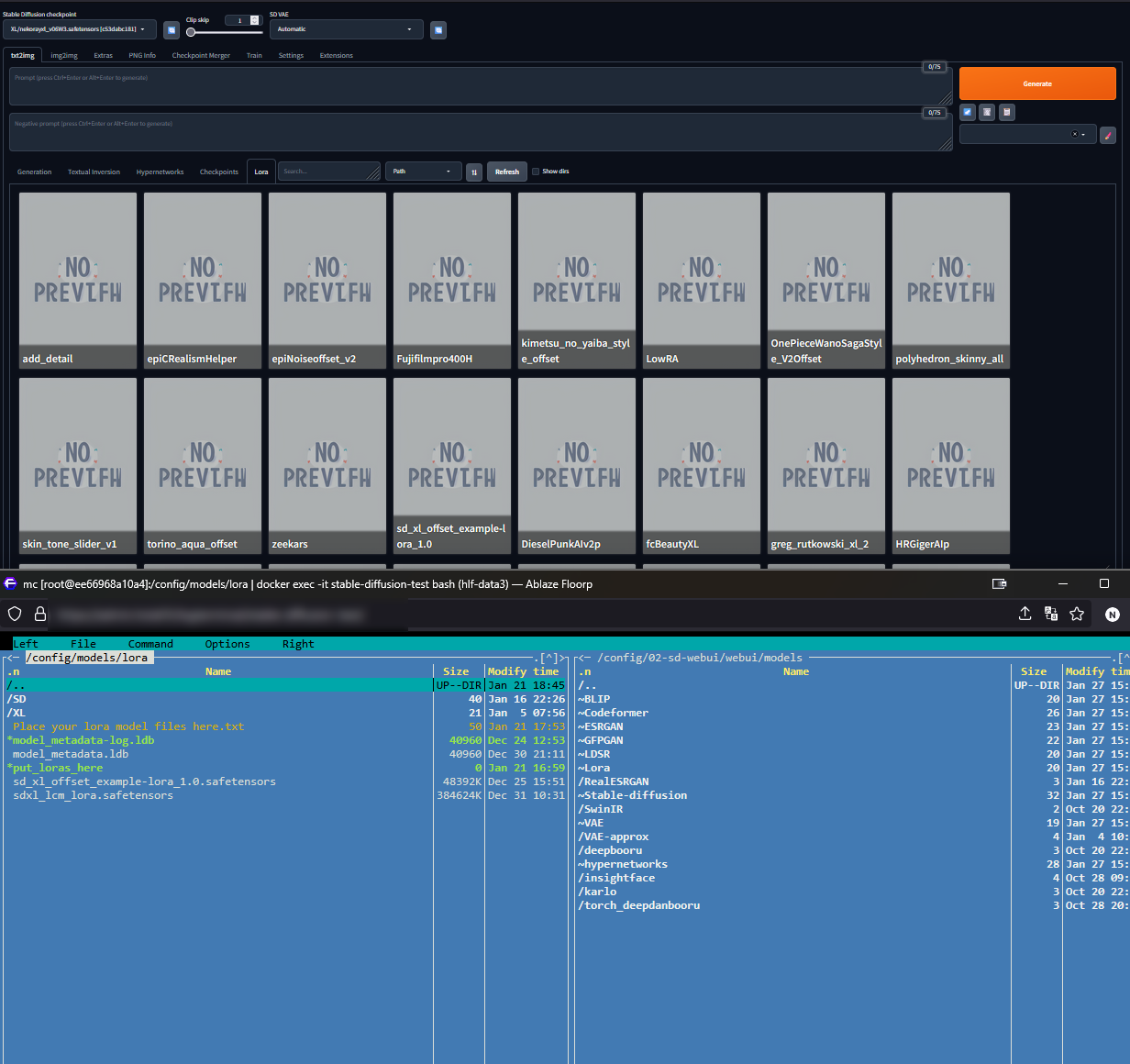

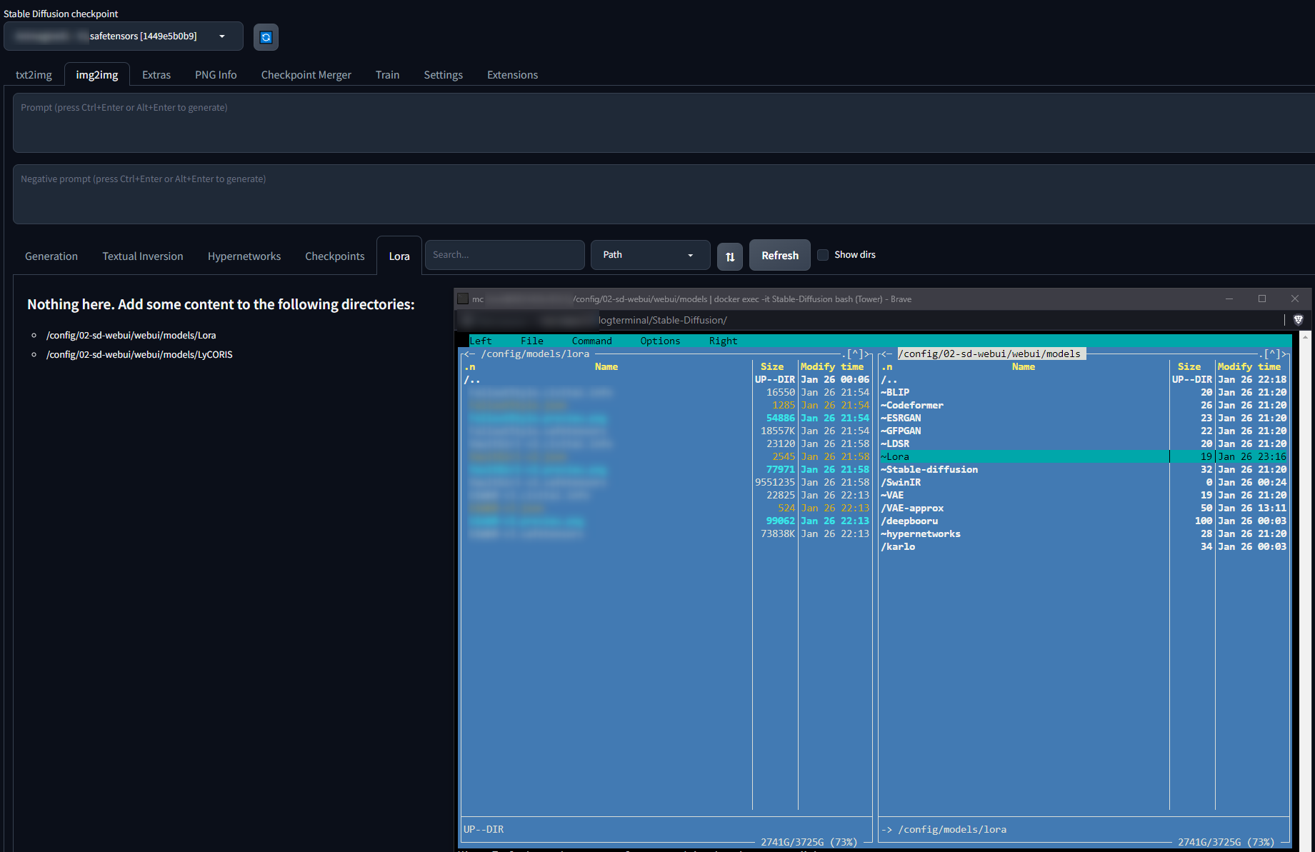

Hey Holaf,
I found an interesting issue with the Automatic1111 Implementation, that may extend to others. From what I can tell, the Container creates a symlink from the chosen WebUI's folder to the folder in the base directory. This works for Checkpoint models, but doesn't appear to be working for Loras. See imaged attached that I have files in the /config/models/lora folder and have confirmed the functionality of the symlink at /config/02-sd-webui/webui/models/Lora. However, Automatic1111 states that they're not there. However, it IS able to see my checkpoints.
My apologies if this is an issue with Automatic1111 and not your image. I just find it odd that it'd be able to load one set, but not the other. And the link has to work well enough for the Civit.ai WebHelper Extension to be able to download and save the files through the symlink to the correct folder.
Edited by mrguymiah
Expansion on existing content.
@mrguymiah Strange, it's working fine with me 😵💫
When you go into /config/02-sd-webui/webui/models/Lora do you see your files ?
Yes. When I hit "Enter" on the symlink, it does show the contents of /config/models/lora. And, as you can see in my image (reposted for convenience), the symlink reports functional in Midnight Commander, and has the appropriate capitalization. Could it be an issue that the folder that the symlink points to has the lowercase "L"?
@GradwellZA Perhaps they change something in the installer 🤔
I'll take a look.
@mrguymiah
what's important is the name of the link, the name of the folder it points to doesn't change anything.
When the interface is launched, you can try to delete the Lora symlink and replace it with your folder (with an uppercase L).
Then click on refresh to check if it sees the loras 🤷‍♂️
(at the next launch of the container the folder will be moved again to the common folder)

please specify exactly how i point my embeddings on my array to the a1111 container. i got it with loras, but not with my embeddings
I had the same issue, it looks like it's a bug of auto1111.
I reinstalled it from scratch and embeddings were back.
embeddings should be stored in the models/embeddings folder (eg : /mnt/user/appdata/stable-diffusion/models/embeddings)
if you don't want to reinstall you can try to add this option in the parameters.txt file :
--embeddings-dir "/config/models/embeddings"
