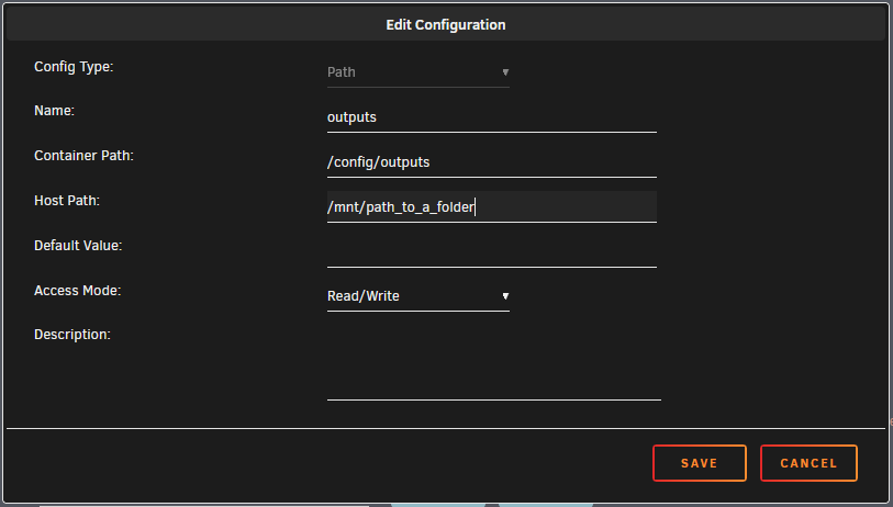

3 hours ago, Wesley_Sun said:
Hi @Holaf,
Thank you for bring Stable Diffusion to CA App.
May i know if there is any way we can split /models and /outputs into different hard disk? I would like to put huge I/O to a different SSD, instead under /appdata
Thank you
Yes there is a way :)
With unraid on your container config you have an option at the bottom to add another path.
You'll have to add two path :
one that points to this one inside the container :
/config/outputs
and one to :
/config/models
for example for outputs it should looks like this :1720747365_Capturedcran2024-02-17213402.png.3ebc7c1ced0645a6caf0d616a86baf29.png

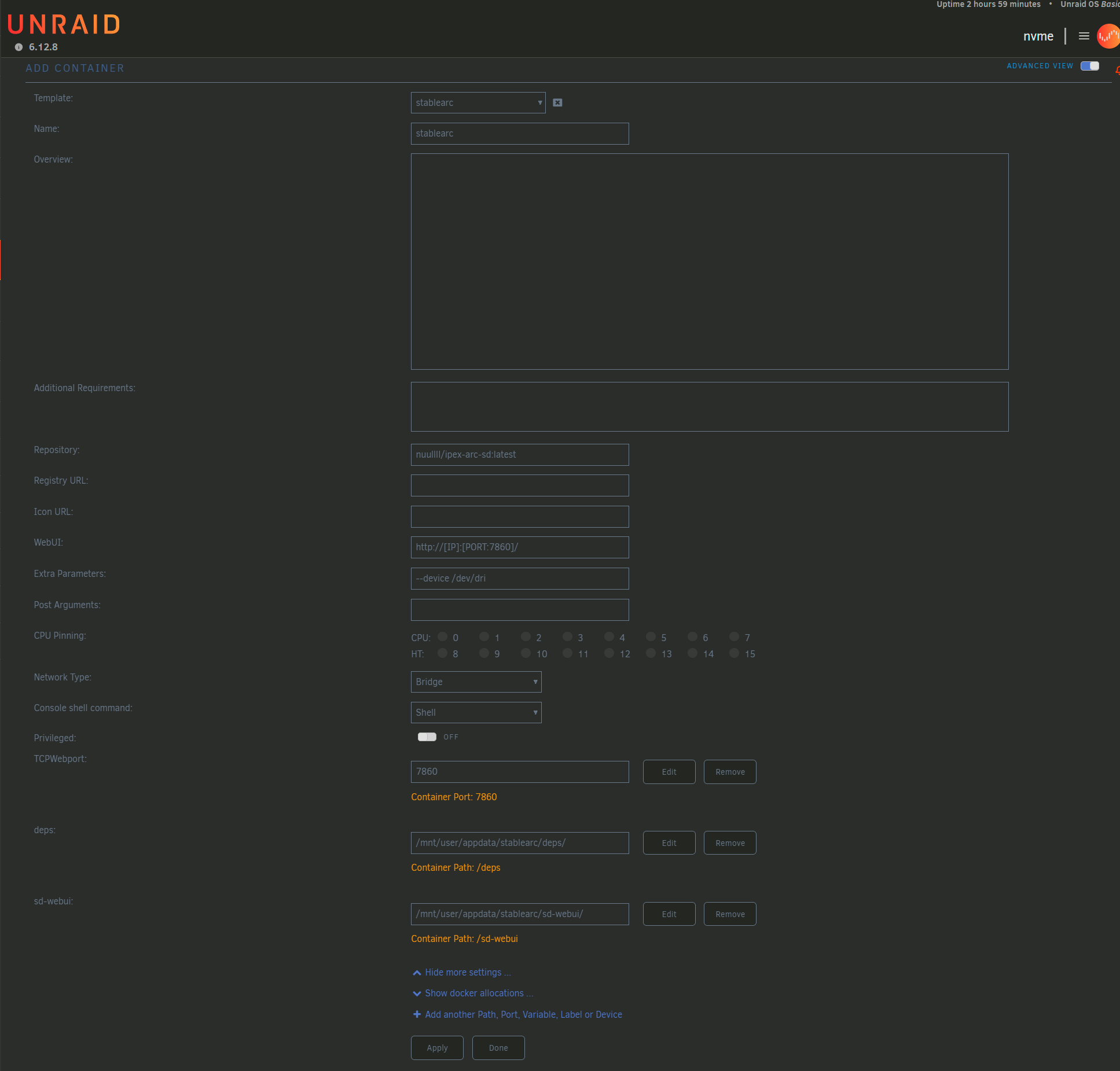

Is there a way to use this with a Radeon GFX ?
i Got a RX 550 with 4 Gig on it and it has nothing to do so i coudl use it.
I tried to install your Docker but in the settings at the beginning theres a place to write in a GFX ID or whasoever and its asked only about NVidia Number
so i sopped installing was seeking for this answer in the net didnt find anytrhing and now i ask here.

2. I figured out why Forge isn't saving its outputs. It's because I was wrong and it actually is but it's saving them in an unexpected location.
All versions (A1111, ComfyUI, etc.) send their outputs to:
appdata/stable-diffusion/outputs/
Except for Forge, which sends its outputs to:
appdata/stable-diffusion/02-sd-webui/forge/output/
How can I change this to make Forge save somewhere inside of this location?:
