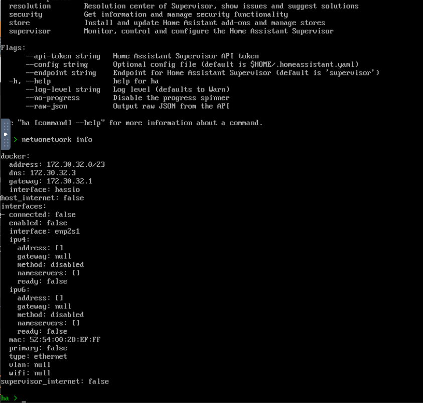

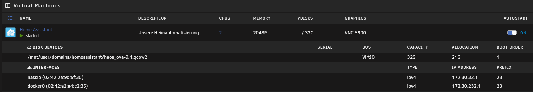

February 13, 20242 yr i have also the same thing, i just tried to move the .qcow2 and went back, because it didnt go online with a ip adress as before. no i also have no ip adress anymore with the file in the old place. guest agent not installed.... i remember i searched long for this before. unraid support is there, but i have so much stupid errors, i think i go back to dedicated seperate machines or even proxmox. dont want to play around so much time with the systems instead of applications itself
February 13, 20242 yr i found some weird shit: look at the cursor. there was raw instead of qcow2 which is the correct one, because of the file type. now it starts and has ip again. i can connect as before. this is the bullshit i mean. did cost me hours to find out. found it here some other topic, but with more than a ton of luck i saw this WTF Edited February 13, 20242 yr by insolvestor
