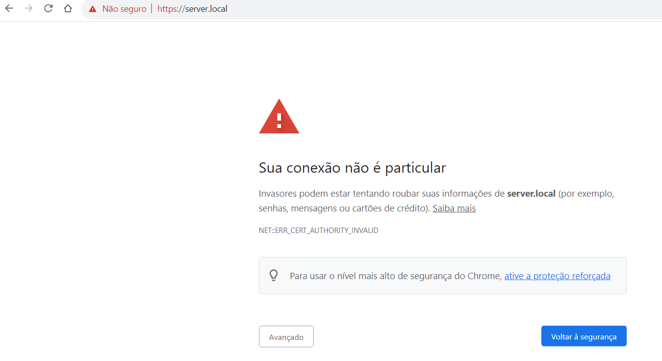

server.local not safe
How can I resolve this?
I wish this message didn't appear.
Tks guys...
Solved by ljm42
The cert needs to be signed by a CA the browser trusts.  Your options (to avoid seeing warning) are to turn off SSL or you can apply for a free myunraid.net Let's Encrypt certificate.  In your present configuration, the connection is still encrypted, just not trusted.
Where can I a free myunraid.net Let's Encrypt certificate?

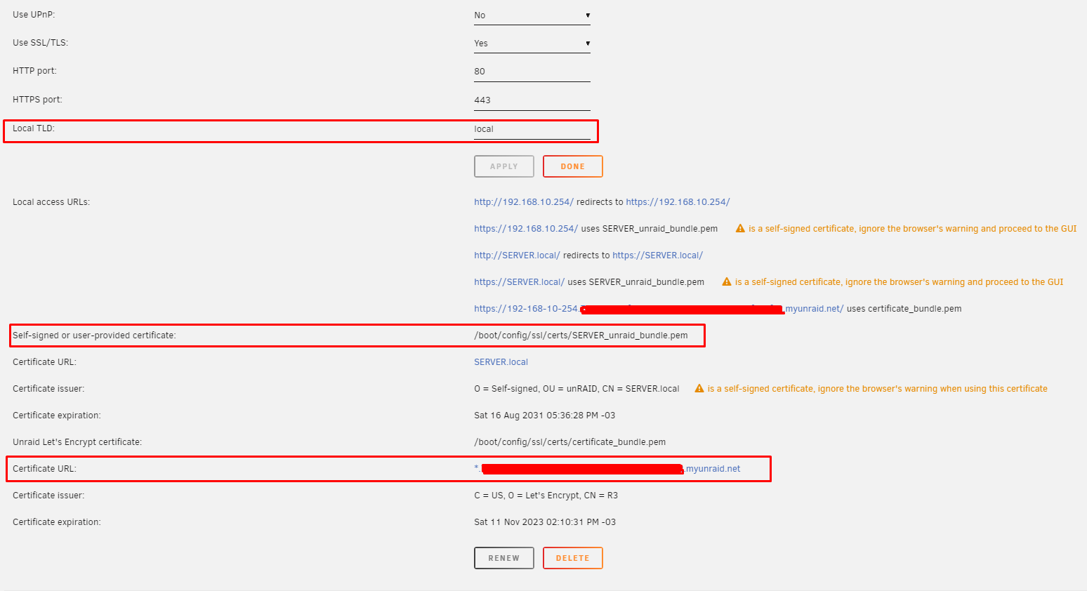

1) Secure Connection
A) I read the unraid manuals and saw that if I access my server at https://my_ip.my_id.myunraid.net it already has a secure connection (https)
B) If you access name_server.local it does not have a secure connection.
I understood, the option A, unraid provides SSL and the option B I have to install an SSL.

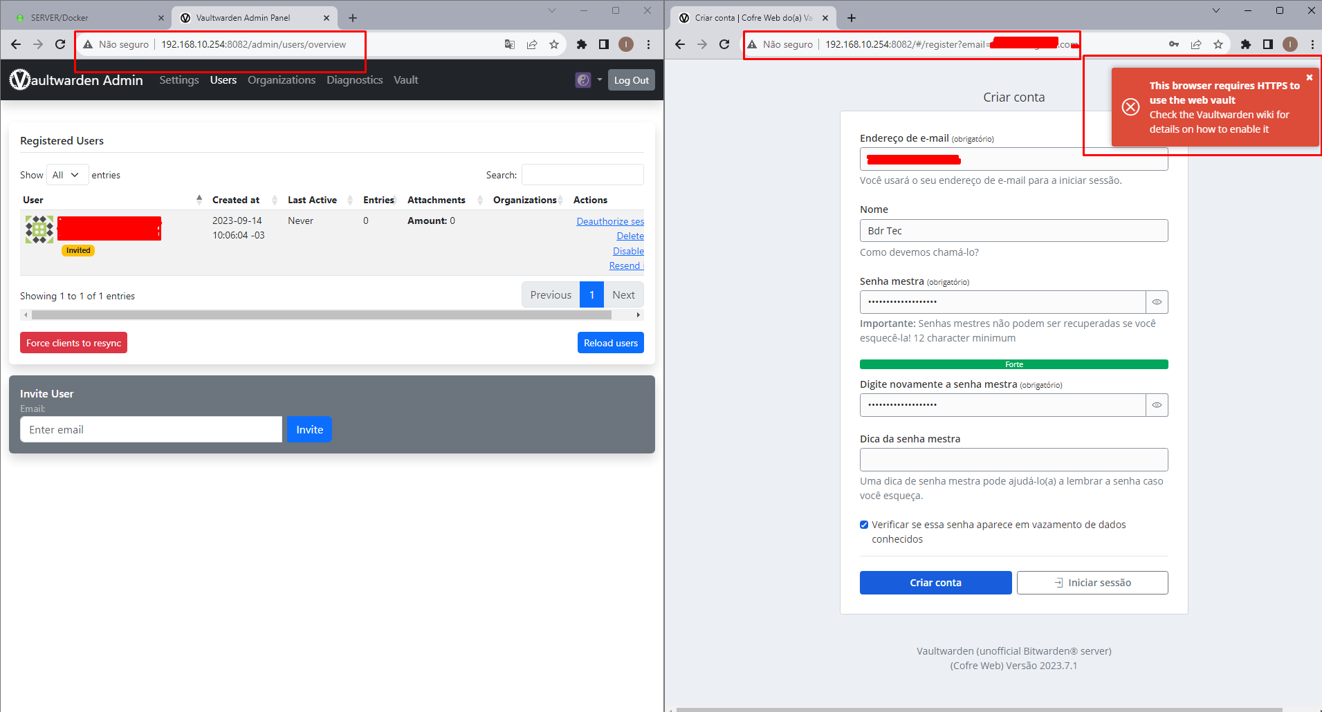

3) Docker Vaultwarden
I installed this docker and it won't let me connect to webUI without a secure connection (https)
Docker containers are not proxied through Unraid, so Unraid's certificate has no bearing on a container's certificate. You'd want to ask for help in the forum thread for that docker container.

12 hours ago, dlandon said:
How do you have Local TLD set?
I'm confused about how it works
12 hours ago, ljm42 said:
Now I'm confused : ) what is the "it" that we are talking about here?
It = docker Vaultwarden
Docker containers are not proxied through Unraid, so Unraid's certificate has no bearing on a container's certificate. You'd want to ask for help setting up that container in the forum thread for that container.
I'm confused about how it [Local TLD] works
The local TLD is used for URLS, such as:
  http://server.local
  https://server.local
The https url will use a self-signed certificate which causes browser warnings. But other than that it is fine.
If you had your own domain you could enter "mydomain.com" in that field and then the urls would be:
  http://server.mydomain
  https://server.mydomain
This also requires you to have DNS and provide your own certificate. More details in the docs provided earlier
Separate from that, once you provision a myunraid certificate you can access the server via a unique myunraid.net url using a valid certificate that we provide.
