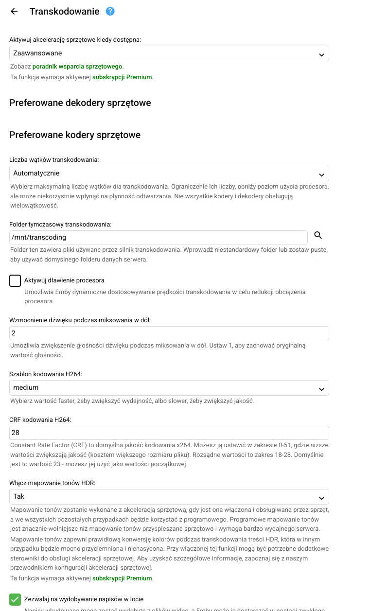

Hello, I install Emby (Emby Repository: emby/embyserver:latest) and there was VAAPI in my Transcoding settings working OK for some time. Then I try some VM's in Unraid and after that I noticed I don't have any option to choose in Emby. I remove VM's and disable it in VM manager. I try other containers from appstore but also have now HW transcoder to choose.

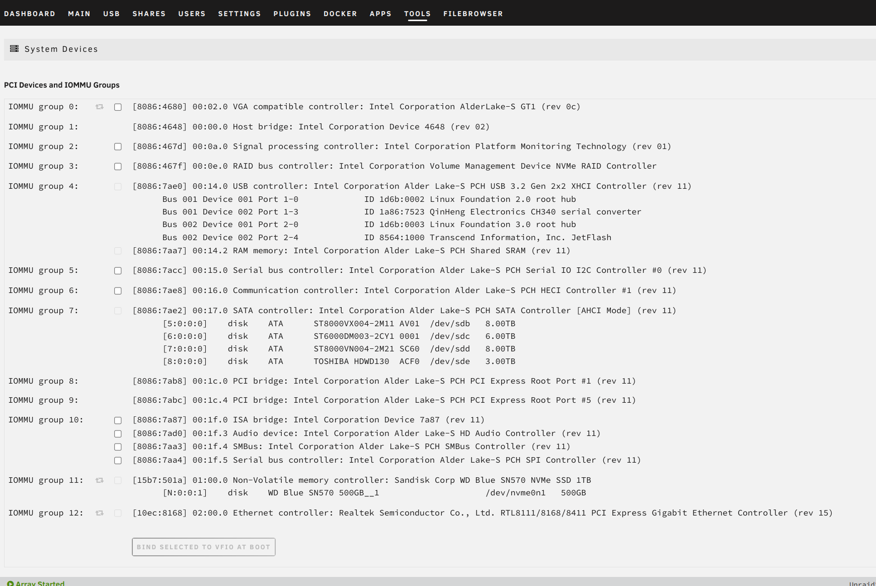

I don't have binded GPU to any VM in Tools>System Devices.
I have intel i5-12600k with integrated intel 770 UHD GPU. Intel quick-sync is not available in Emby for that GPU yet, but VAAPi works fine.

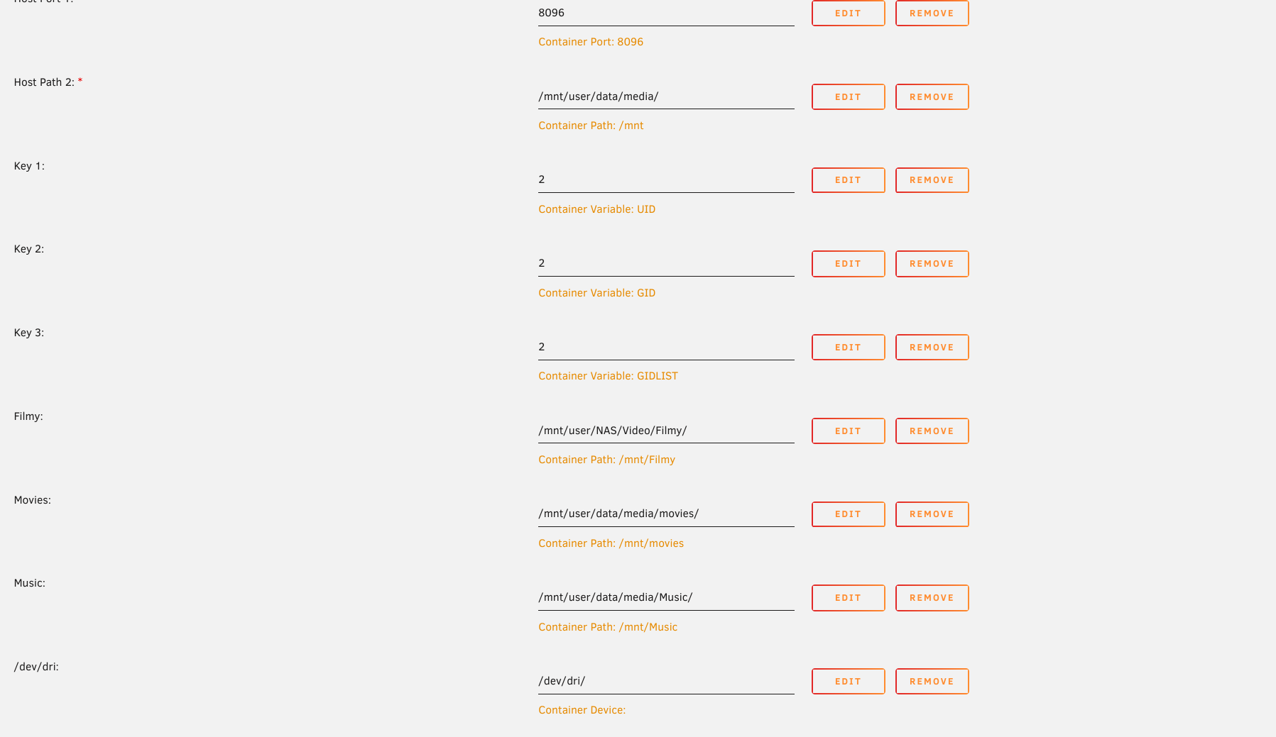

Maybe you should change the variable PID to 99, GID to 100, and GIDLIST to 0.
Thanks for answer. I change but it don't work.
