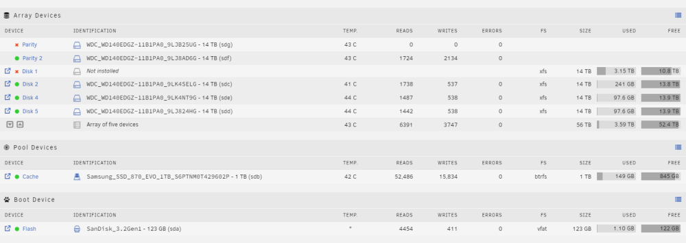

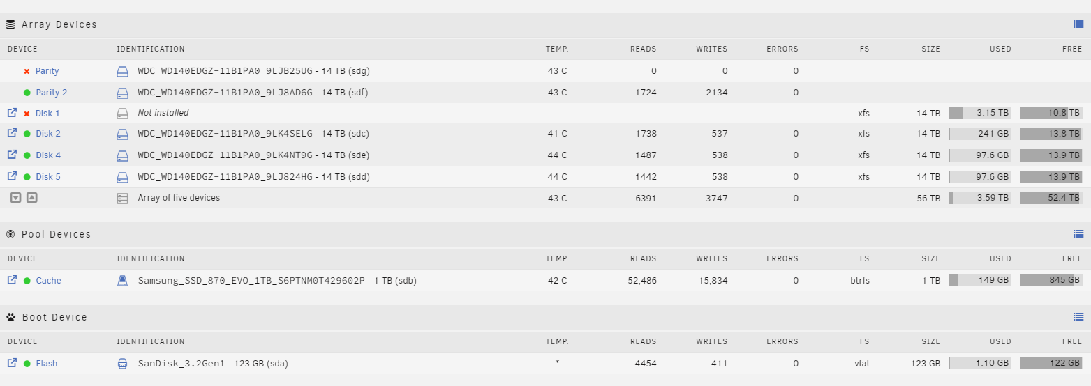

Thank you!  This got me all my data back.  However, it's still showing "Not Installed" and reporting the wrong size.  (see attached).
Because as you said earlier disk1 is NOT physically present.   Its contents are being emulated using the contents of the other data drives plus your parity2 drive.   Why do you think the size is wrong?
At this time you have no redundancy as parity1 is disabled.   To get back redundancy you need to either rebuild the contents of parity1 or replace disk1.   I strongly suggest you check back here saying what change you intend to make as any error now will lead to data loss.
