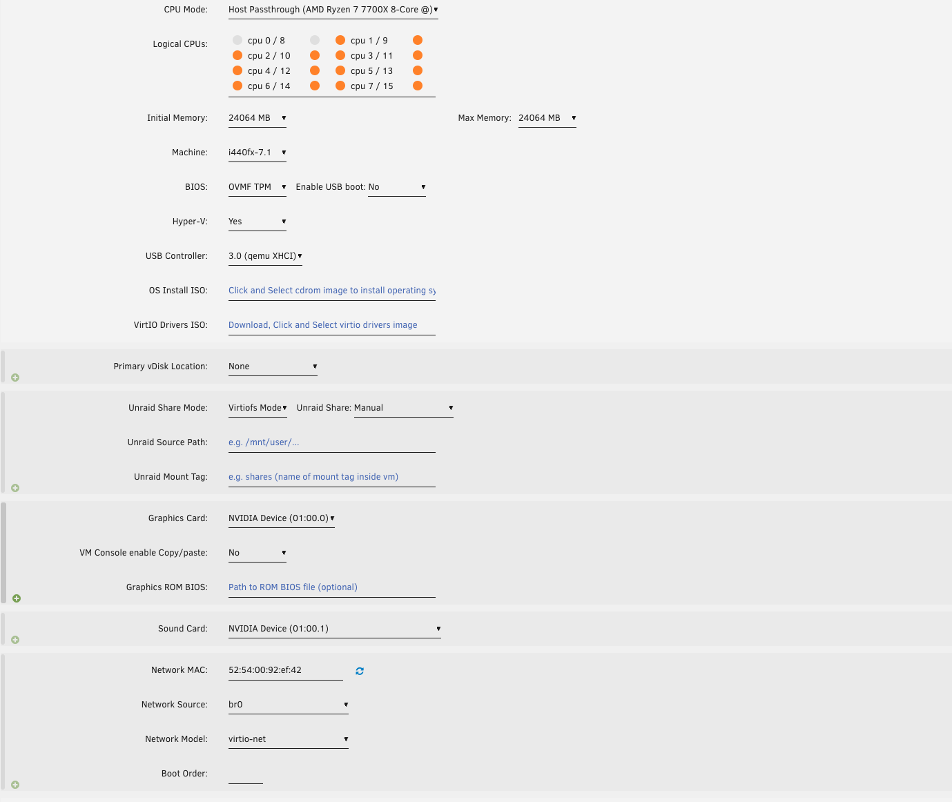

I set up a windows 11 gaming vm about two days ago; everything seemed to be working great in terms of performance and passthrough of gpu, nvme, usb controllers etc. I ended up switching windows sleep back on after originally turning it off to see if I could save my monitor from staying awake when the vm was not in use. The vm went to sleep and showed up as paused in the vm manager, trying to start it from that state resulted in an error so I force killed it and started it back up again which caused the entire unraid server to crash and reboot.
Since then anytime I try to start the windows 11 vm or create a new one and start that unraid completely crashes. I can run unraid fine otherwise and my ubuntu server vm (with the same gpu passed through) can start up just fine. I can also boot the machine directly into windows instead of unraid and everything seems to work perfectly there (except bluetooth for some reason). Would appreciate any suggestions on how to resolve this as having to reboot each time I want to use windows is a bit annoying:
VM setup in the pictures below the only editing I did to the xml was to follow step 1 of this page:
Edit: I have tried to create a new windows vm with a fresh install by using a vdisk and not passing the vfio bound nvme but trying to start that vm and install windows also causes unraid to crash.

Here is the vm xml; it seems that for some reason the few xml edits I made are no longer there:

making changes  via the gui will replace custom xml changes.
Do you have an external syslog server? maybe post diagnostics?

It would see likely not to be nvme. Have you tried the new vm just with virtual rather than nvidia gpu tl check it works ok.
Actually no I havent I figured it was fine as that was working properly with drivers installing automatically and gaming well etc. Also, I dont have the gpu bound to vfio at boot not sure if that has an impact but passes through fine to both ubuntu and windows at least until windows broke
Edit: I'll try out new vm with virtual instead
Edited by fadynakhla
Update: I was able to create and start a fresh windows vm with virtual graphics and then also a fresh vm with graphics card passed through (nothing else), so I tried to boot the existing vm and whole machine crashed again.
The share I created and set for syslogs is still empty though oddly
Edit: I set the graphics for the existing vm to virtual and removed all passed through devices (except the boot drive) and can start the vm with vnc
Edit 2: System wide crash happens again when I pass through the usb controllers and start...
So I think I have figured out what was going, unfortunately looks like the issue is with the usb hub built into my monitor that I am plugging it in to one of the passed through ports. When I unplug it I can pass the usb controller start the vm then plug the monitor's usb hub in after the vm starts to use it. Kinda annoying but i suppose it works
  • 4 months later...
FInal update on this, I'm not sure why but after some testing I isolated the issue to one of the usb controllers on my motherboard. I rearanged the usb devices that I dont want to pass through and tested out other usb controllers and am having no issues at all starting and stopping my VM with the controller passed through and any number of devices attached. To anyone experiencing this sort of issue I would recommend trying other usb controllers.
