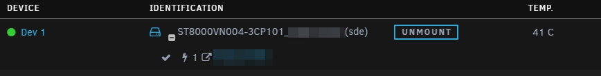

Just so I am crystal clear -- the command above to zero the drive below would be:
dd bs=1M if=/dev/zero of=/dev/sde status=progress
Correct? Thank you!
1 minute ago, Stupot said:
Correct?
Yes, assuming the target disk is still sde when you issue the command.
CHECK IMMEDIATELY BEFORE YOU ISSUE THE COMMAND
sd? designations can and will change, Unraid assigns the letters from scratch at each boot, so hardware changes can change which drive gets which letter. Do not assume just because the drive was sde last time the tower was started, it will be the same now. The consequences of getting it wrong are catastrophic. Double and triple check that you are sending the correct sd? command.
I can't stress this enough.
Thank you. I truly appreciate the time you took to explain that.
In the end though, I have ended up just using the UD Preclear plugin to zero the drive.  The command did work and it began zeroing, and I could see the status of what it was doing, but it seems it requires the terminal window to be open for the entire duration. I guess if I SSHd in from another computer using Putty or something alike it would be more stable than doing it through the browser terminal. I am sure there is a Bette lr way of doing this that I am just not experienced and smart enough to figure.
It does appear that the Preclear plugin works out to in like I think you said DD does. It starts fast and gets progressively slower as it works it's way inwards on the platter. My hope is that Unraid writes data this way when the disks are used in the array. If that is the case, when I start hitting reallocated sector count warnings should mean the data that was on there has been zeroed and I can stop the process.
