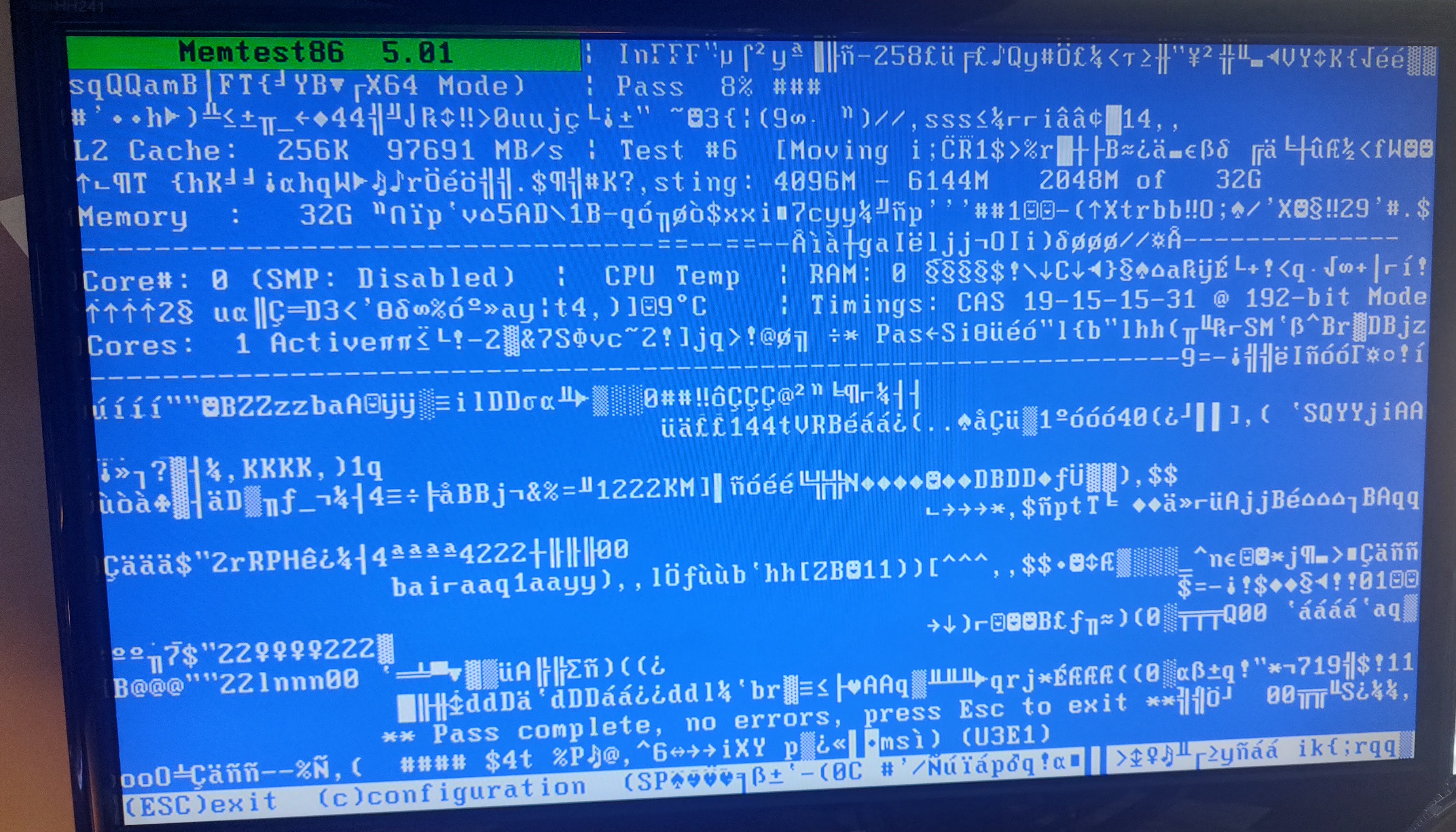

So it finally crashed again some point last night (between midnight and now) , probably the longest its been running continuously for a long while. I've grabbed the diagnostics and log file, let me know if anything else would help. I'm going to set it to run a mem test, didn't want to ruin a streak.
syslog (3) tower-diagnostics-20230828-1116.zip

I think the memtest i was running has just crashed, after running for about 3 hours. does this mean that the ram is most likely whats causing the crashes?
Not necessarily, but basically it confirms a hardware issue, if you have multiple sticks of RAM try with just one, if it still crashes try a different one, that would basically rule out a RAM problem.
