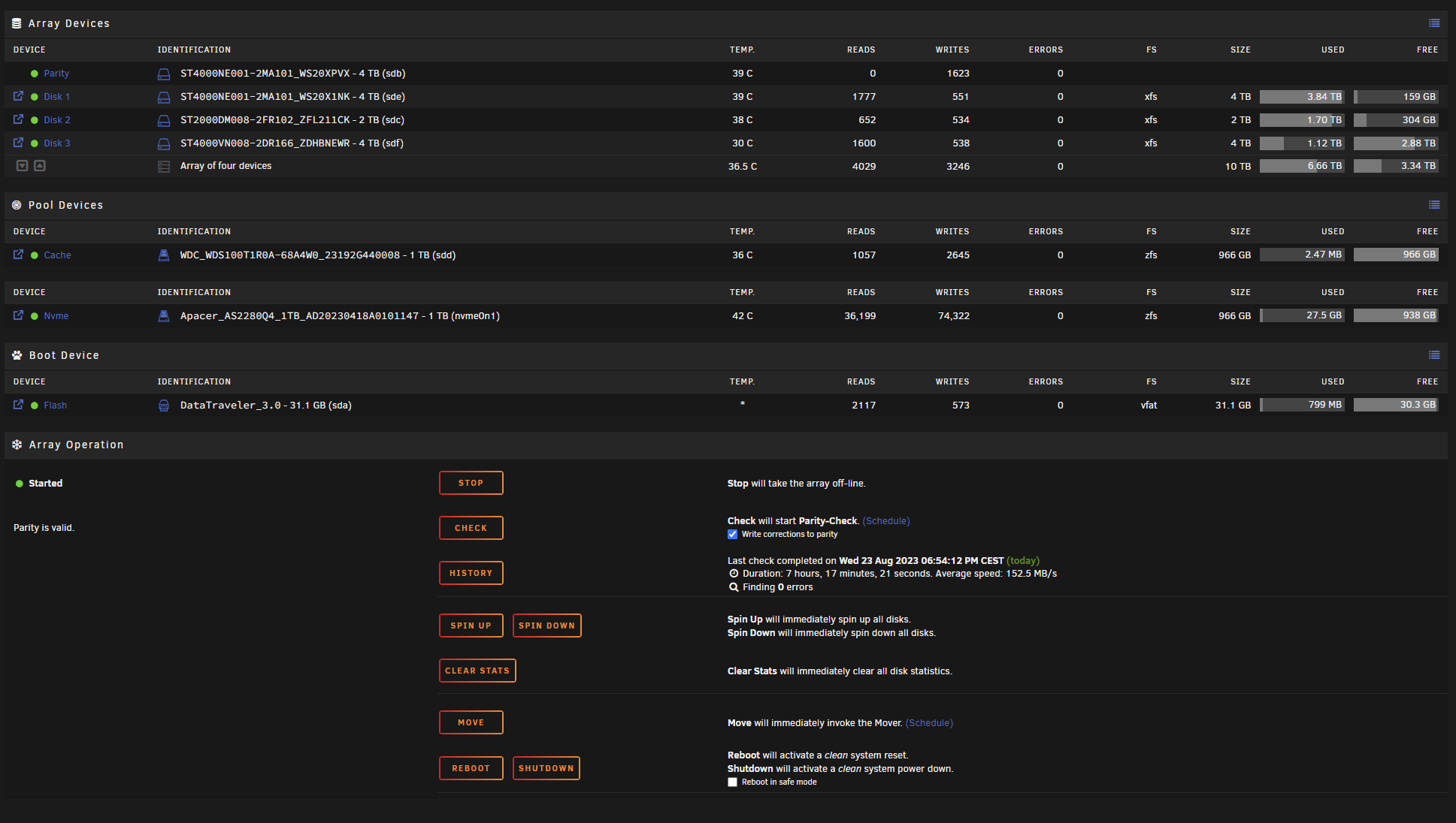

Hi all,
I have all sorts of problems since I replaced my cache SSD for 1 cache & 1 NVME and changed FS to ZFS.
Currently mover is not working at all. It just blinks and log is showing:
Aug 23 22:51:32 XXXXXX move: mover: started
Aug 23 22:51:32 XXXXXX move: mover: finished
Changed share settings multiple times, downloaded mover plugin, uninstalled mover plugin. Tried with VMs & Docker off and on and still nothing.
My settings:
558963177_2023-08-23230156.thumb.png.798b6e957bd03aaa49c5e54e1986f479.png1668819378_2023-08-23230646.thumb.png.2b4bff9be930f48dfa2157b4e676fa40.png
I don't think I can go back to previous Unraid version as I've set NVME & Cache to ZFS and my previous version was 6.11.5.

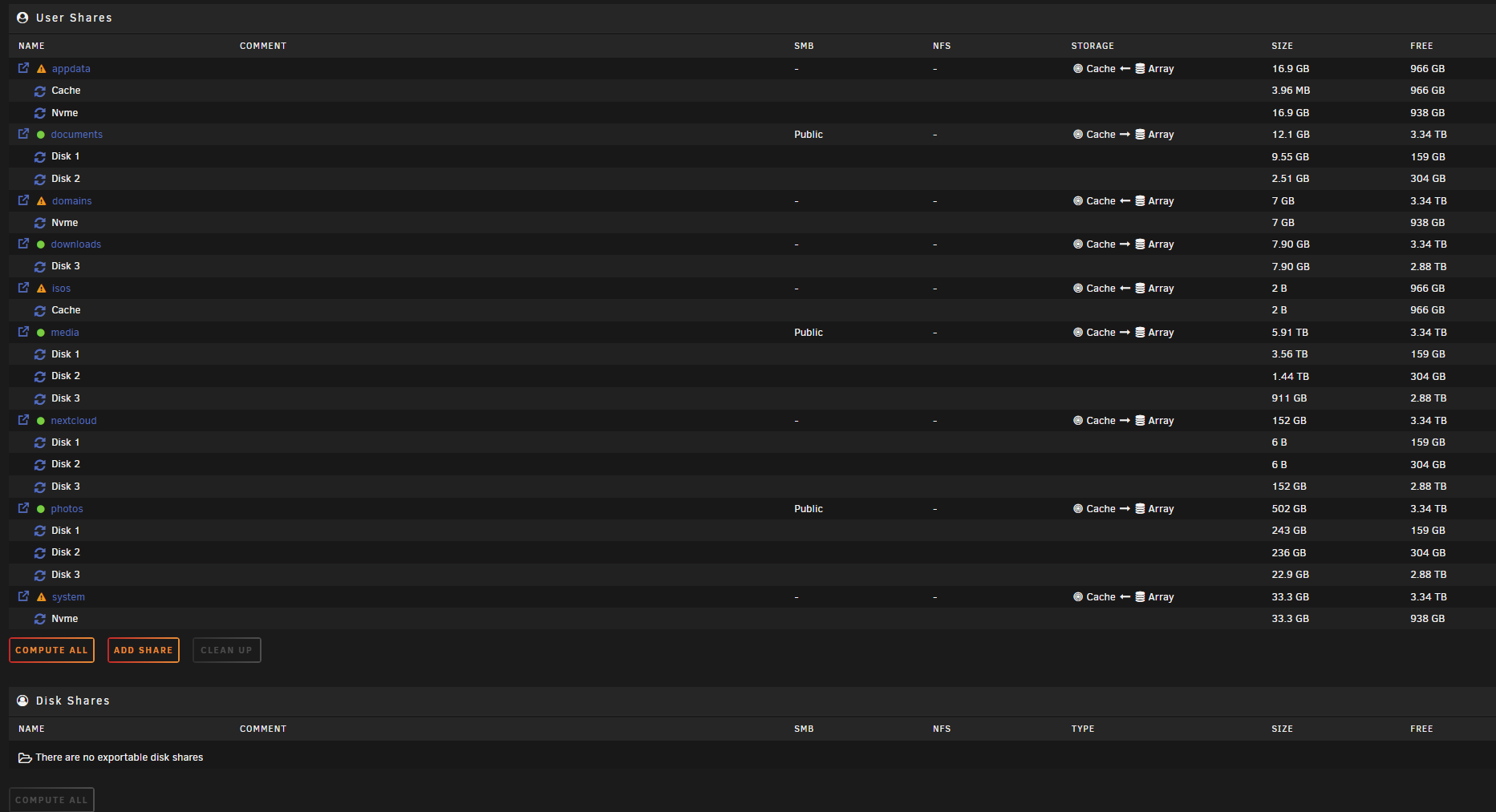

Apparently there's nothing to be moved, which shares do you expect to be moving?
Looking at where the files for shares are located the only anomaly I see is where a share has parts on two different pools:
appdata                           shareUseCache="prefer"  # Share exists on cache, nvme
However mover does not move files between pools - this needs to be done manually.
It's weird, cause I can't initialize mover in any case (e.g. I've tried appdata: cache; NVME; array - mover just blinks and that's it). As per the screenshot in my first post, files are not in locations set and mover is still not doing anything. Multiple shares are physically in NVME even though I don't have NVME set for any share.

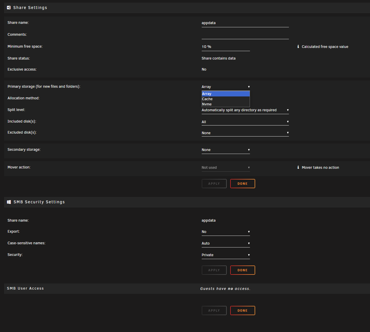

How should I set it to test the mover (I've tried all possible combinations for appdata and mover only blinked so I'm paranoid and doubting myself)?
For mover to do anything then you need to have a pool set as primary storage, the array set as secondary storage and the mover direction set appropriately.
