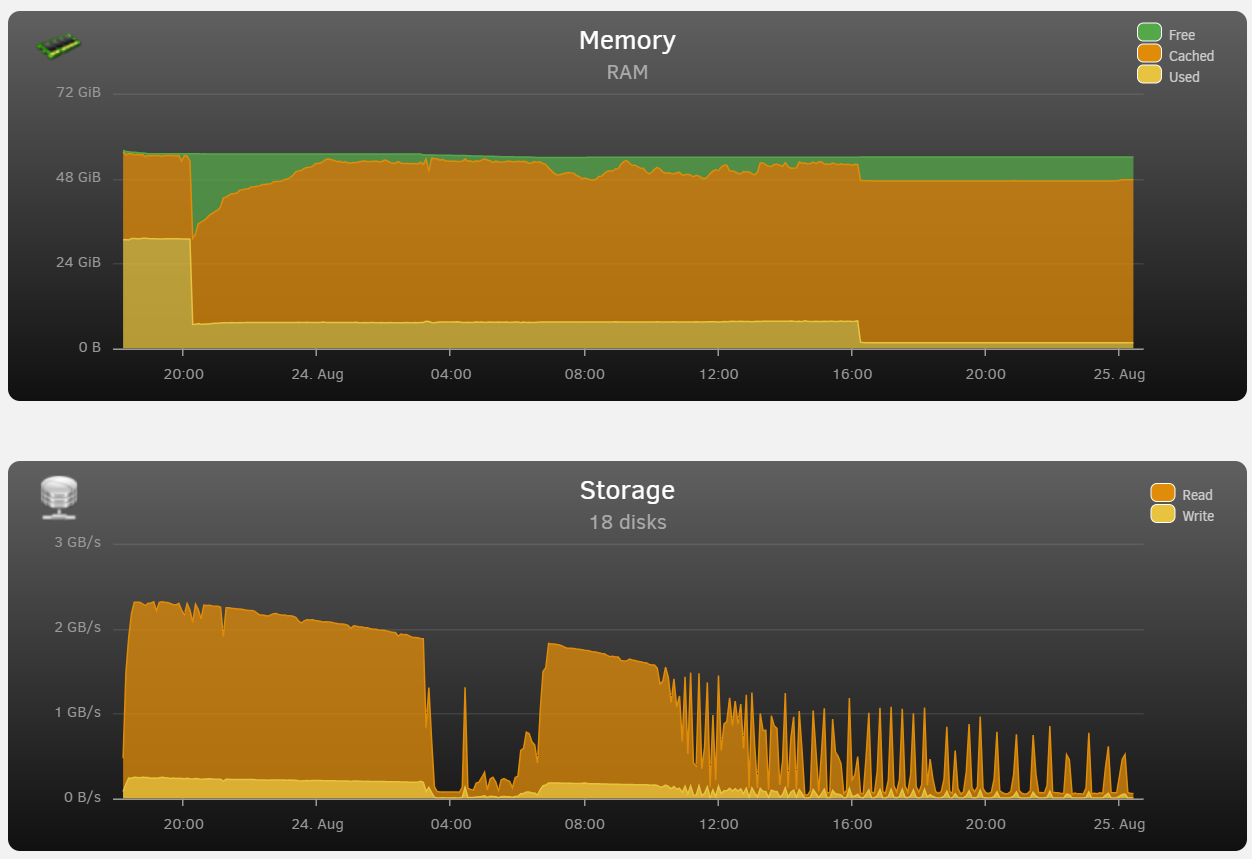

I added the drive to the array to rebuild the failed drive.   I noticed initially that the rebuild appeared to be writing at around 250mb/s which was the speed that it appeared to run at while doing the pre-clear. (see graph below)
However after a period of time into the rebuild it has slowed right down to like 5-7mb/s.  This appeared to fluctuate with times where it spikes up to 125mg/second for a brief period of time. Then again drops down to 5-7mb/sec
I am trying to figure out why this is occurring and what I can do to help with process.   I have attached a photo of the stats page which shows the performance of the drives over time since the start of the re-build.  As I was looking things up online found a number of posts that suggest to ensure VMs and dockers etc are all closed. I had the VMs all off from very early on, and then turned off the dockers 1/2 way through without any significant change or improvement in the speed.

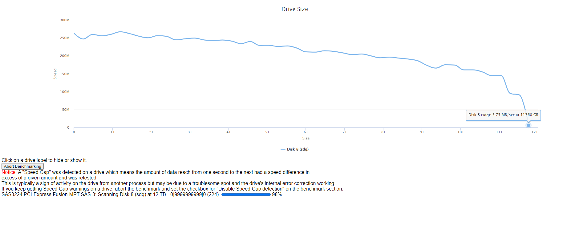

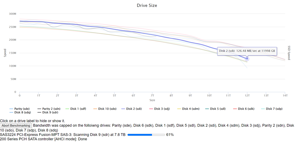

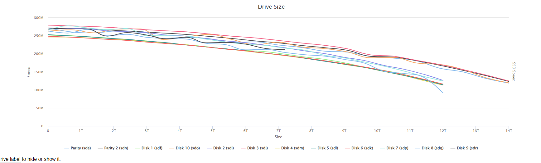

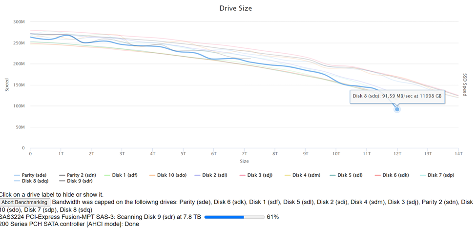

So if I have understood and interpreted the graphs correctly I think the drive that is causing my issues is the disk 8 in the graphs below.   it tanks at the last 1 tb each time in terms of read speed as compared to the other drives.    I re tested with the original scanning settings on its own and the same behaviour occurs.
When I test it with more frequent testing zones 2% as opposed to the default 10% it plummeted even further in the last TB.  to speeds that were in keeping to what I was seeing during the data rebuild and build of the 2nd parity drive. It also appeared to stall at the 98% with it sitting there for 20 min (even with the speed check option unchecked)
I note that I tested some of the other drives ex (drive 10) which was showing a bit of early variation in the grouped test in the first graph and it smoothed out on retesting, and disk 9 which paused for some time at 61% finished without issues.
Going to run a few more tests on the disk 9 and 10 (at the 2% increments... But thought I would ask
mind letting me know your thoughts is it likely the disk 8 in your opinion causing my issues ?  before I start a warranty process wanted to ensure I am  reading the graphs correctly lol

Could be disk8, but since the test only scans a few sectors it's not always easy to be sure, there are utils that do a full surface scan while reporting the speed, that would be better to confirm but you'd need to take the disk out.
