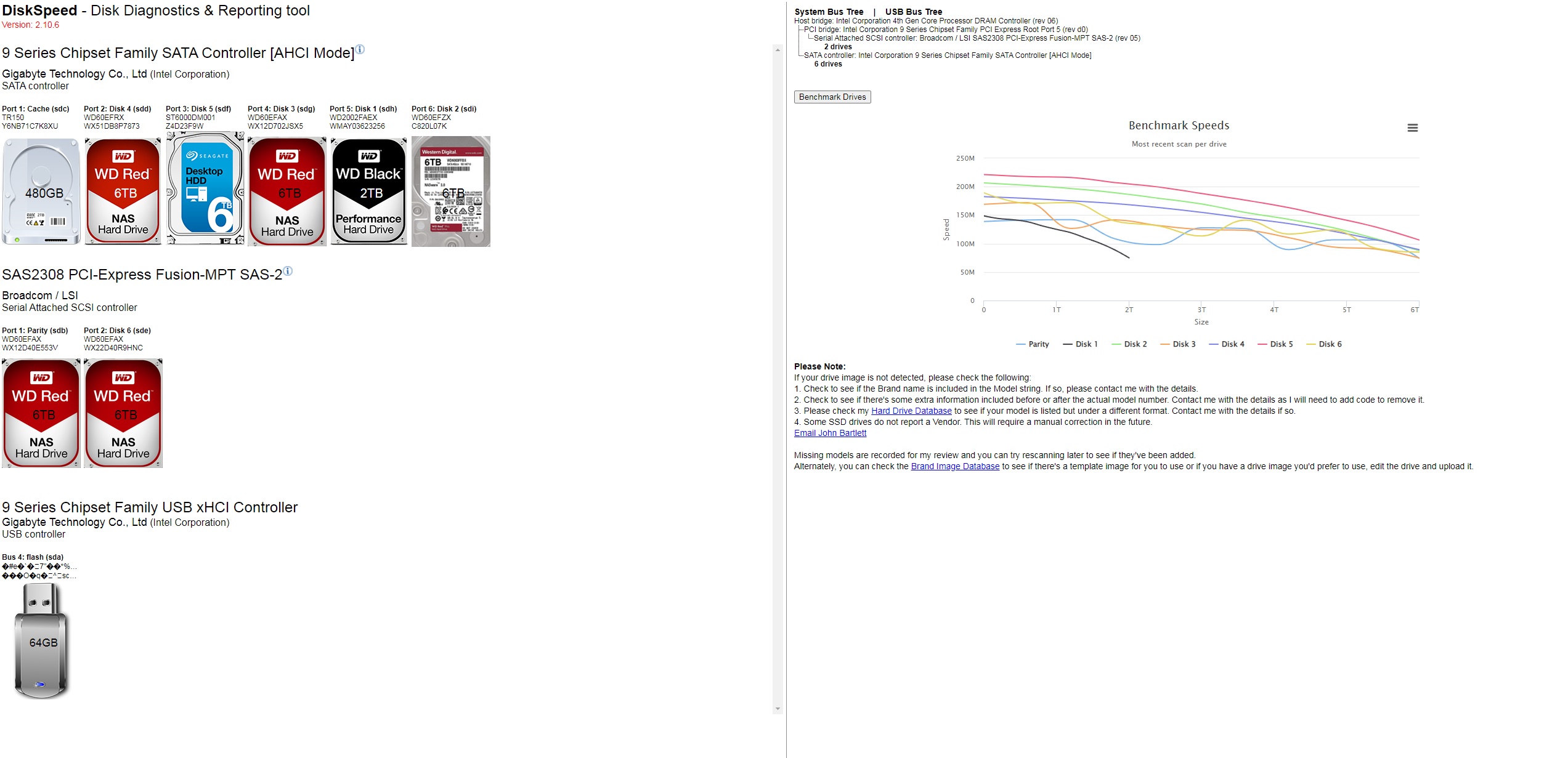

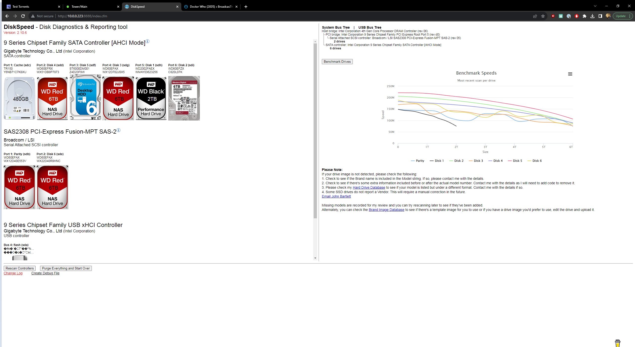

I have attached diags and screenshots of DiskSpeed results, but not sure how to interpret the results. One DiskSpeed result (_FULL) contains speed gap errors, in the other I disabled them.
Could this be an issue with failing drives, or could my drives be slowing because they're starting to fill up? I also didn't notice this issue until I updated to 6.12.3, not sure if it could be related to that.

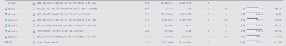

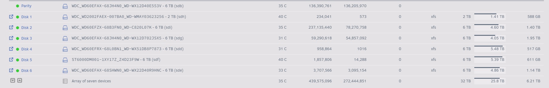

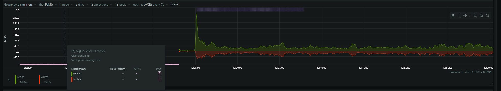

Is this normal, copying a file from cache to array. Very fast in the beginning and drops throughout the rest of the transfer, seems like the same behavior as the torrents.
First few GBs go to RAM, so it's faster, then it needs to wait for the disks, also most of your disks are SMR, including parity, that will limit all array writes, even to CMR disks.
