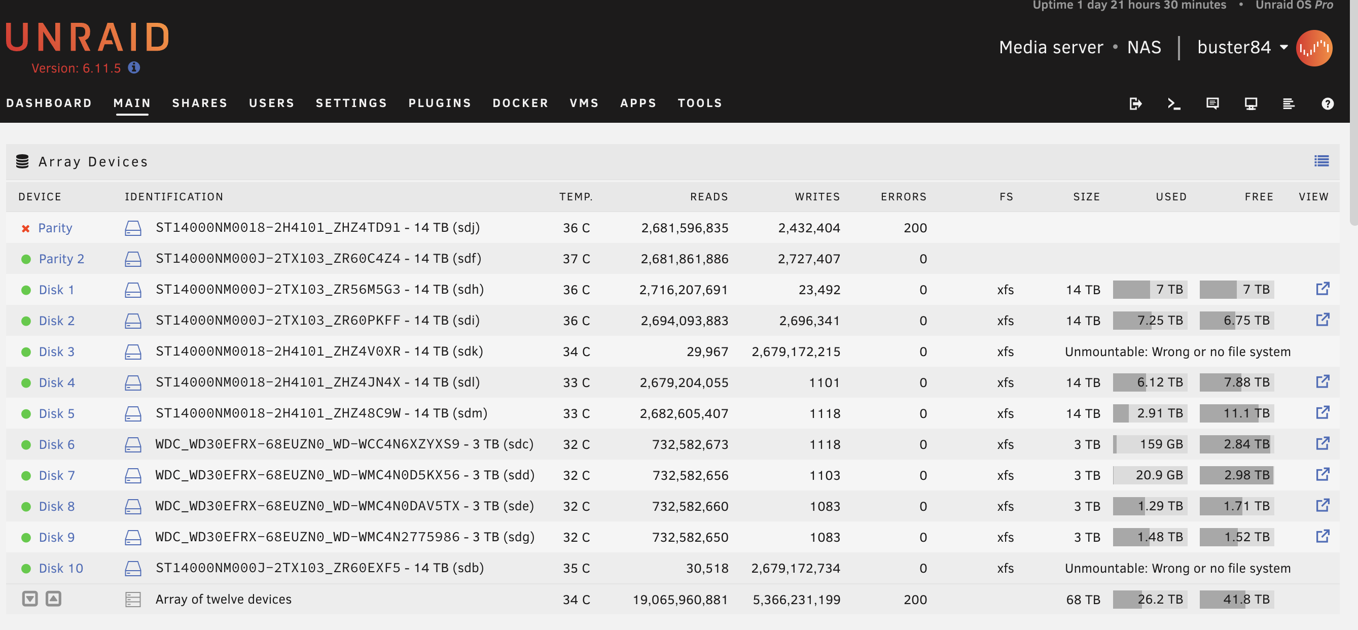

My unraid server worked great until i added two more disks. I added two 14tb drives to get a second parity and add osme space. Since then Disk 10 and disk 3 wont mount and keep saying un mountable. Parity one has done the same. I rebuilt the parity, then rebuilt disk 3 and 10 and then it said complete, only for the parity to go back to being disabled and disk 3 and 10 are back to unmountable.
I really don't know how to fix this, ive tried all the basics. Can anyone help.  Ive attached the diagnostic for the server.

Replace the SATA cable for disk10, then check filesystem on both unmountbale disks (run it without -n) and post new diags after array start.

I replaced the cable and then performed this using the xfs_repair button on drive 3, but it just stops after saying this
Phase 1 - find and verify superblock... Phase 2 - using internal log - zero log... Log inconsistent or not a log (last==0, first!=1) empty log check failed zero_log: cannot find log head/tail (xlog_find_tail=22) ERROR: The log head and/or tail cannot be discovered. Attempt to mount the filesystem to replay the log or use the -L option to destroy the log and attempt a repair."
