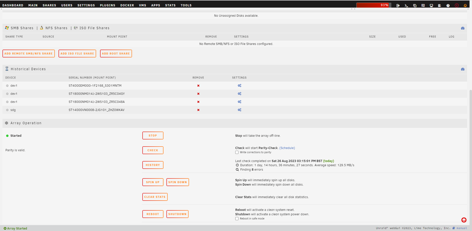

I had an outtage and unclean shutdown as a result. I did the parity check without writing corrections on the array and it came with 8 sync errors. How can I check the files that was affected so I can restore from backup?
I also have the drive formatted in BTRFS so will I have to do a error check too?
The errors are usually with parity, you just need to run a correcting sync, but if the drives are btrfs formatted on can run a scrub on each one to confirm, but I would bet the data is fine, except if there was any that being written at the time the power went off, those files can be incomplete.
