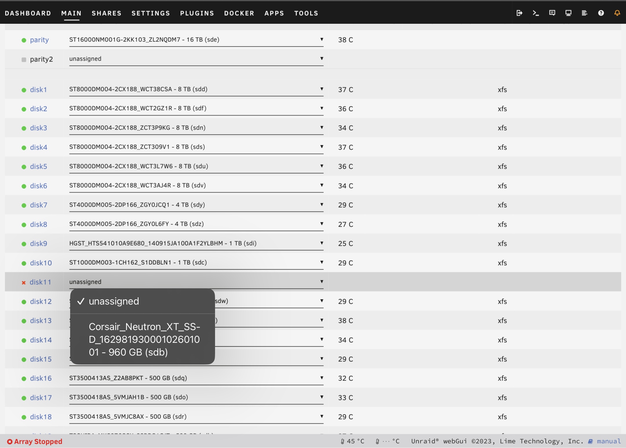

A few weeks ago I had a drive failure, did the standard procedure and replaced the failed drive. No issues from what I could see. This week I had another failure. Stopped the array and replaced the drive. When I turn the server on the array automatically starts and the array says I am missing disk 11 (The failed drive) I cannot stop the array as it will just error out indefinitely.

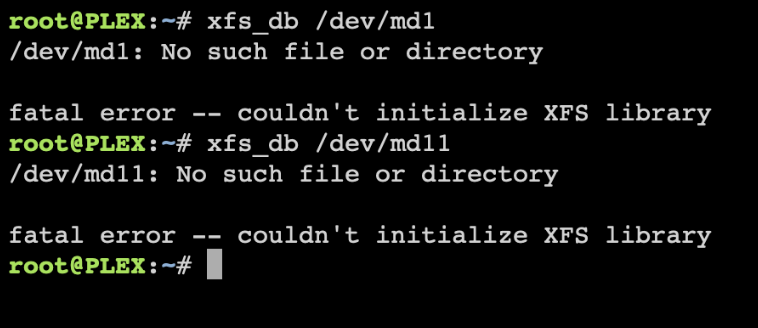

When I enter the command xfs_db /dev/md1
I get the response
/dev/md1: No such file or directory
fatal error -- couldn't initialize XFS library

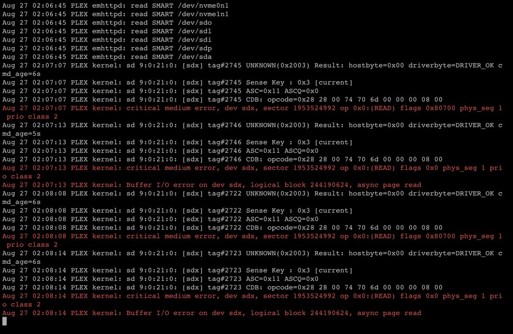

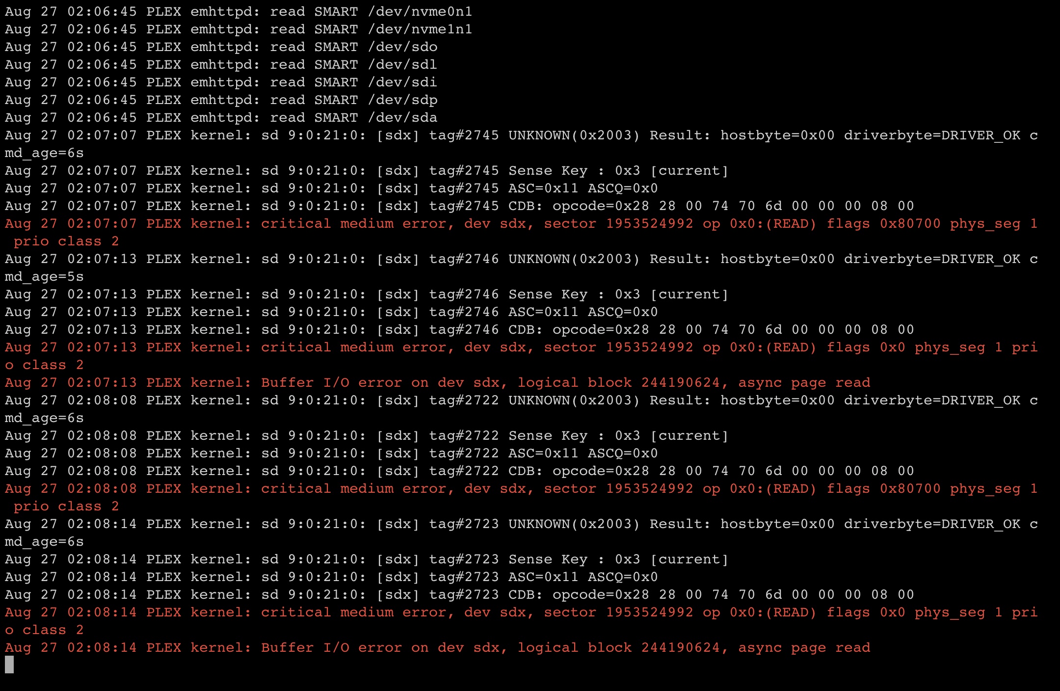

If this unassigned disk was disk11 it needs to be replaced, it's failing badly:
Model Family:     Seagate Barracuda 7200.14 (AF)
Device Model:     ST1000DM003-1ER162
Serial Number:    Z4YB2L45

The drive you mentioned above ending in 45 is the drive that has just been put in the server. That should be in full working order. When I stop the array and try to select the drive the option suddenly disappears (As seen in the screenshot). This is the second drive I have tried as well so it is unlikely that both ‘new’ drives would be failing. (That said they are technically used so it is possible)

Taat disk is not good, you need a new one, then rebuild disk11.
I would disagree.   The SMART information for the drive shows:
5 Reallocated_Sector_Ct   PO--CK   061   061   010    -    7864
and
197 Current_Pending_Sector  -O--C-   001   001   000    -    63632
198 Offline_Uncorrectable   ----C-   001   001   000    -    63632
On a ‘healthy’ disk these should ideally be 0’s.

The part I still don't understand is the responses I get when I type the below command.
I know Defragging doesn't matter that much (if at all) but It's still something that makes me think there are some issues.
Is this something irrelevant or should I be worried about it ?

You are on a 6.12.x release so the correct device name would be /dev/md1p1
Ah, that works. I had no idea the device name changed.
It looks like that is me up and running again, Thank you.
I believe that is part of getting ready for later releases when Unraid will not be restricted to using partition 1 on a drive.
