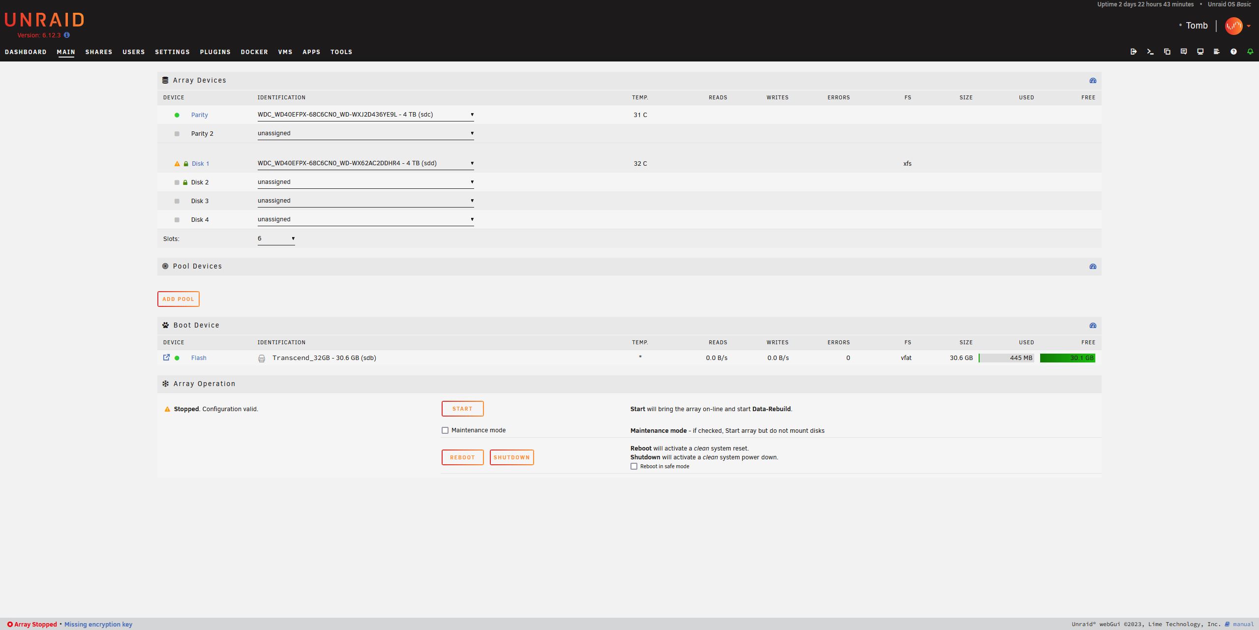

Bottom line says encryption key is missing, but its not prompting me for anything.

This it how it looks like (yellow triangle says "contents emulated").
Start or Start with maintenance mode checked just reloads the page.
